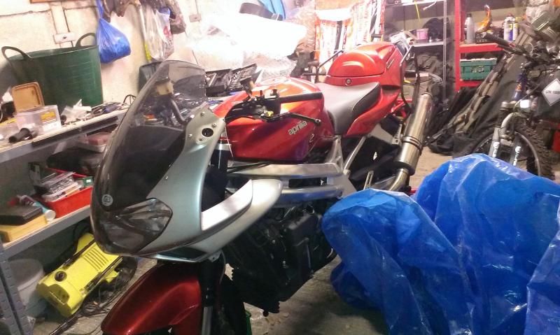

I finally started pulling the front end of the bike last night, only to find that the yoke and risers I have (tuono) take fat bars 1 1/8" in the middle that taper down to 7/8" at the controls. I have renthal normal bars so couldn't fit them.
I'm going to order some new risers 2" instead of 3" as these will be cheaper than a new set of fat bars, plus they'll give me the opportunity to swap the amount of rise if I want to at a later date.
Here's the bike with the chopped fairing fitted (I didn't chop this one so don't blame me), it is cut a bit more that I'd have liked but I would much rather this than cutting up my own perfectly good fairing. These are still the original bars by the way

#25 Post by wayno » Sat Dec 13, 2014 2:51 pm
Getting there
