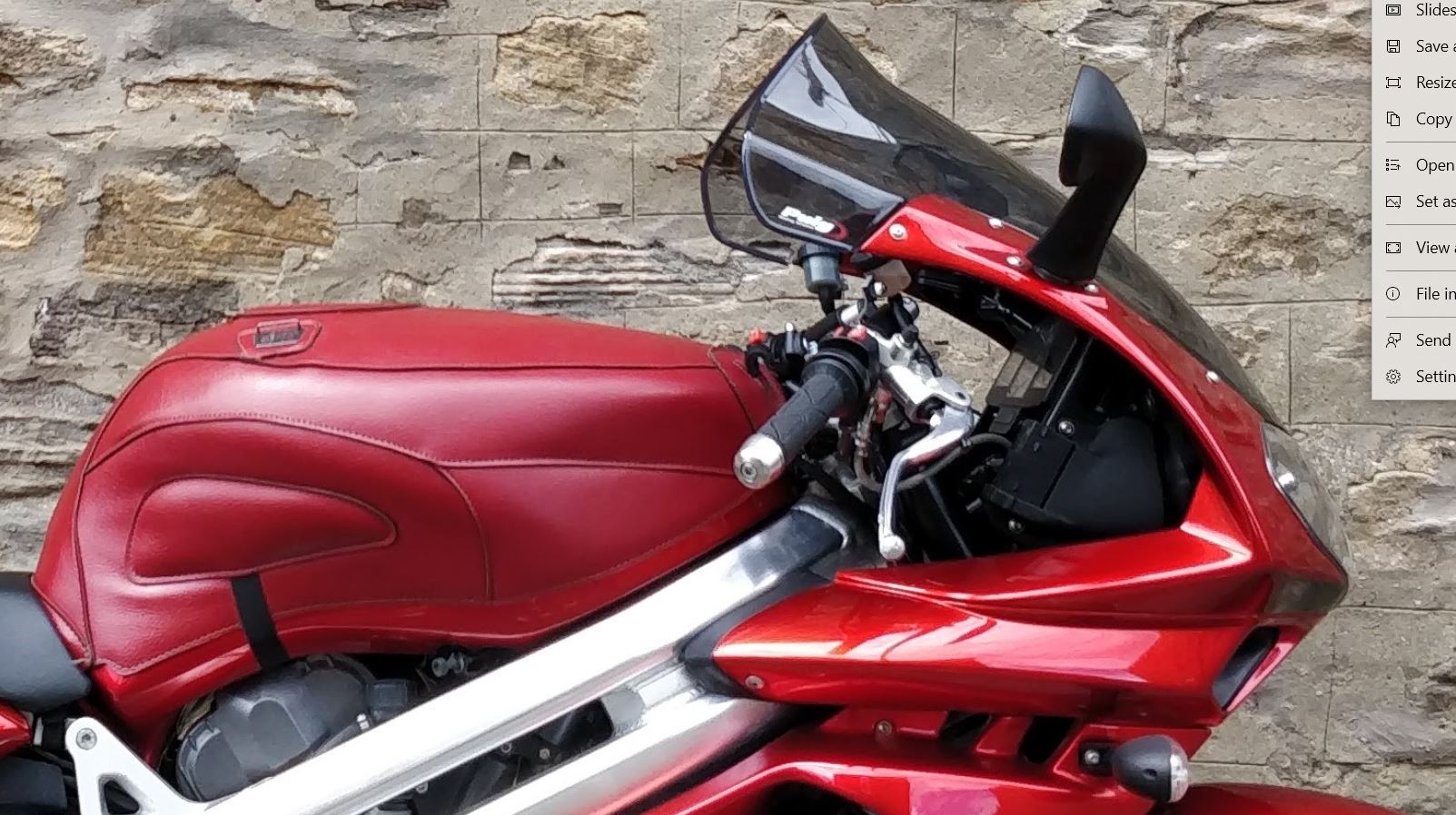

Of course my brake master is a bit different to yours. This is mine:

#21 Post by mangocrazy » Sat Jun 15, 2013 7:48 pm
Yes, it was getting the controls at the correct angle to get the ergonomics right that was the big problem for me. I like the levers pointed down at an angle of about 20-30 degrees from horizontal to avoid getting cramp in the wrists and forearms.
The only way really is to post up pictures, as my solution involved 53mm clip-on clamps (as advertised on eBay), with specially fabricated bars. It took me about 18 months to get it sorted but, like you, I wouldn't go back to the OE setup.
As part of what I was doing, I also wanted to reduce the overall bar end to bar end width and raise the bars a small amount. I'm now very, very happy with it, but it took a fair old while to get there.

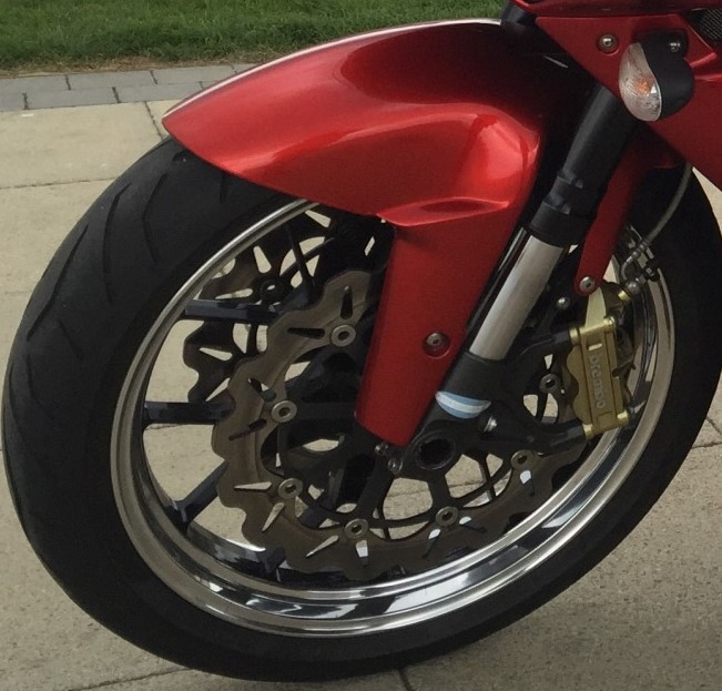

Falco Frank

This is a helpful thread that I'll add to with some extras, firstly: Fork Data:
2001 Showa std Falco / 2002 - RSV Ohlins / 2005 RSV Showa Radial
Top yoke - 53mm / 51mm / 51mm
Bottom - 53 mm / 56mm / 53mm
____________________
I had my 2002 RSV-R forks rebuilt by a good guy in Leeds for my weight, I'm sure he said internals were slightly different from std forks.

Piccies:
I only did the radial brake on mine - I kinda like it.
P1080626 (Medium).JPG (158.38 KiB) Viewed 3545 times

#27 Post by mangocrazy » Fri Jul 30, 2021 6:31 pm
Managed to acquire a set of Gen 2 Showa forks and matching radial calipers for £450. This will be an 'over winter' project and will tie in with the bar raising project. The only thing I notice is that the calipers are noticeably heavier than the non-radial types. This will slow the steering down a tad.
