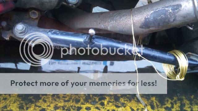

it broke when i was out and about , heard it scrape when i took a left hand corner, i fitted the gsx stand about 3 years ago, but im sure i kept the original bracket ( thats the bit that broke )and just fitted the leg , (d-rider can you confirm for me i cant remember )
lucky it didint happen when it was parked up ,
and the quick fix , i broke down outsid HG glasgow and bought some picture wire from a shop next door
my question is does anyone have a spare bracket ?
BTW that is a big dink on the zorst

Id guess that dink if from the s/stand being kicked up,travelling too far. My neighbour has an Anniversery GSXR 750 and worries more about s/stand issues than I, a falco owner
I can honestly say a 57 GSXR side stand is worse than a std Falco, not sure how much variation there is between GSXR years but 57 Spec Anniversery is not a good choice

do you think the angle the bike leans on and the weight is to much for the standard bracket using the gxr stand ?
#8 Post by furygan man » Thu Feb 16, 2012 10:44 pm
joecrx wrote:do you think the angle the bike leans on and the weight is to much for the standard bracket using the gxr stand ?
Good point!! I've got the 01 Falco and since putting the Firestom stand on it leans over a hell of a lot more...may bite the bullet and do the American stand and bracket?

Just in case you are wondering why this happened then i think it was because the bolts had come loose. If they were tight then the bracket would not have fallen. The front bolt would have held it in place (and so would the back one for that matter). IMHO the vibration over time will have weakened the bracket (forgot what the term is that describes this) and this has caused it to snap. I don't think the bracket is at fault in this case. It is more likely an unfortunate case of the bolts vibrating loose over time. I would replace the bolts as well when you do the repair and also use some loctite.
#11 Post by joecrx » Fri Feb 17, 2012 12:22 pm
paddyz1 wrote:Just in case you are wondering why this happened then i think it was because the bolts had come loose. If they were tight then the bracket would not have fallen. The front bolt would have held it in place (and so would the back one for that matter). IMHO the vibration over time will have weakened the bracket (forgot what the term is that describes this) and this has caused it to snap. I don't think the bracket is at fault in this case. It is more likely an unfortunate case of the bolts vibrating loose over time. I would replace the bolts as well when you do the repair and also use some loctite.
i think you right there , i kinda noticed the bike leaning over a bit more than usual but thought it was just my imagination ,
