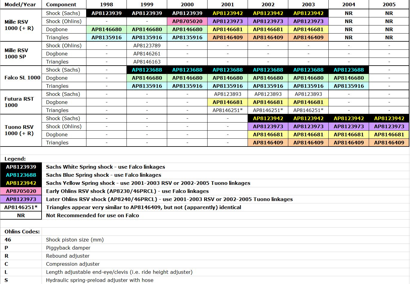

It is also only fair to acknowledge one’s sources. The first spreadsheet matrix shown below is a reworking of that originally compiled by Masta-C on the AF1 Forum. Without his original as inspiration, my alternative version is unlikely to have seen the light of day. Likewise, the great majority of the material included here has been supplied by other posters, here and elsewhere. You know who you are and we thank you for that.

Interchangeability – RSV Mille 1998-2000 (1st Generation)
The RSV Mille was launched in the 1998 model year, and a year later the Falco followed in its slipstream. While they targetted different audiences, there was a great deal of commonality of parts between the two. As the sheet below shows, in their early years the Falco and the Mille used the exact same dogbone and triangles; only the shock was different. The only exception to this rule is the RSV Mille SP; there is absolutely no commonality of rear suspension parts with that and any other mainstream model.
As a result, the standard ‘White spring’ Sachs Mille component is a drop-in replacement for the OE Falco unit. While the manufacturer was the same, the Mille Sachs is a far superior item. It boasts full adjustability; preload, rebound damping, compression damping and ride height are all adjustable. The unit is also fully rebuildable. The only minor snag is that on some units the Schrader valve may need relieving with a Dremel or similar to stop it fouling the subframe. This varies from unit to unit; some will fit, others won’t. The best course of action is to specify the fitment of a recessed valve when the unit is serviced.
For the 2000 model year, the Mille ‘R’ was introduced, and this had a number of uprated components, not least of which being the Öhlins shock. This is also a drop-in replacement for the OE Falco unit, but as this model was only produced for one year, these shocks are of necessity scarce. This shock boasted the same levels of adjustability as the ‘White spring’ Sachs (preload, rebound damping, compression damping and ride height) with added Öhlins build and component quality and bling factor. Ahem. Öhlins code for this shock is 46PRCL (see below for explanation).
For a while Aprilia offered a bespoke Öhlins shock for the Falco as an upgrade part that was matched to the OE Falco linkages (triangles and dogbone) and had a vertically mounted compression bottle (RSV/Mille bottles were oriented horizontally). This shock has a part number of AP941 in the list below. This worked perfectly with the OE Falco subframe and swingarm, but simply will not work when a Falco has an RSV/Mille swingarm fitted. Clearance issues rule this combination out, so if you wish to fit a Falco-specific Öhlins shock you must use an OE Falco swingarm.

Interchangeability – RSV Mille 2001-2003 (2nd Generation) & Tuono 2002-2005
For 2001 Aprilia revamped the Mille quite substantially. Among the many changes made, the linkage ratio of the rear suspension was reduced by employing a dogbone and triangles with markedly different dimensions to the previous model. This required a shock with greater travel, a softer spring and different valving. Crucially, the frame and swingarm mounting points for the dogbone and triangles did NOT change, and so the later shock(s) can be used on the Falco providing it is partnered with the matching dogbone and triangles. This is vitally important. Note that the Falco suspension has stayed constant throughout its model life.
If an early Mille or Falco shock is used with later dogbone and triangles, it will give a punishingly firm, almost rigid, ride quality. If a later Mille or Tuono shock is used with early Mille or Falco dogbone and triangles, it will produce an excessively soft and over-compliant ride quality. It bears repeating that the shock and the dogbone/triangles must be from matching model years. The only exception to this rule is if the shock has been re-valved and re-sprung to match the dogbone/triangles in use. However it is normally simpler and cheaper to source the correct dogbone/triangles to match the shock in question.
As with the 2000 model year RSV Mille, the 2001-2003 model came in two shock variants. The standard RSV was fitted with a fully adjustable Sachs shock, but this time equipped with a Yellow spring. The Mille ‘R’ was fitted with an equivalent Öhlins shock, also fully adjustable. A year later the Tuono was announced, and that followed exactly the same pattern shock-wise. Suspension components from the 2001-2003 Mille and the 2002-2005 Tuono are completely interchangeable and identical.

Shocks fitted as OE to RSV Milles and Tuonos were either made by Sachs or Öhlins. This is not to say that other shocks cannot be used; we have heard of Nitron, Penske, WP, Maxton, Hyperpro, Wilbers and Hagon shocks all being used successfully on the Falco. But information on these aftermarket shocks is of necessity difficult to come by and this guide will (initially, at least) confine itself to information regarding Sachs and Öhlins shocks. If you have information on other fitments, please let us know and we will add that information to this guide.
In addition to providing OE shocks to Aprilia, Öhlins also supplied a range of aftermarket shocks via their distributors (Harris Performance Products in the UK). These shocks tended to differ from the OE shocks in that they specified a remote hydraulic preload adjuster. A list of OE and aftermarket Sachs and Öhlins shocks appears below. Note that certain information (such as supplied spring rate) has been taken verbatim from the AF1 Forum site. We would welcome any information which would corroborate or disprove these figures, as it is the author’s opinion that some of this information is down to guesswork or assumption.
