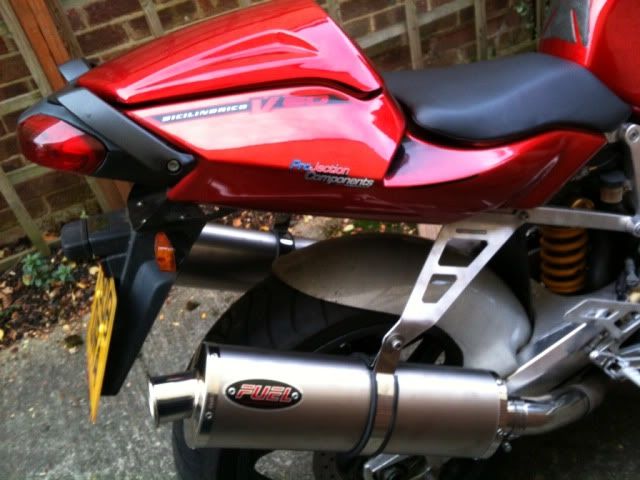

ProJection components exhaust hangers holding up the Fuel midi Titanium Ovals, sound great but amazing with the baffles out: Image
