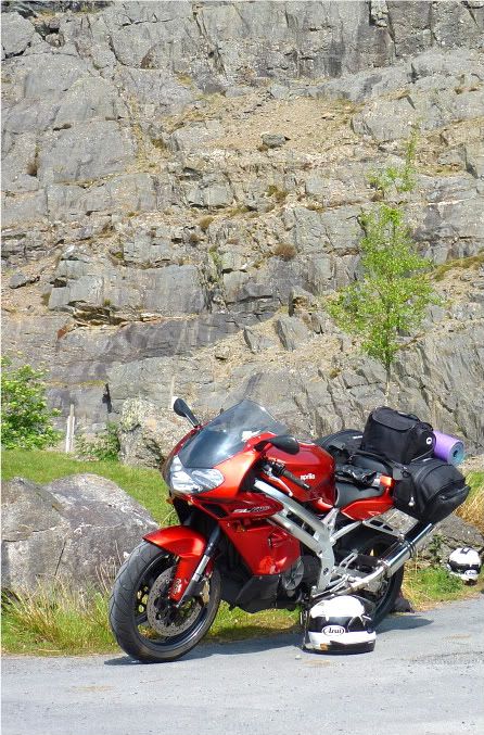

Haven't been round a lot recently... I've been lurking in the background (what with finishing moving house and leaving my current job!) and have just returned from a three day Wales tour on the Falco and loved every minute. I have a quickie re: clutch fluid level though.
