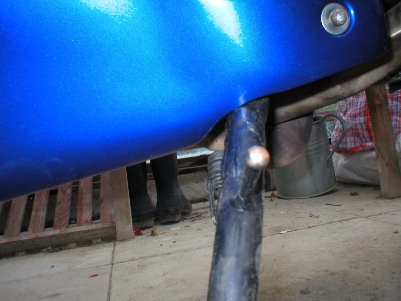

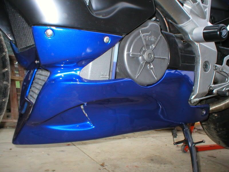

I have removed the sidestand switch. It was the easiest option and leaves less to go wrong. I soldered the 2 outside wires (as per a preious post) so it is a closed circuit now and the light/sensor is aways off. Totally happy with that bit.
Don't know the make of my belly pan, but he's a few photos:
[would I have the same problem with the firestorm stand?]
#8 Post by Nooj » Sun Feb 18, 2007 11:33 pm
I can see where it'll need cutting back, not a problem. Good pics!

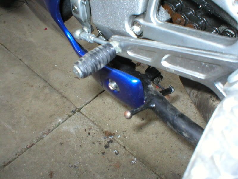

#9 Post by D-Rider » Mon Feb 19, 2007 12:03 am
Here's one I cut earlier!
Sorry for the poor photos - just popped out to take them in the dark. Bike could do with a clean too!
Anyway, I hope these will help to reveal what needs to be hacked away ...

D Rider, thanks very much for that. Looks like my Dremel Clone will be having an outing.

#15 Post by D-Rider » Tue Feb 20, 2007 1:36 am
OK ....
1) I've found the brackets, fitting instructions and rubber spacers (these go between the brackets and bellypan). I have the mounting bolts BUT the Allen Key sockets are a bit chewed (I used the good ones to replace some that were less than perfect - sorry)
PM me if you want the brackets gazuk.
2) Nooj, no drilling and tapping required. Bracket on LHS attaches under the bolt that holds the sidestand bracket. The bracket on the RHS fits under a crank-case bolt. I'll scan the instruction sheet tomorrow and post it up (it's after 1:15 am and I'd better get some sleep soon as I've got work in the morning).
3) I did take a quick picture of the LHS bracket - not the best pic but you can see the bracket between the bellypan and the sidestand bracket (picture is from underneath the bike looking forward and up). As you cn see, I retained the sidestand switch. Also, to use the Falco's sidestand spring, I had the fixing lug moved down the sidestand to opposite the lug provided for you to kick the stand down (although that lug could also do with being moved a bit).
