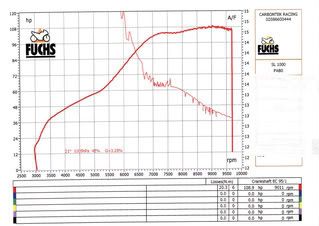

So after completing the 2-into-1 exhaust mod with a Mivv can and fitting an open air box i expected there to be 115bhp or maybe even 120bhp. Well she came in at a whopping 109bhp :smt011
Its not a very smooth graph either. The advise was that the baffled can is choking the bike and almost voiding the effect of the open airbox and that I could get a smoother line and more bhp if I removed the baffle. I can't really afford to do this though for fear of my neighbours. The bike is already very loud.

Syltiz wrote:So after completing the 2-into-1 exhaust mod with a Mivv can and fitting an open air box i expected there to be 115bhp or maybe even 120bhp. Well she came in at a whopping 109bhp :smt011
That sounds about right....109 at the wheel. Add another 10% and you get the same as the rest of us. The dyno machine you are on is measuring at the wheel and giving you true figures whereas the dynojet program adds the losses to the final figure. This is only hearsay i must add. It was in a thread on the AF1 forum. I will look for it and post it up for you
