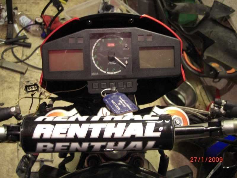

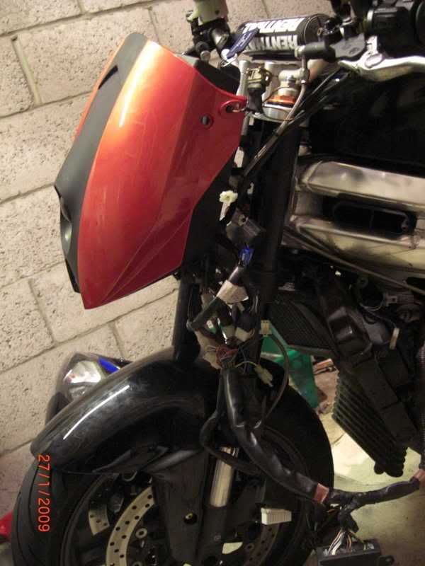

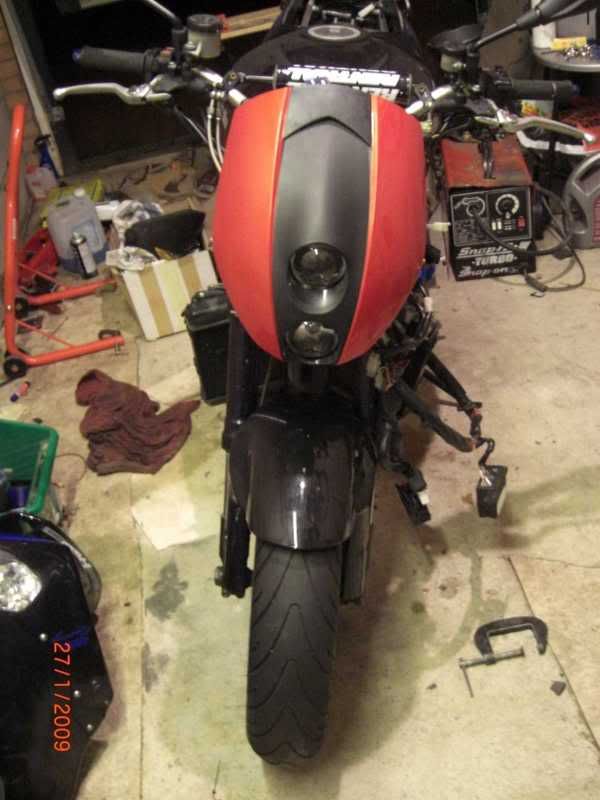

#10 Post by sthomson1 » Tue Jan 27, 2009 10:27 pm
Thanks to Tommy, I got a hold of the ktm duke 2 unit.
Made a bracket for the bottom (the assembly swings forward/down to access the bulbs), hooked up the lights...all i need to do is get some fork brackets to hold the assembly in at the top, and make a mounting plate for the clocks.
All the cabling will fit up behind the fairing, and the fuse boxes will be zip tied to the fork legs.
Heres some photos of it temporarily mounted.
sabestian
Posts: 836
Joined: Sun Jan 14, 2007 11:02 am
#11 Post by sabestian » Wed Jan 28, 2009 11:14 am
Looks fantastic, mate, and the clock (or should I say 'dashboard') fits in very nicely (always a concern size-wise). Keep us posted, I really want to see the final result!
