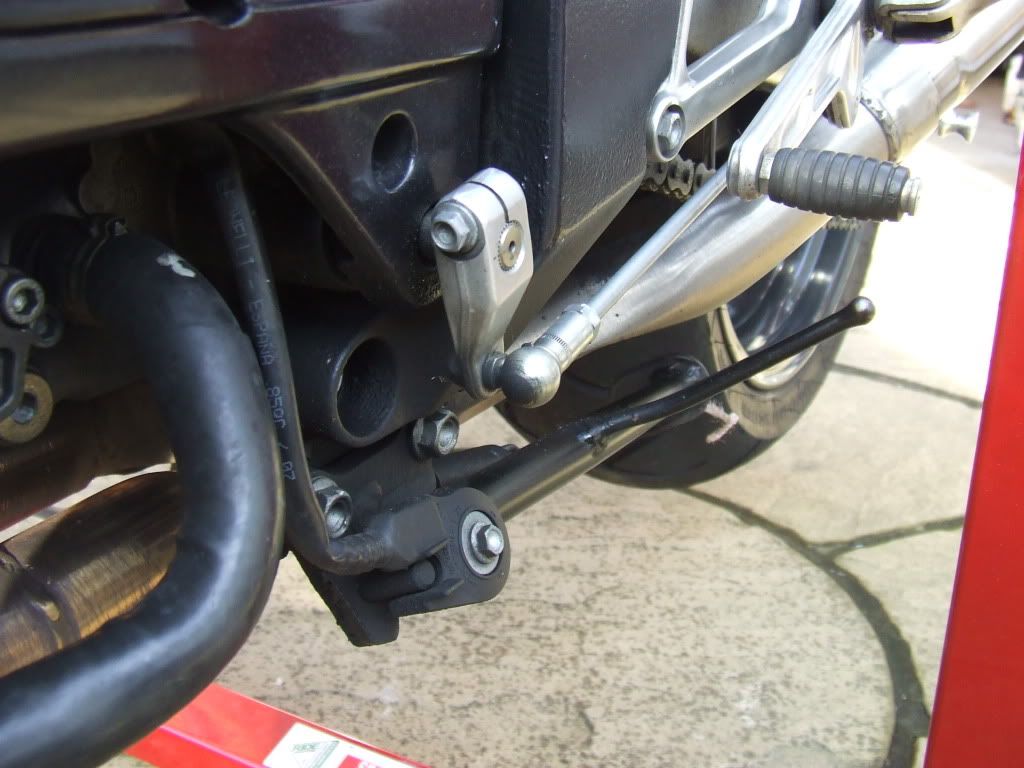

After suffering the ignomy, and expense of the side stand fallover I bought a replacement sidestand from that popular on line auction.
The replacement fit is plug and play, and as you can see in the "after" photo the angle is much better. But the stand is longer so the bike sits more upright than before, making it more unstable, see "after" photo. The bike is bog stock so why is this happening? The guy, who is local to me, says he will do me one 1/2" shorter no problem, but has anyone got any theories as to why its so upright?
I await the fonts of all Falco Knoweledge.
After
Before
[/img]Image
OEM Stowed
[/img]Image
Replacement stowed
Image[/img]

Mmmmmmmmm, was about to order one of these as well. It does seem that it is too long and compensates for the increased angle of the stand. Be interesting to see what others think. Is it because the Falco sits lower on the rear suspension linkage compared to the Mille/Touno, as he claims they fit all?

I am still on the sachs unit, with plenty of preload, that wont effect the ride height though. In fact if ride height were increased then the lean angle would increase as the stand would be higher off the ground.
I have looked at HowardQ`s pic and it has a greater lean angle, but the tang is further up the sidestand. The e bay guy said it was re designed so as not to fall directly underneath the footpeg.
He will make me a shorter one so we will see.

Nope, mine is an '04 bike, and it's got (had!) the same piece-of-cheese stand as the earlier bikes - swapped it out for the Gixxer one. Much happier with angle-of-dangle, and the increased footprint it gives (increases the distance the bike's got to lean before tippover).
Only problem I've got with the Gixxer stand, the distance between the two mounting lugs is slightly more than the stock, so using it on the Falco bracket means it can move across the bike (on the mounting bolt) - fine when it's down, but when up it can "clang" the exhaust when folding up or moving. Just fashioned a (very thin!) washer to go between the bracket and the stand, so it holds it straight and angled away from the exhaust.
Scorpio, I wouldn't go for a shorter stand - it will make the bike tip further, but it will also bring the bike's CoG closer to the stand's foot - meaning it's easier to tip it over the stand (same problem as the stock stand) - I'd try and get one that kicks out further - increases lean towards the stand, but also increases the footprint.
