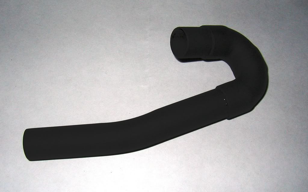

#1 Post by Nooj » Sun Aug 31, 2008 6:06 pm
I reckon not. If you want to fit a Mille/Tuono oil tank to your Falco try making something like this up from some old copper pipe and a couple of 90* bends:
It will go from the spigot on top left corner of the Falco cooler matrix, attaching with a small bit of the original pipe, down the side of the cooler and in front of the Mille oil tank, before meeting up with the remaining length of the original hose from the bottom of the oil tank.
With it being made of copper it won't rust through and the VHT paint won't flake, it'll just sit there looking like part of the bike that's always been there.
#2 Post by Falcopops » Sun Aug 31, 2008 10:21 pm
Looks a bit like my kids toy snorkel!
Need to see it fitted, nice fettle BTW

Pic of the new oil pipe.

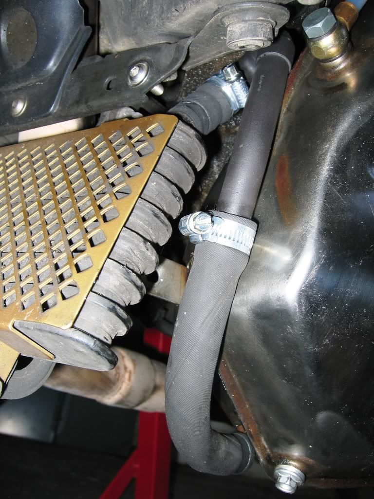

#9 Post by Nooj » Wed Sep 03, 2008 6:05 pm
This is how it fits on the bike, it's a very tight squeeze, but it's in there and not straining the hose or rubbing on anything.
I'm sticking with the Renegade full system rather than swapping to the Mille headers, which means I've got a fair amount of room under the bike, between the oil tank and the front down pipe, to fit something special into, :D
#10 Post by Fausto » Wed Sep 03, 2008 6:13 pm
Looks like a clever solution to whatever problem it was.
My only very slight concern would be the grip of the flexi oil pipes on the new copper pipe. Usually these joints involve forcing the hose over a flange on the end of the spigot so that with a hose clip fitted it can't come off.
With both joints facing the same way is it at all possible that once hot and possibly lubricated by oil the copper pipe could travel upwards and disconnect itself?
Probably not though. I'm sure you have it covered Nooj but saying it all the same for safety sake.
#11 Post by Nooj » Thu Sep 04, 2008 2:10 pm
I wondered about that, but having tried to twist them off with the jubilee clips done up nice and tight, they didn't want to move. The VHT paint has quite a corse finish which should aid grip as well.
#12 Post by D-Rider » Thu Sep 04, 2008 2:50 pm
If it were a problem, maybe soldering a conex olive on the end of the pipe would sort you out.
#13 Post by Nooj » Thu Sep 04, 2008 8:00 pm
I don't think the hose would go over anything wider than that pipe, it took all my strength to get it on as it was. If it is a problem I'll just make another section out of some smaller bore tubing and have some kind of flange or as you say, olive, on each end.
