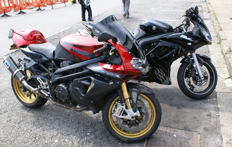

Still got a few things I want to do... but thats for next winter. Here is how she is for now - photos taken in Chichester yesterday (Sunday): (the SV belongs to one of my mates):
That goofy-looking git is me.
Notice the ugly but MOT-friendly tape over my EU-spec light. Should remove it now until next year's MOT.
I know - I need to cable-tie the remote adjuster cable to the subframe.

#4 Post by Falcopops » Mon Jun 02, 2008 9:47 pm
Very sweek Syltiz.
What did you use to shim up the clip ons to fit the Ohlins forks, only I might need to know by the end of the week :smt002

I got 1mm shims made from aluminium. 1mm on each side makes up the 2mm difference between Showa and Ohlins. That was only for the clip-ons - the top and bottom triple clamps are from an RSVR. Toughest part of this whole job, was removing the ignition - damn rivet-type security bolt was a nightmare.

I tried drilling it out but had no luck even after making a small indentation with a hammer and chisel for the drill bit to get some purchase in. Eventually I had to cut it out with a dremel... its not a pretty solution as the one side of the ignition barrel mounting point is thinner than the other non-security side. Its a real home-mechanics bodge job. Im not too concerned though as the other mounting point is fine and these mounting points dont have to bear any stress (well - depends how hard you turn the key!).
Getting back into the RSV clamp - I just used a screw of the right thread. The security feature is lost obviously.

The other time-consumer on this was the decision about how far down the forks the yolks should be. In the end I decided on four rings showing - this is standard setup on the RSV. The result is a much quicker steering bike - even my talentless riding ability can feel this. It does make for nice cornering... while not too nervous - but comfort has been sacrificed.

Looks different from last year, but one thing irks me and thats the nobbly bits either side of the tank, what they for?
Oh and very nice, but far to "show room clean" :smt005

The "show room clean" was some serious elbow grease and turtle wax on Saturday morning. Prior to that she looked like a whore's handbag :smt001
The knobly bits... well.... i do find it helps with fatigue by giving better grip of the tank with my knees. It might be a placebo effect but even so... it seems to work for me.
