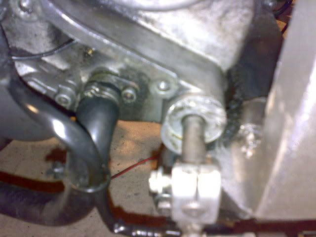

Well, after losing the front sprocket and resulting damage, my bike has languished at the side of my house until now (had to bust a hole in a brick wall etc to get the bike into my new workshop). Starting to sort out the damage caused and thought a few pics might keep you entertained for a couple of mins. Phone photos so a bit crap I'm afraid.
1st pics show where the sprocket ended up. Tried to eat its way into the bottom cross member on the frame. It was stopped by the swingarm. Fortunately there is only 'minor' damage (cosmetic) to both which you can't see once the sprocket cover is on. I had to drop the swingarm out to get the sprocket/chain out however without causing more damage.
2nd pics show the damage that is causing concern. Around the gear selector shaft should be an oil seal held in place by part of the engine casing. This has been smashed off in 2/3rds so nothing to hole the oil seal in now. I'm hoping I might be able to get a jubilee clip on as there is just enough material there I hope. If not.............new engine? Anyone got any ideas?

If you were really good, you could build up the area using chemical metal. you'd have to grease the shaft, seals, etc etc in order to prevent it from setting to the shaft, and possibly utilise a greased jubilee clip to do the outer surface...to get a semi decent housing finish..if that makes sense..
Ive got 'stuff' at work for doing battlefield damage repairs, I could possibly get you a couple of sachets of it.. it's like chemical metal, but the proper stuff.. you can build engine components out of it!!
Definately better than a whole new engine..

That would be brilliant m8, thanks. I 'think' I can get a jubilee clip on to it and have just ordered a few seals to play with too so would appreciate the sachet and i'll try building it up round the seal. Its not a high load area so I'd hope it'll fix ok.

Yes, in a fashion. The metal epoxy is brill stuff but I've still got a little weep from somewhere. Thought all was brilliant, left in my workshop for a few days, no leaks or anything. Put it all back together and took it for a run. All brill there (stopped a couple of times and no pool under bike). Got home and it starts weeping from the same area. Haven't had time to check it yet as I'm in the process of putting a new kitchen in but fingers crossed its no too much to worry about. Still got some stuff to bung it up with.
