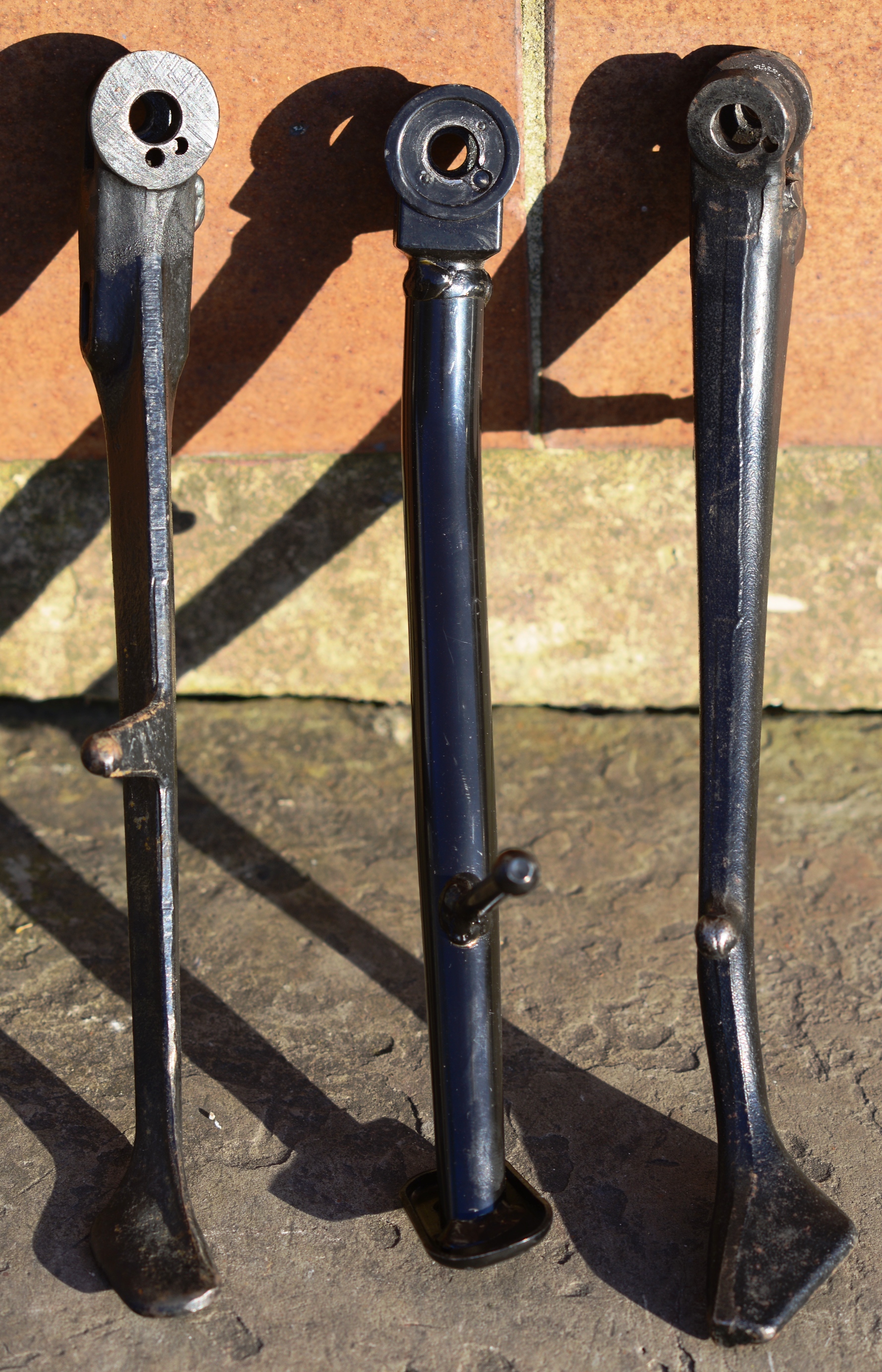

Don't know enough about the Firestorm stand to comment, same with the Gixxer stand, tbh. Many years ago I had a Gixxer stand modified to fit the Falco but it was a real faff and probably not worth it. My favourite stand is the Honda Blackbird (CBR1100XX) side stand. It bolts straight on, but just needs a hole drilling at approx 4 o'clock for the pin to fit in the correct place. Here's a pic of (L to R) a BB stand, a Blade stand and the GSXR stand showing angle of dangle.

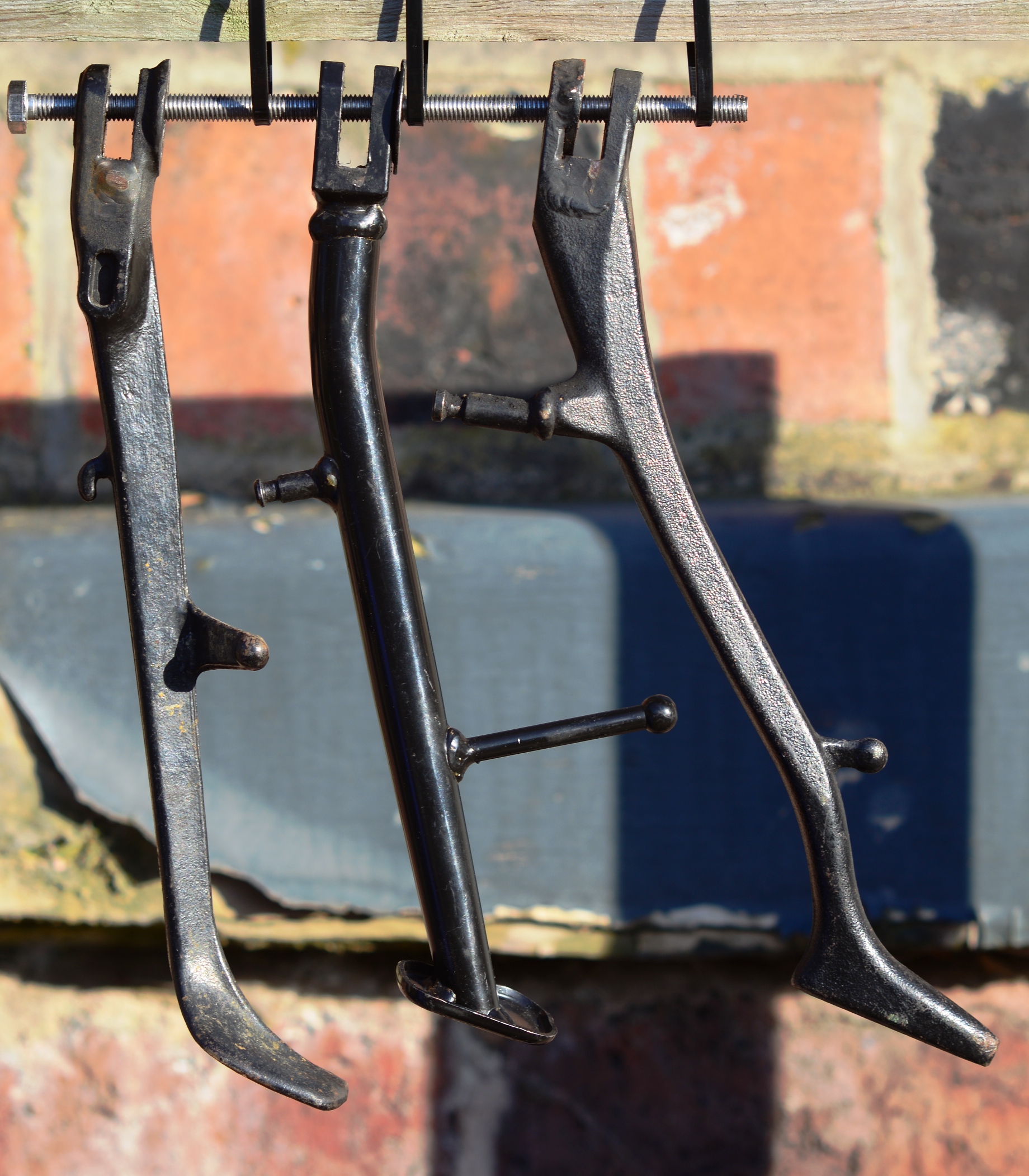

The BB stand is slightly longer and will stand the bike slightly more upright - ideal if you've raised the rear ride height. The Blade stands are getting pricey now everyone knows they fit, and I wouldn't recommend the GSXR stand as it kicks out too far and is a PITA to modify. Same stands in same order, but front view:

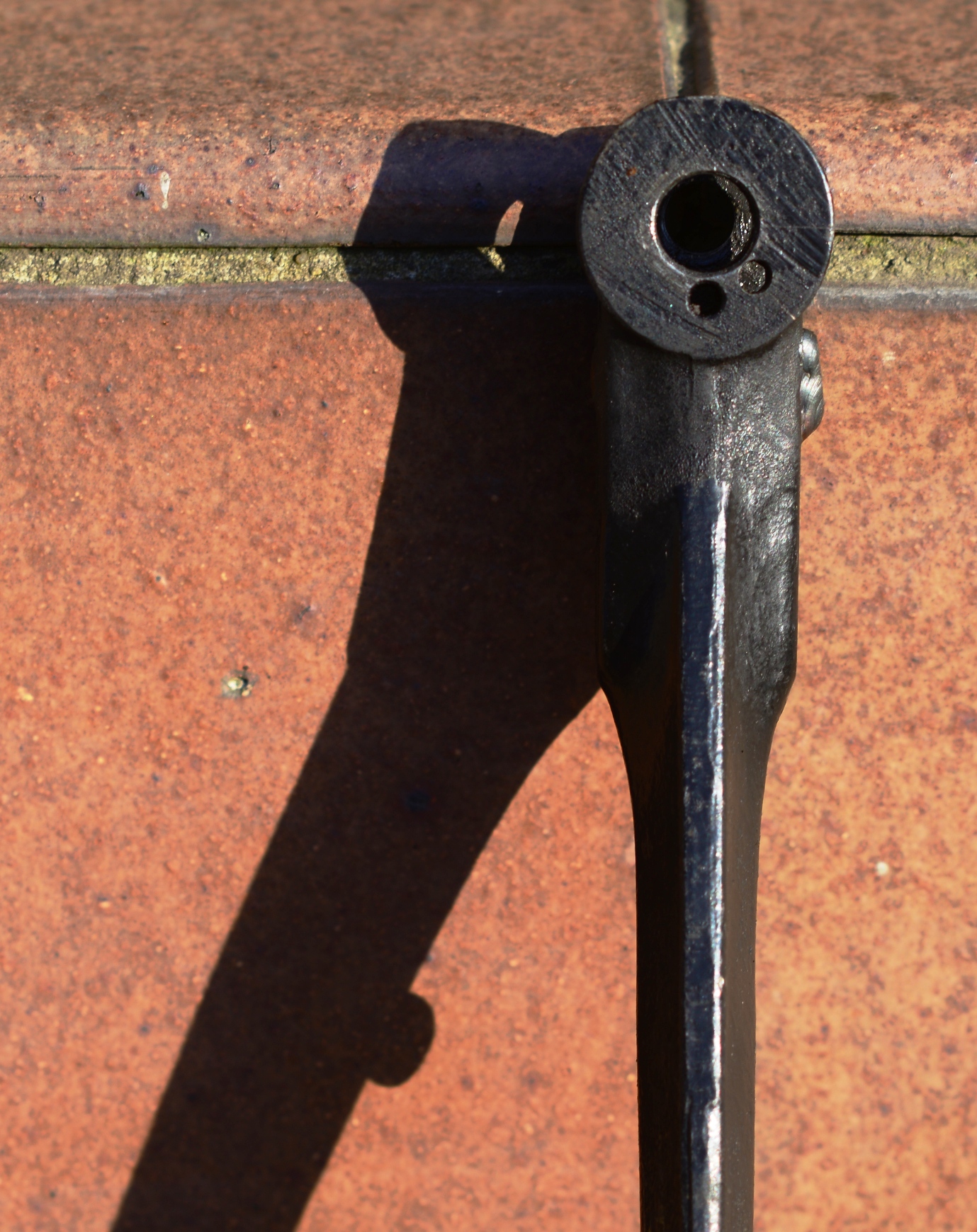

And lastly a view of the extra hole you'll need to drill on the BB stand if you want it to fit straight off. I have heard of people jiggling the switch pin to a different location so it works without any drilling, but it's not something I've done.
