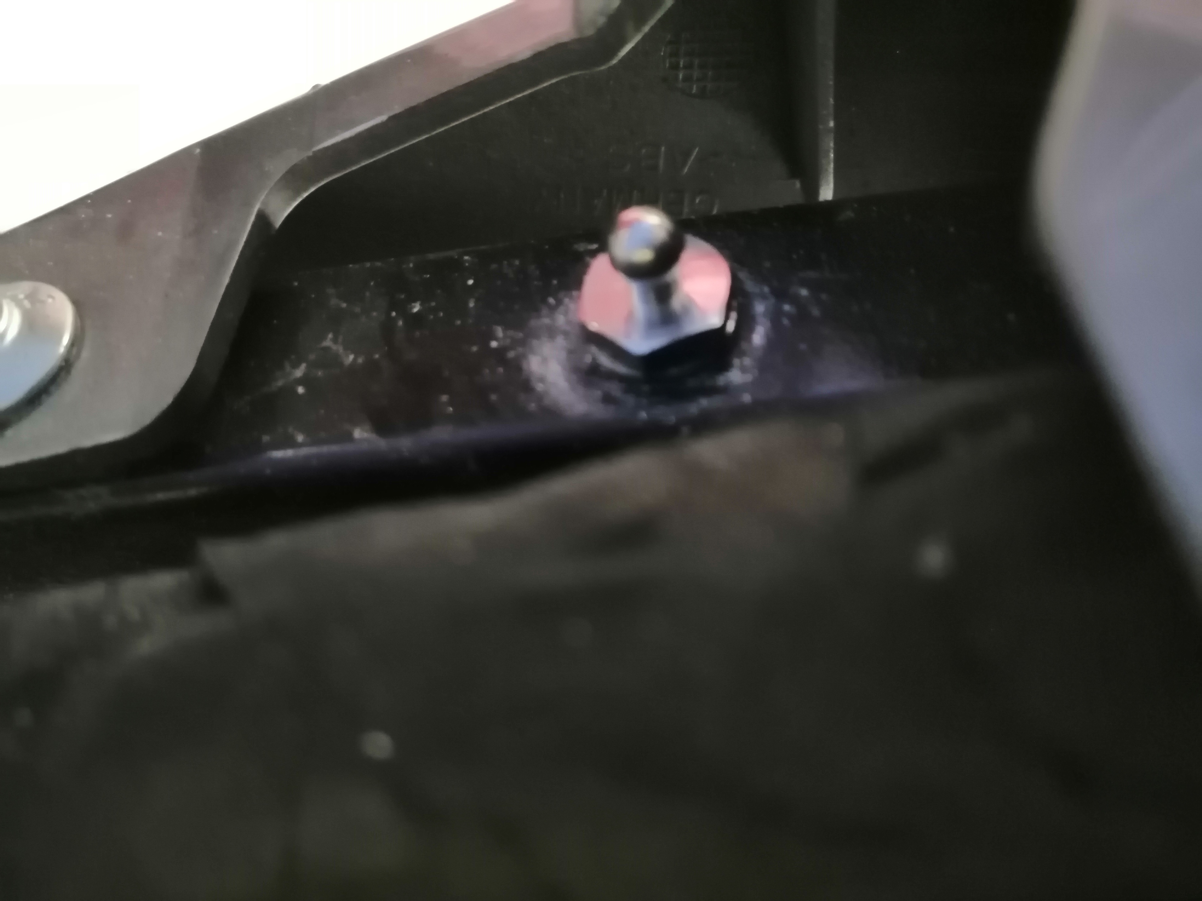

I didn't have a problem with the std seat using the hex head bolts but, I bought a spare std seat base that has a Sargant seat cover and internals fitted that is very hard to push the sides in for bolt access, hense my reason for trying the pins.

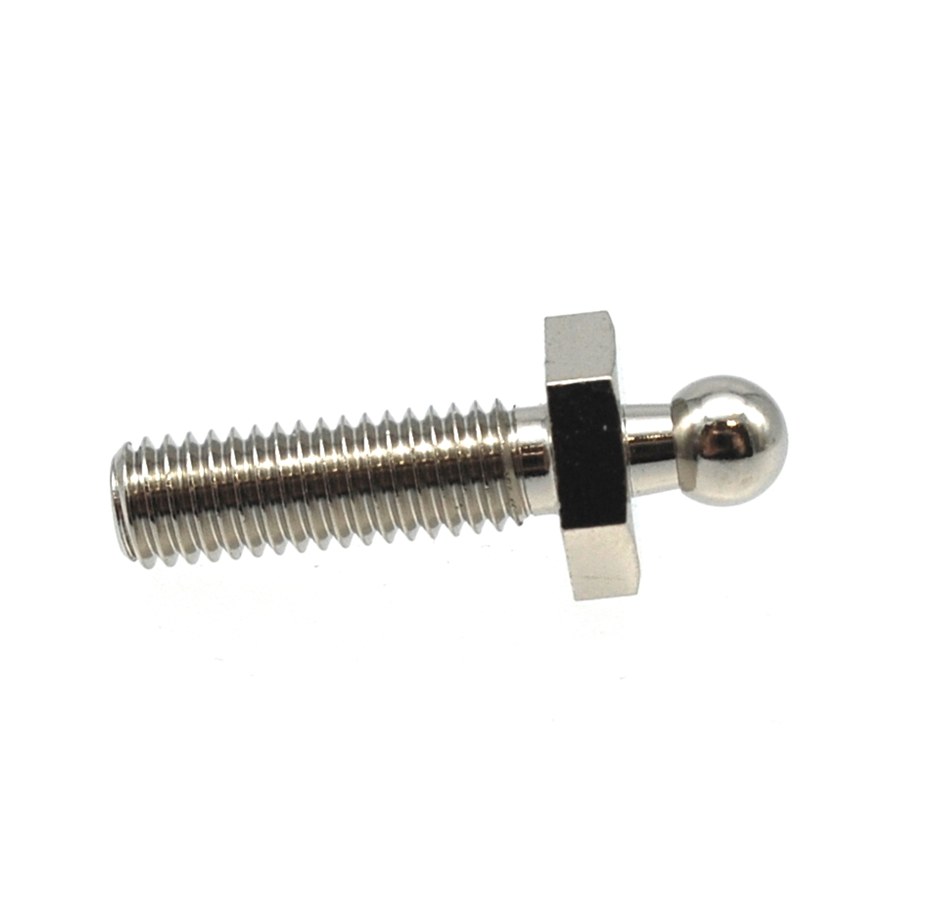

https://www.apworkshops.co.uk/quick-rel ... -pair.html
I had to clean out the existing bolt holes before the pins would screw fully into place.
On the LHS the thread just hits the top of the coil pack!
A locking nut is meant to be fitted to the under side of each pin but, the RHS was enough of a pain to complete so I used some thread lock on the LHS.

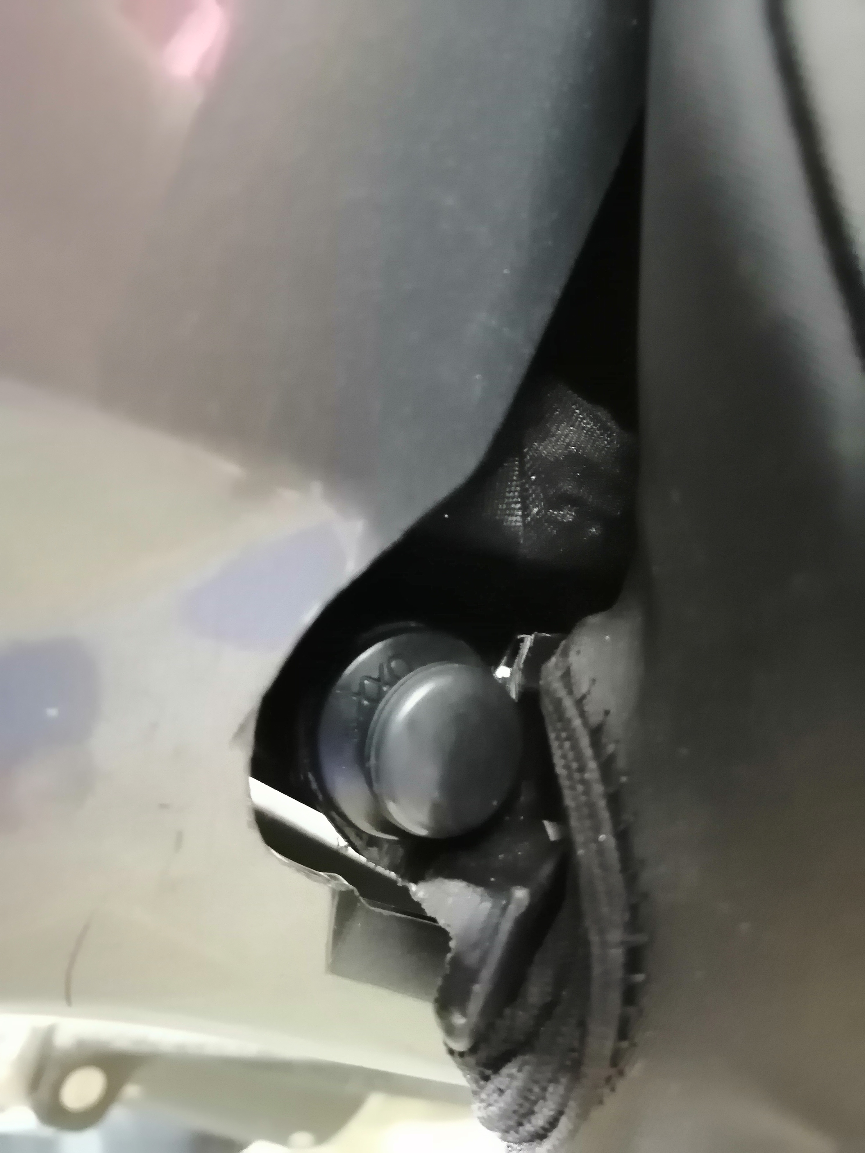

My 'new' seat will not fit easily at all. It has to be LHS first then quite some pushing and effort on the other side to land it.
I don't have enough space to use the key ring loops (which I thought was a good, simple idea) for 'pulling the pins' but, I'm not going to be able to remove the seat at all currently without a re-think on the design.
Shame, as its a nice idea with good quality materials at a decent price.
I'll report back :-)

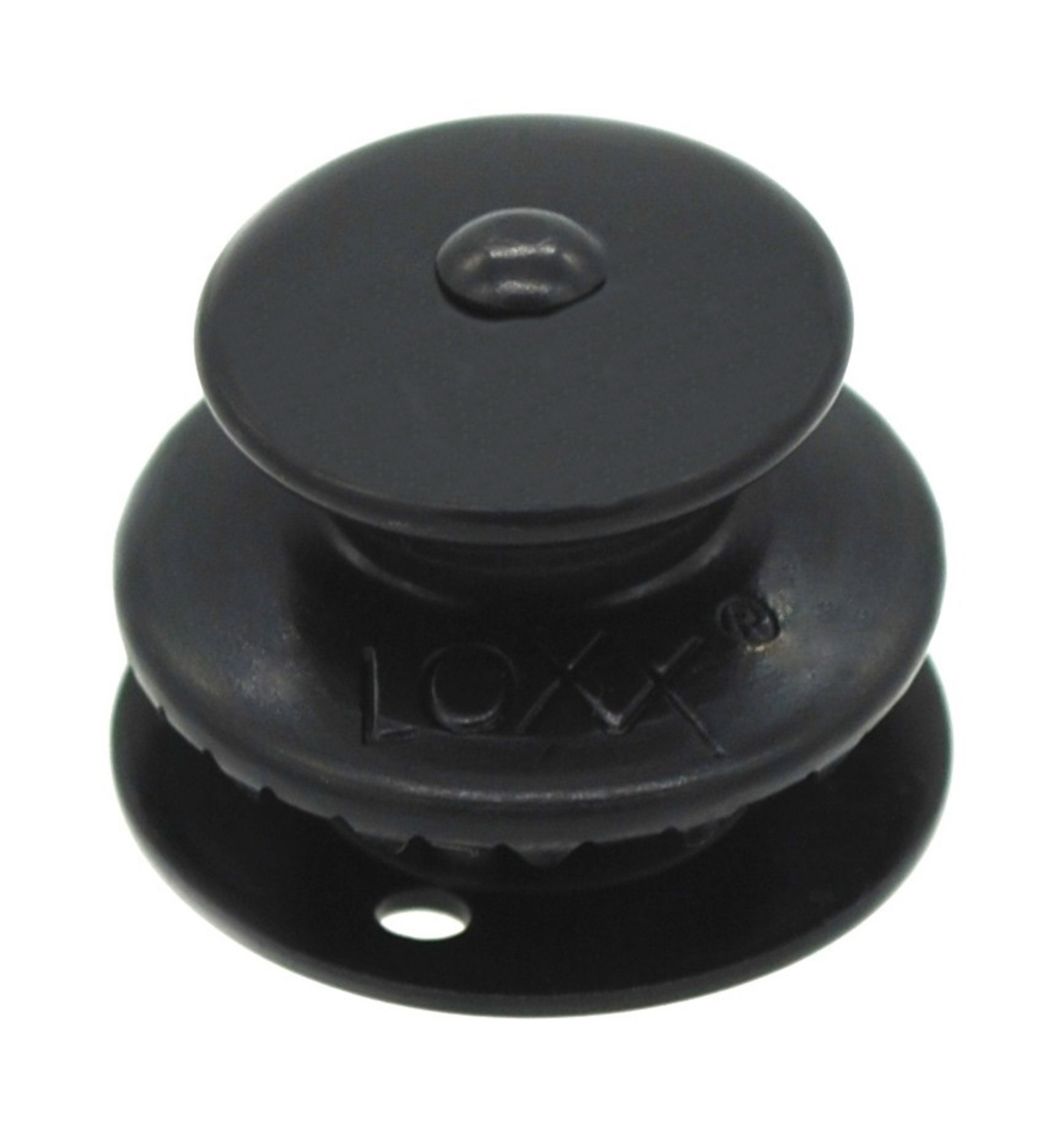

I used these on an S1000RR seat. Bit of faff to get everything lined up (there's not a lot of room to spare under that seat!) but much neater result. The brand was Loxx, made for boating, keeping tarpaulins down (sort of thing)
