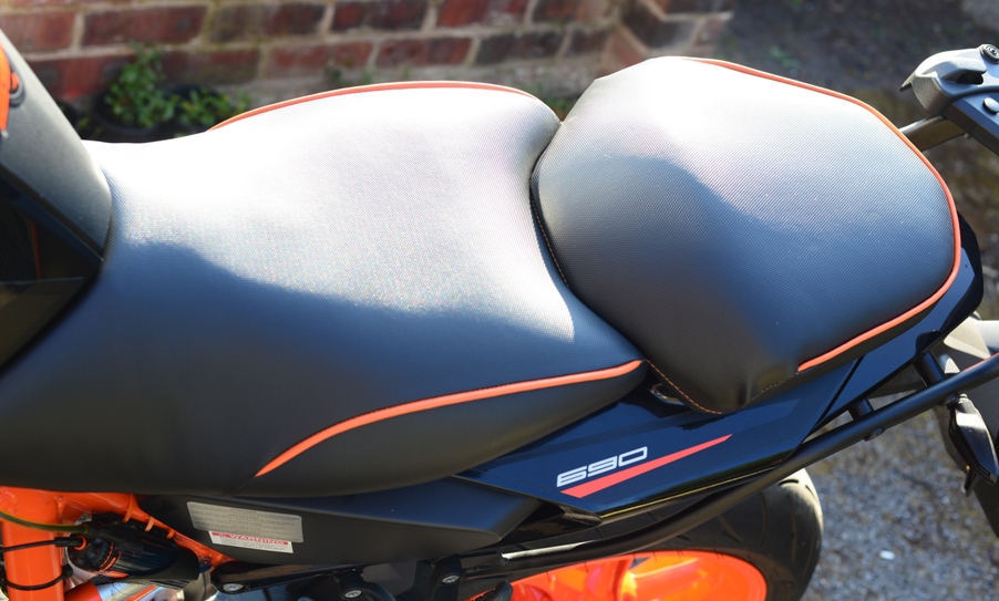

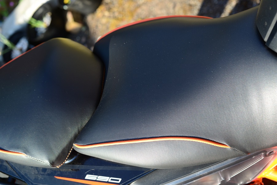

The seats arrived back yesterday and it's clear that there now is substantial padding. Even just sitting on the bike statically the extra comfort is obvious. Here's a pic of Tony's work:
Plumptious, baby! And another view...

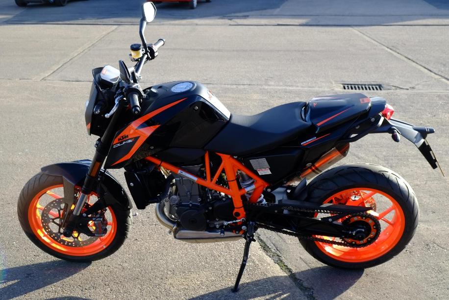

Here's a view of the original rider's seat on the bike:

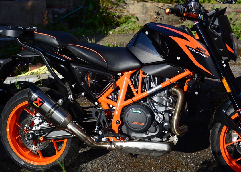

And the bike with its modified seats:

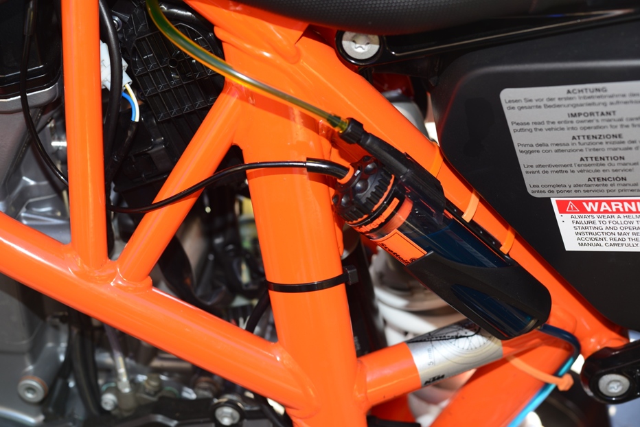

With a bit of luck the weather will continue fine tomorrow and I'll be able to give the rider's seat the all-important road test. The other thing I'll want to test out is the Scottoiler that I fitted last weekend. I bought the KTM-specific version (with the all-important orange detailing on the metering valve) and found an ideal spot on one of the frame spars. Here's a general photo:
They've intrduced a nifty little holder for the RMV which you cable tie to the frame tubes without clamping the RMV itself. The vacuum take off is via a tee-piece into a vacuum tube and the positioning of the RMV is well out of the way of my leg but easily accessible to adjust the flow rate (even on the move, should I so choose).

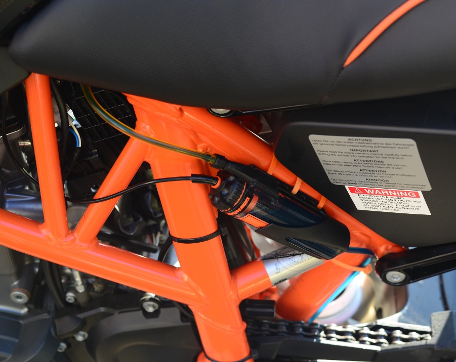

Here's a clse-up of the RMV fitment:
I had originally wanted to use a dual injector fitment, but the design of the swingarm ruled that out. In the end I used the single injector fitment supplied with the KTM-specific kit. No point in reinventing the wheel.
