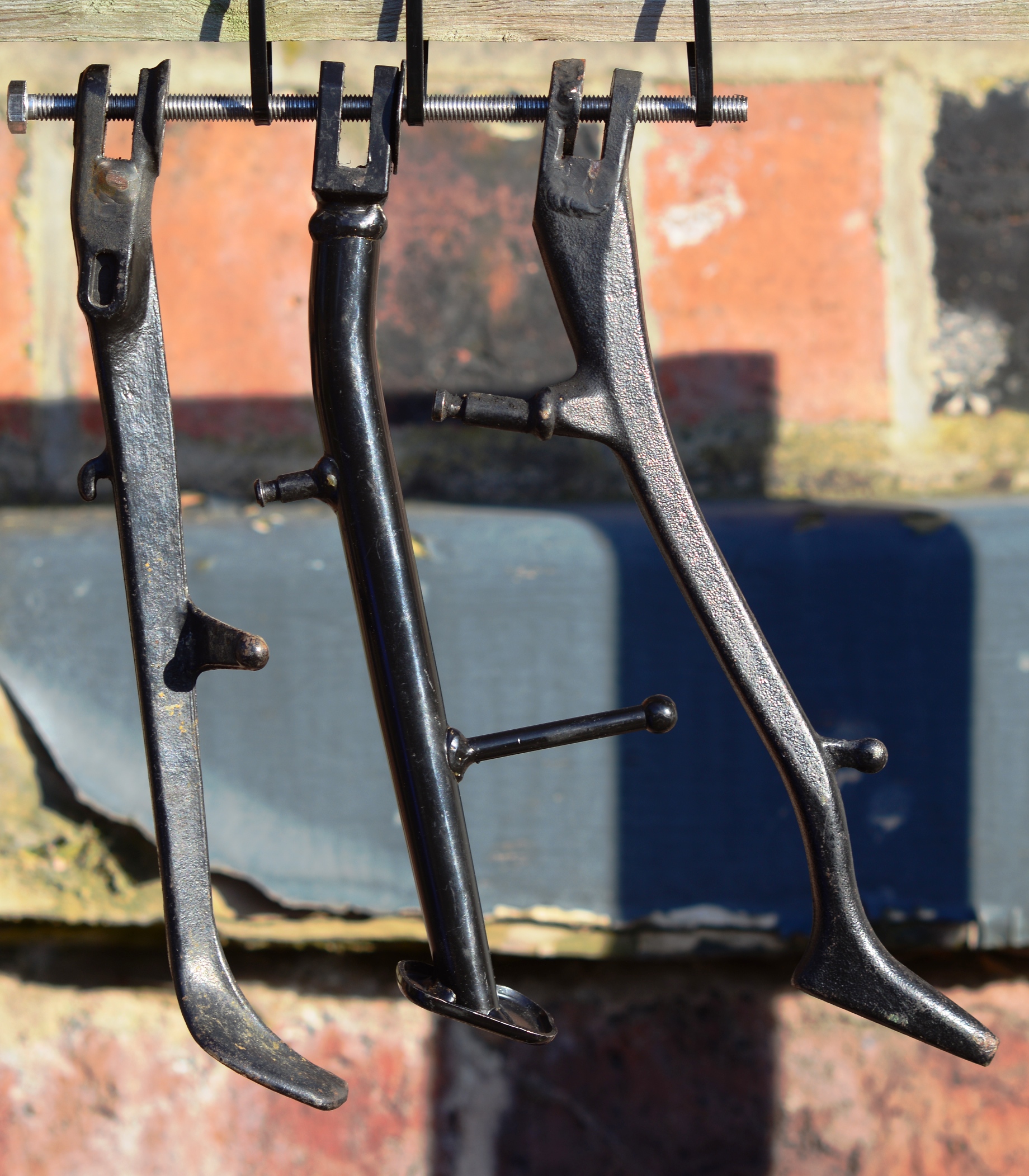

Anyway - during the course of my Falco ownership I've tried 3 different side stands (4 if you count the poxy original). First was a Suzuki GSXR1000 stand of indeterminate vintage that required quite a bit of fettling to fit, but did a fine job. It was only when I started to really jack up the rear ride height that I started to look for a longer alternative.
The longer alternative came in the form of a side stand off a Honda CBR1100XX (more commonly known as a Blackbird). This was much simpler to make fit, only requiring the drilling of a differently-placed hole for the side stand switch pin to fit inside, and works very well if you've gone to town on rear ride height (I have).
The other one was a Honda Fireblade 04-07 stand, which I believe Griff has sold shed loads of. I had the Blue Falco at the time and was also planning a trip to the USA, so I availed myself of cheap USA pricing to get one. In the end I went for a Blackbird stand on the Blue Falco, as that too had substantially increased ride height.
Anyway, here's a 'Usual Suspects' shot of the three stands in question:
They are from L-R - Blackbird, Fireplace, GSXR Thou. The extra stand length of the BB item can clearly be seen. No stands and only 3 cable ties were harmed in the course of this shot.

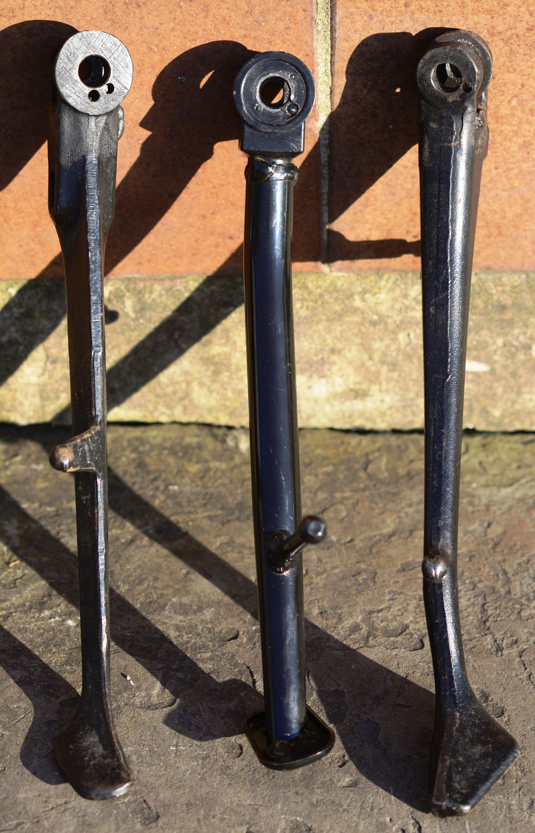

Next up is a side-on view of the mounting points and switch pin holes. Same order as before:

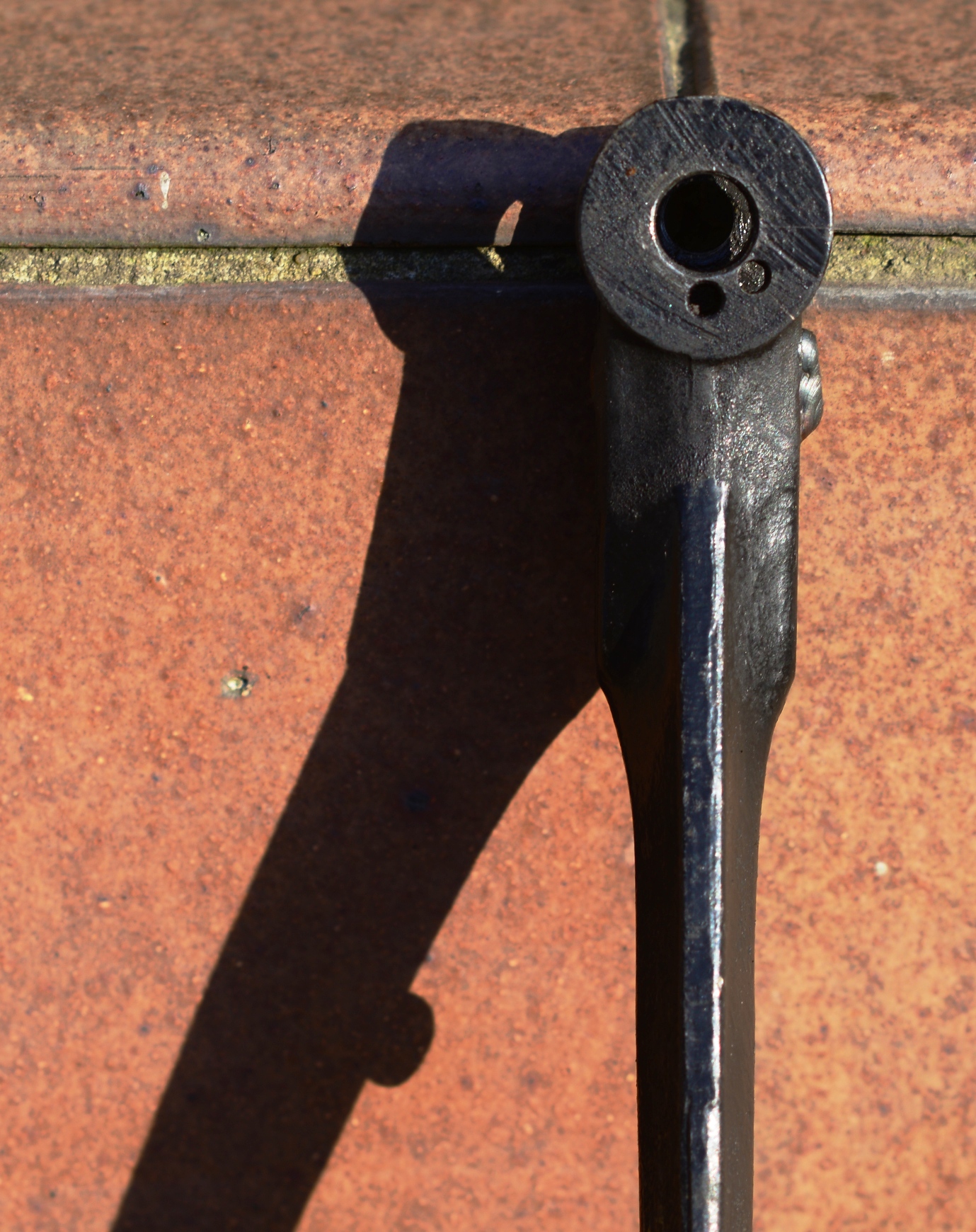

Lastly, a close up of the hole that needs to be drilled in the BB stand. The new hole is the one at 4 o'clock (and a bit) and is a 4mm hole.

Hahahaha, Love the spelling mistakemangocrazy wrote:The longer alternative came in the form of a side stand off a Honda CBR1100XX (more commonly known as a Blackbird).
PS I have 3 spare Blackbird side stands, 2 of which are 1.5 and 2 inches longer than original for when I change my suspension, might still be a bit short if I go as high as my old Blackbird.
A good clear bit of detail there !
I can vouch for the BB stand being a really good fit on the stock bracket, easy to fit, 25 mins work including drilling a new hole for the switch pin ( with a hand drill ).
The BB stand is the perfect partner for an Ohlins unit with the height jacked up

Another vote for the blackbird stand, didn't even have to drill a new hole, just snapped off the 'prong' on the swithch with pliers, installed it and did the bolt up tight.
Yeah I know you all frown on the gheto approach to modding things and the correct way is lalala.
It works, not touched it in 4+ years, why make things more difficult.
Fix it, ride it, enjoy it.
Think it took all of 10 mins.
