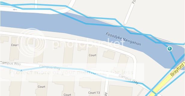

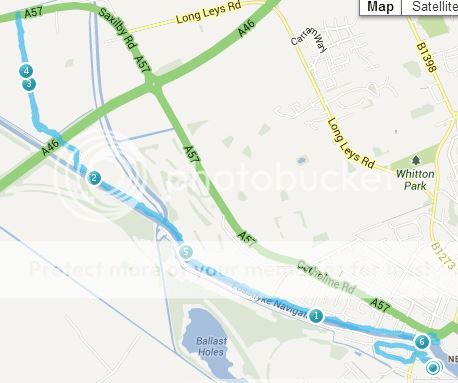

Also look at these images.
The first image shows the run I tracked as a whole It provides a good indication as to where I ran geographically.
However, when we zoom in closer, we can see the individual points and the lines connecting them.
I can categorically confirm to you that I was not jumping in and out of the river constantly. That would be a bit strange.
Now, you and I both know that the recorded points are not precisely where I ran but that is there the GPS receiver was told it was by the GPS satellites. There is no extra accuracy hidden in the latitude or longitude co ordinates, that is exactly where the phone thought it was.
To change any of the recorded points would be post rendering and what you would end up with is a nicely plotted map, but it would in no way represent the data recorded by the device. It would never ever hold up in court.
Unless the GPS device was able to record frequent and accurate location data (every second, maximum) and was accurate to within a foot, then you will have a hard time using this as evidence in court.
I'm sorry if what I have posted above seems a bit harsh, but Its the truth. You simply cannot get away with manipulating the data.
Anyway, I hope it helped? Took me long enough to make this post :P
