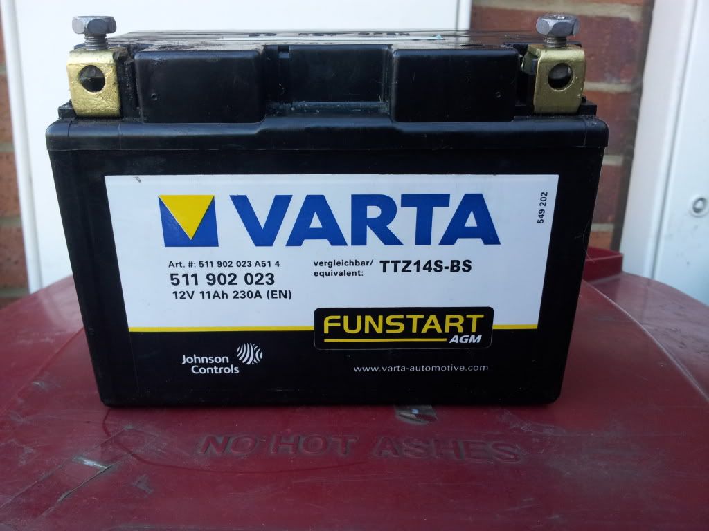

This is the battery thats fitted and it doesn't look to have been on too long but cant be sure so another 1 on its way now. Motobatt 1! Hope this cures the problem :smt017

if you have had it on charge over night and it still didnt start i would say it was the battery. hope you get it sorted nothing worse then not being able to rely on your bike
