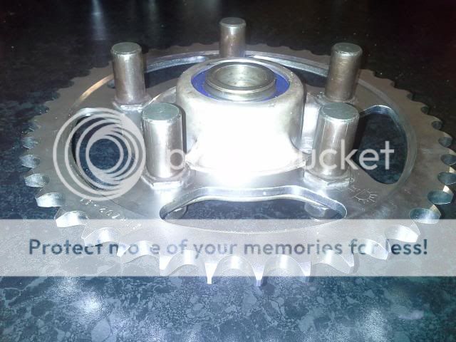

#7 Post by joecrx » Sun Mar 17, 2013 1:02 pm
this pic shows the bolts sitting way to proud
this one shows the lip on the sprocket
this one shouws the center spacer should it be sitting proud of the carrier ?

#8 Post by wayno » Sun Mar 17, 2013 7:08 pm
It's because the disc is thinned out, I had the same problem, put some 2mm spacers between the disc and the shoulder to put the thread end in the original position.

#13 Post by wayno » Wed Mar 20, 2013 9:03 am
It's not the distance between spacers or anything like that, it is just that as the sprocket is thinner the studs stick out a couple of mm further (bloody italians doing things backwards) this causes the heads of these studs to catch on the weld.
By the way my sprocket is a DID and I had this exact same problem.
