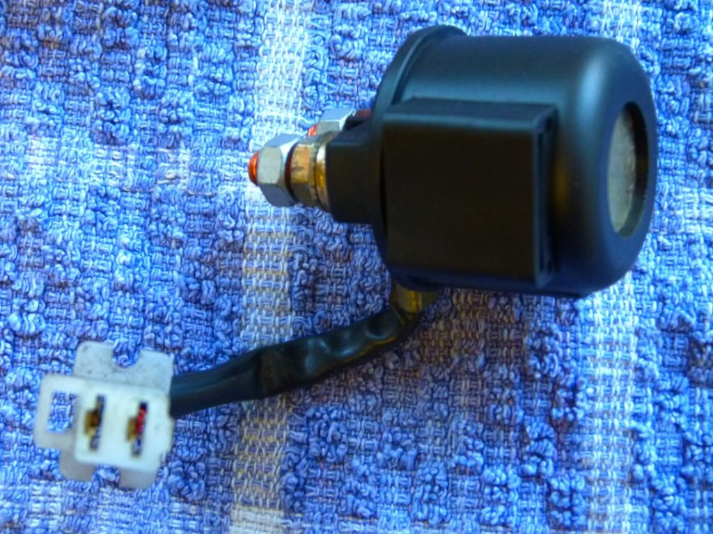

#1 Post by fatboy » Tue Sep 04, 2012 9:18 am
Just recieved a starter relay, the 2 pin connector from relay to loom has 2 wires, the connector from loom to relay is 2 pin but 3 wires :smt017
Have I got the wrong one again
Edit. may have answered my own question !
Here's the nothings ever simple bit.
dont have the old relay to compare,lost in a recent house move, have not looked at the bike in the 2 years of my legal battles with DVLA,bike been in mates workshop but he is convinced the old relay was 3 wires to 3 wires,
just compared wiring on new relay,yellow/red from loom meets yellow/red on relay,makes sense ?
#2 Post by randomsquid » Tue Sep 04, 2012 7:43 pm
This is the 50v relay I took off mine. One red/white wire. One blue/white/black.
New one came in a box for an aprilia atlantic 125. Can't remember what it looked like but it plugged in ok.
#3 Post by D-Rider » Tue Sep 04, 2012 11:03 pm
I had to swap the connector over on my one but it works fine.
#4 Post by randomsquid » Wed Sep 05, 2012 9:09 am
Mine was a straight fit connector wise. Might have swapped the little rubber house between the two but that was it.

#6 Post by fatboy » Wed Sep 05, 2012 3:30 pm
Thanks guys, the relay IS for an Atlantic 125 so should be good.
Wish i could say the same about Parcelfarce......
I ordered a rear paddock stand Monday evening, paid an exta £9.90 for Express 24 delivery which I foolishly thought meant delivered within 24 hours............................................................................................................................tick tock,tick tock
Wayno, have a look at all your battery connections to starter and earth. A crudded up connection will give you shagged battery symptoms were as relays tend to work or not work. Could be starter motor on its way out
