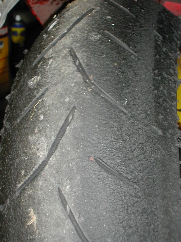

What the hell caused this to the rear tyre . Is it poor suspension or pressure or the fact it was a soft compound on a reasonably hot day. The pressure was 29psi the tyre was a Bridgestone bt002 soft. Really need to know what to sort out. :smt017

#4 Post by Kwackerz » Tue Apr 10, 2007 4:51 pm
Big V Twin, Soft Compound, Hot Day, Racetrack, Not a new tyre (possibly?)
That tyre looks normal for coming off the track at the end of a decent day's circulating?
I'd say if anything it'd be the rider input.
Hard out of the corners were we? :smt002

#5 Post by John1000 » Tue Apr 10, 2007 4:53 pm
Silverstone was the place and as for time haven’t a clue but I would say I was near the top end of the inters pace wise.
And have a bit of a confession I wasn’t on the Falco. :smt012
Would like to know if it was heat or a poorly set up bike.
And as fer getting my knee down sometimes I did some times I didn’t. :smt019

#6 Post by John1000 » Tue Apr 10, 2007 4:56 pm
Sorry should have said new tyre and looked like that after fist session. :smt017
#7 Post by Kwackerz » Tue Apr 10, 2007 4:58 pm
After the first session!! Jeezus! I reckon that was a soft compound, and then some!!
What bike was it btw. :smt017 Fireblade?
#8 Post by Kwackerz » Tue Apr 10, 2007 5:02 pm
Have a look at this site
http://www.feelthetrack.com/tire-wear.html
Gives quite a good explanation of the varying wear types. I'd bank on cold tear maybe? Would go with it being the first session 'n all.

#9 Post by John1000 » Tue Apr 10, 2007 5:09 pm
Twas on me R1Image
It carried wearing the same throughout the day. The pic doesn’t really show just how knackered it is. :smt012

#10 Post by John1000 » Tue Apr 10, 2007 5:14 pm
Ha that explains it . According to the link I am suffering from heat tear with a little cold tear and maybe a little shock tear. :smt017 :smt017
#11 Post by Kwackerz » Tue Apr 10, 2007 5:20 pm
So your suspension is shot then! :smt108
Do you use tyre warmers?
#12 Post by Fausto » Tue Apr 10, 2007 5:42 pm
Are you running a little under inflated? That'd make heat build up worse as I understand it.
