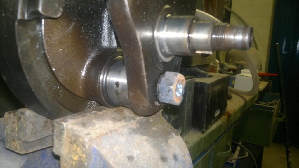

The first attempt at removing the sludge trap bung proved to be an EPIC failure.
So welded a nut to the bastard. The heat of welding and the extra torque of a spanner saw light work of it.
Once the plug was removed I was greeted by this horrible mess. Chock full of dry, black sludgy crap. No wonder I was having 'wet sumping' issues. The bloody oil pressure relief valve must've been permanently open.

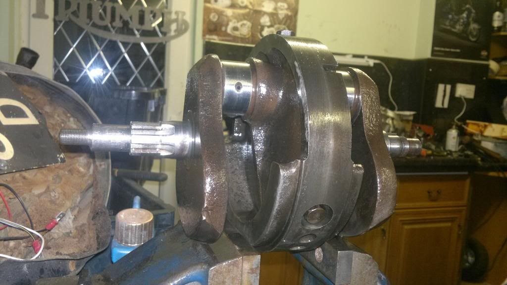

The crank, rods and pistons are away for dynamic balancing on Friday. They're also going to re-grind the crank journals to -0.010" as the lack of lubrication has caused some scaring.

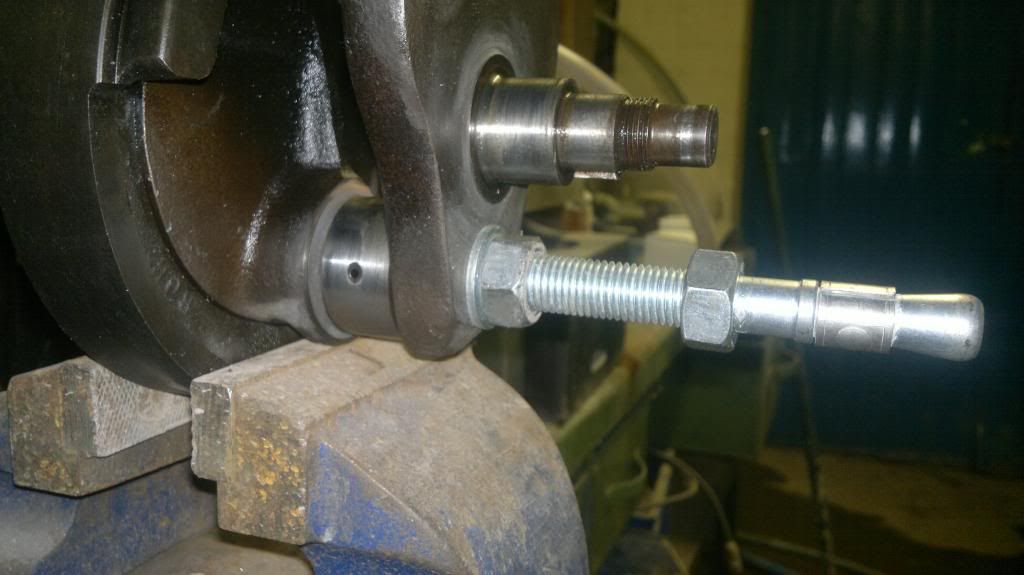

Right then. Time to get that sludge trap tube out!

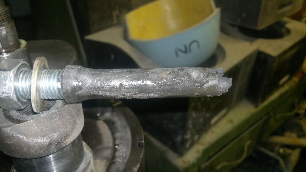

The sludge trap on these machines is located inside the crank shaft. The tube in question helps catch microscopic particles in the oil using centrifugal force. Over the years this builds up and needs to be cleaned out. The only way to do this is to strip the engine down. It's good practice to do this job every time the engine has to come apart for whatever reason. New parts are around £10, so it's a bit of a no brainer.

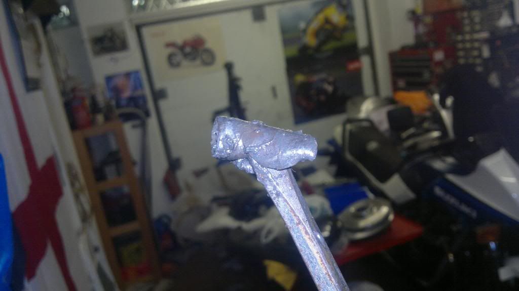

Having tapped the inside of the tube slightly, I sent a bolt down it and started to draw the tube out. Holding the bolt still and undoing the nut closest to the crank pulls the tube off it's seat. There are other methods, but I find doing it this way by far the easiest.

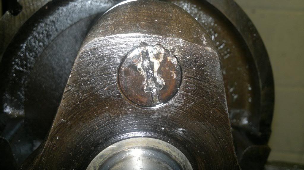

Out pops the tube.. But hang on.. Something isn't right here. Some of it's missing. NOOOOO!!!
It's still in the feckin hole! Argh! At this point I packed up n' went home slightly miffed and a bit annoyed.
After a couple of stiff drinks it was time to get back and get the bastard out. This involved using one of the aforementiond 'other methods'. IE, jab the bastard out with great bodging accuracy.
Thank fook fer that!
A further de-grease and clean up to rid most of the sludge, then a coating of WD-40 to stop it turning orange.
All ready for a re-grind and balance now. Nice.

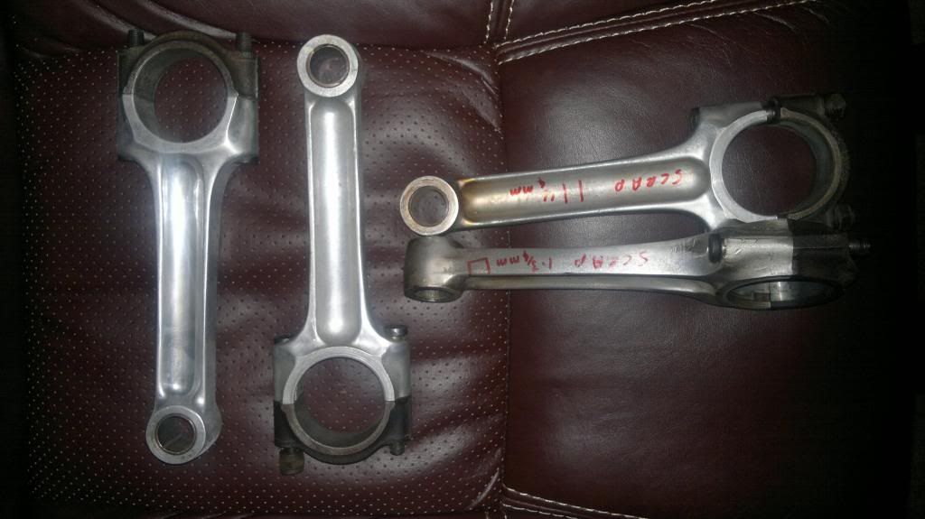

08-02-13
The two on the left were picked up at an auto jumble years ago. Very cheaply as the bloke didn't know what he had. Cunning.
The two on the right are what came out of the bike.
All four went for crack testing at an aerospace firm where a mate works. The two on the left are perfect, the two on the right are scrap. Makes me wonder just how far from total self destruction that engine was!
