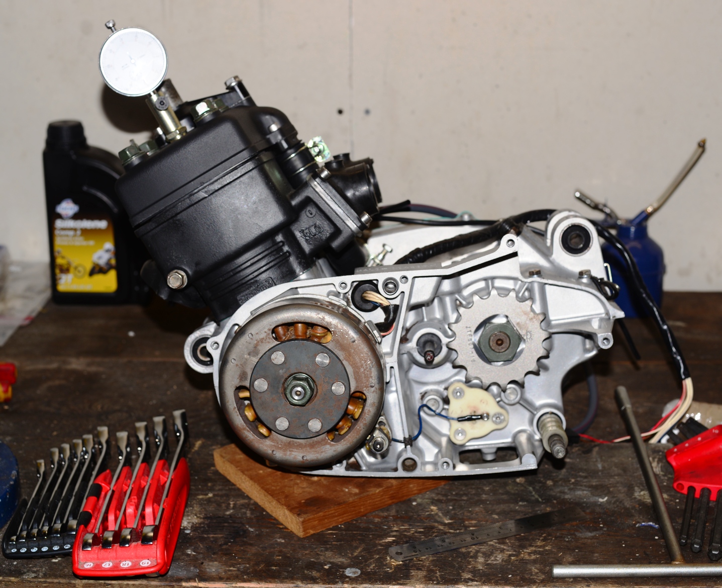

Well, I'm perilously close to being able to put the LC engine back in the frame. Ignition timing sorted (it was only about 0.03mm out when using the lines I'd scribed when disassembling the motor), just button the side cover up and the motor is done...

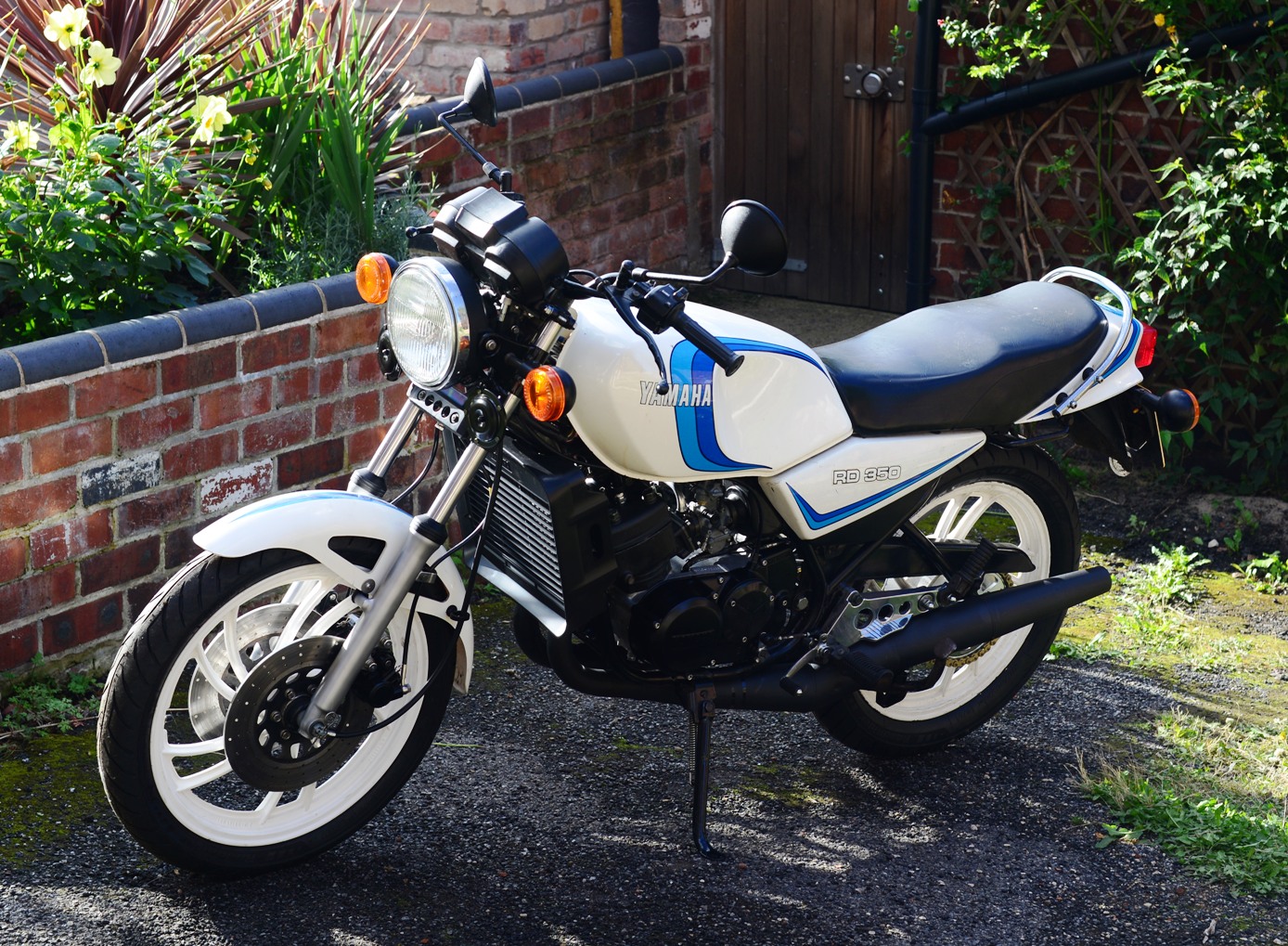

Cheers chaps. All the hassle and setbacks have been worth it. Today it went for its MoT and passed with no advisories, so Graham is a happy (and slightly smug) boy. But as the only V5C (registration document) I have for it was transcribed by mediaeval monks onto parchment, taxing it might yet prove to be a challenge...
But it lives, and on the ride to the test centre it felt better than any 40 year old bike has a right to feel. The suspension felt almost modern and the brakes were far better than I expected them to be. And it was great to look in the mirrors and see a blue haze of two-stroke smoke following me... :smt003

That looks really nice, the white wheels set it off very well!
