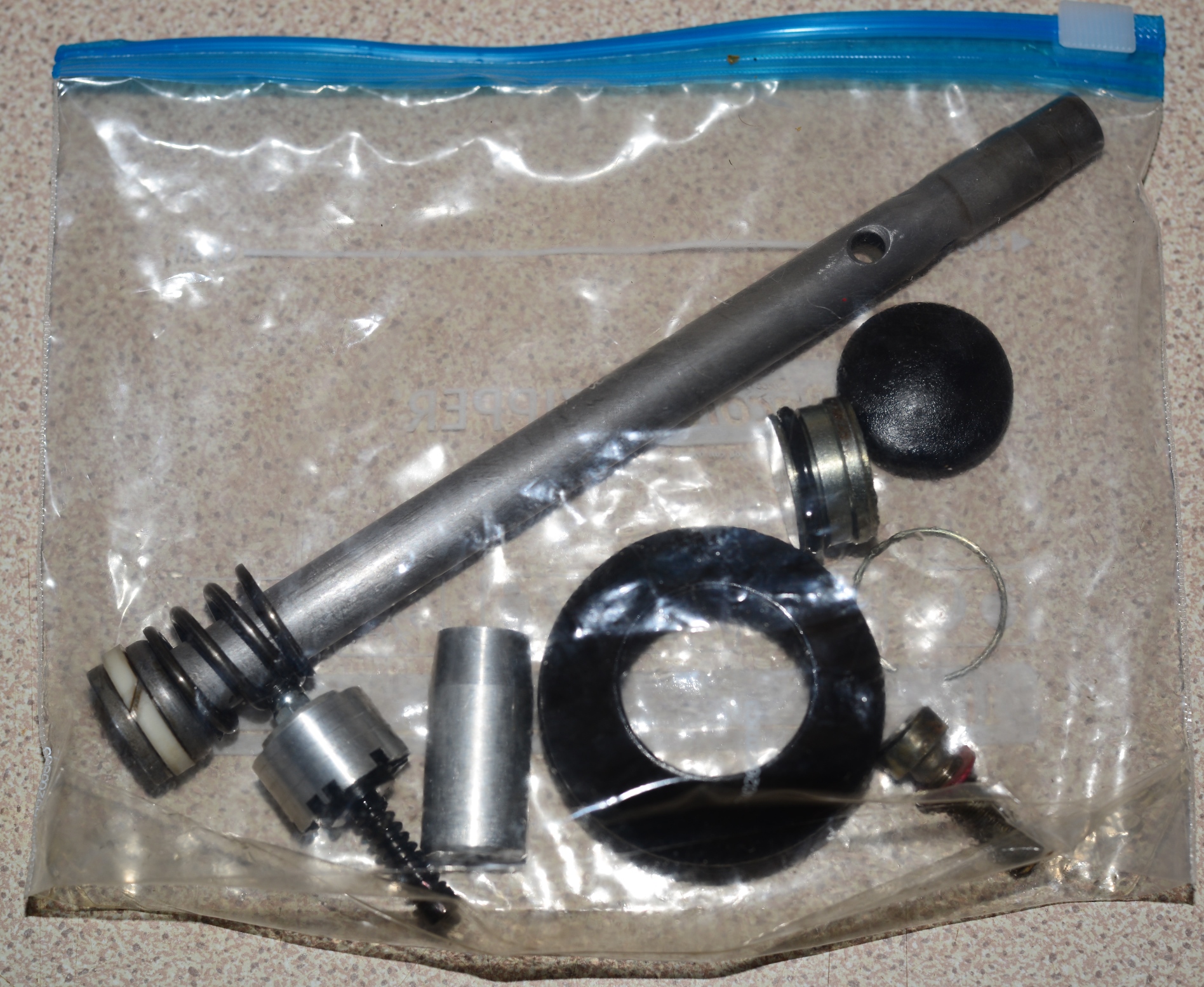

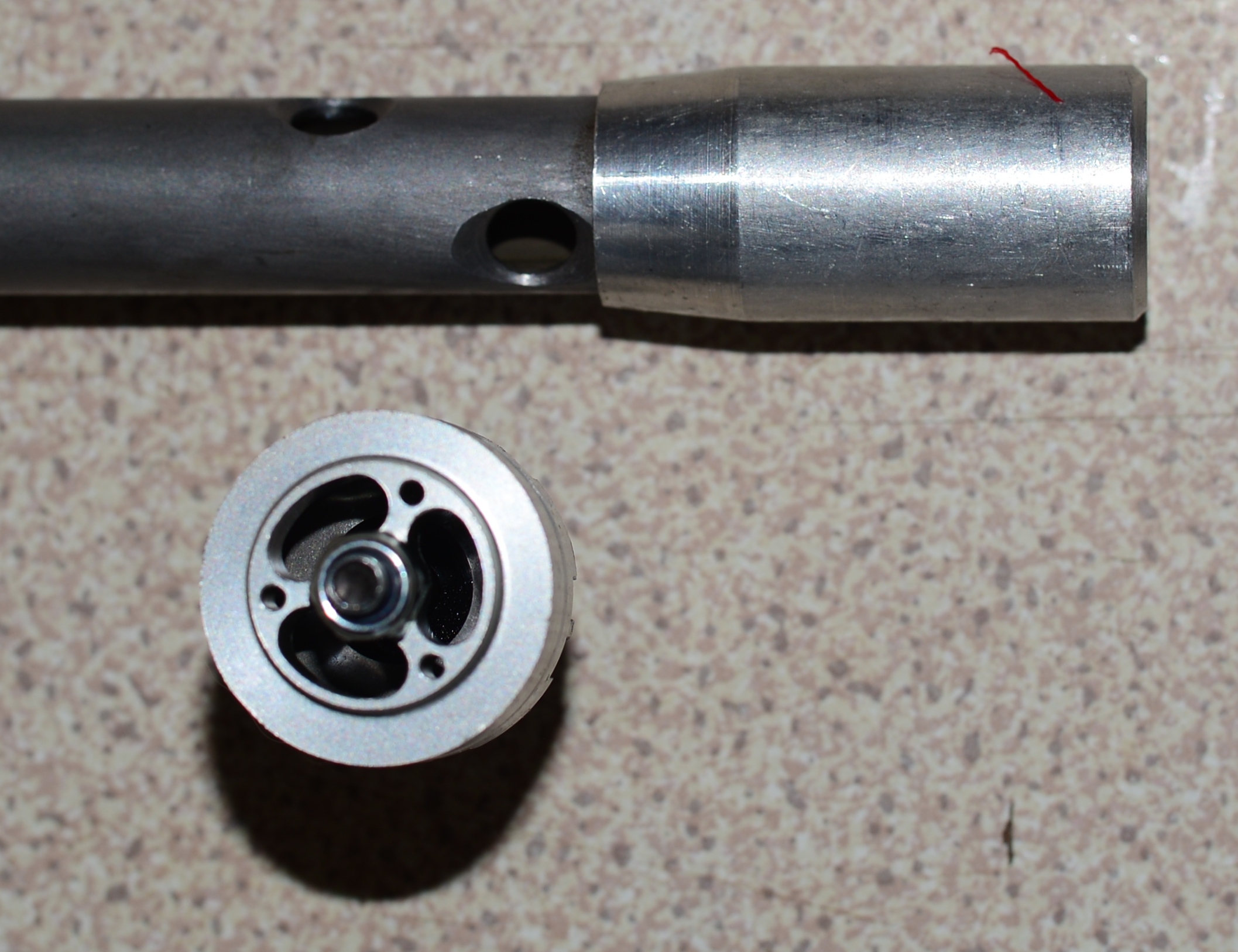

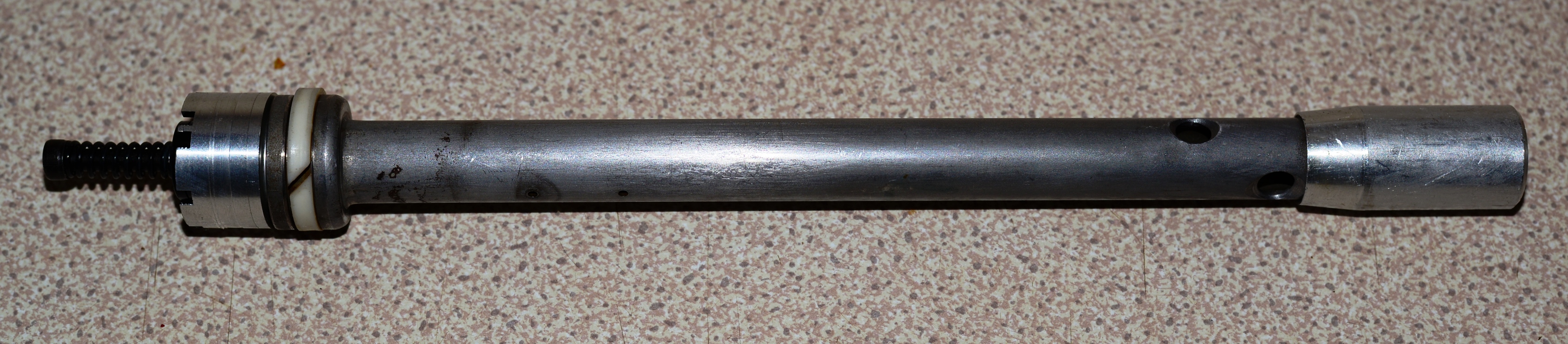

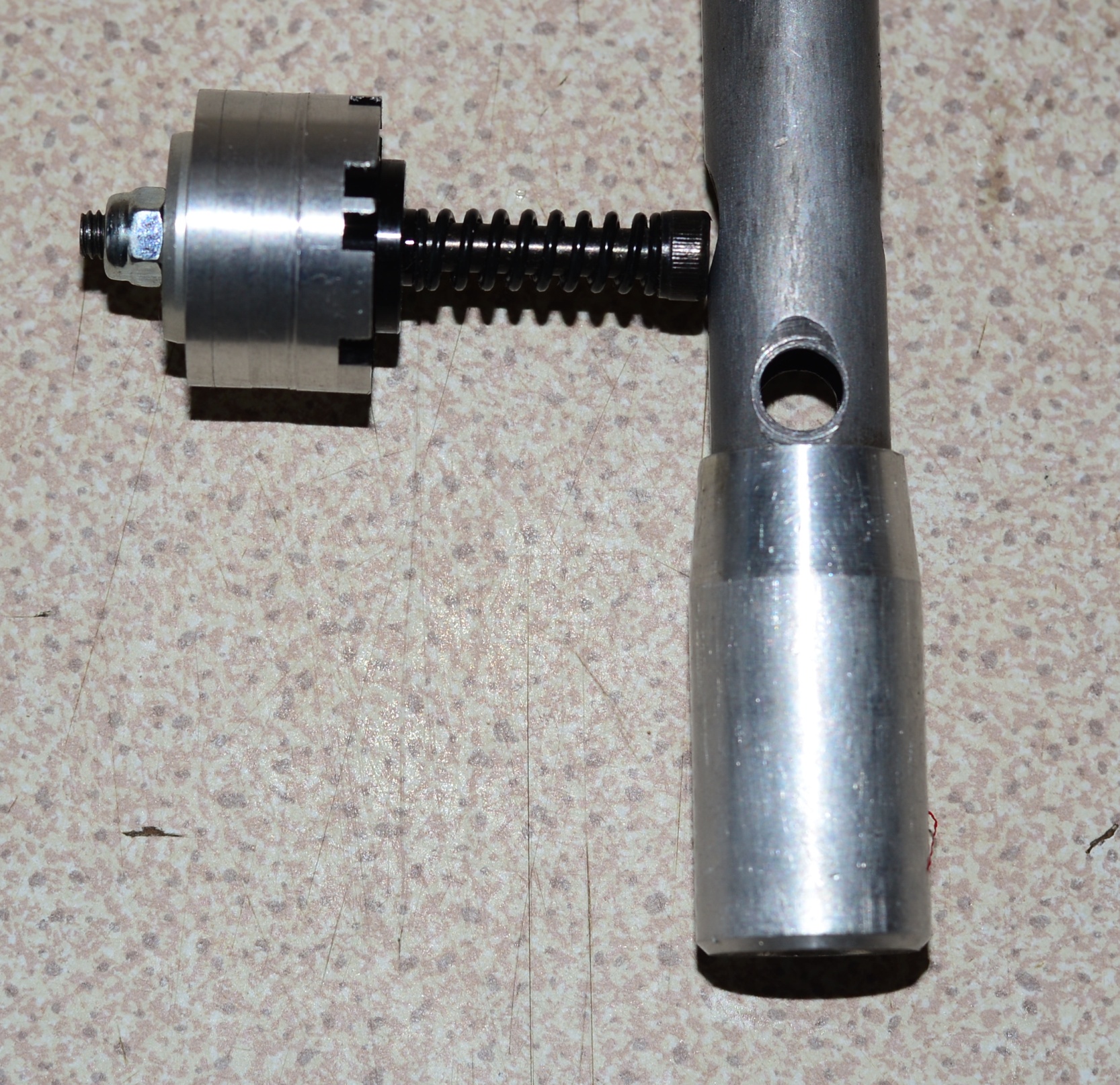

For a few days the focus has shifted from the motor to the suspension, and particularly the forks. I'm waiting for some dry weather so I can convert the shed into a spray booth without re-spraying the Falco and the Duke a fetching shade of satin black...
A few weeks back I had a very illuminating back and forth conversation with Jon Slenzak of S1 Suspension in Brackley and he supplied me with a set of replacement YSS fork springs (the OE LC ones are very soft and 40 years of use haven't helped) and a set of YSS cartridge emulators for the forks. The LC forks are actually pretty terrible, to be honest - it's just that a) we didn't really notice back in the day and b) the rest of the bike was just as wibbly-wobbly so it was all much of a muchness. But viewed from a 21st century standpoint you can only ask WTF where the designers thinking?
The LC forks have incredibly tiny 32mm stanchions. That wouldn't even pass muster on a mountain bike these days. The fork spindle is only 10mm diameter. The forks do not have replaceable bushes. The only bushing is part of the fork leg. If the bushing wears , you replace the fork leg! Thankfully the bushings are OK on mine and there is no obvious wear on the stanchions or sliders. The forks are also crude in operation - they're damper rod forks and as such are always going to be a major compromise. In normal use and under braking they're very soft and dive like a Premiership footballer. Hit a sharp square-edged bump and they lock up. It's just how damper rod forks are.
The cartridge emulators attempt to try and fix some of the worst failings of damper rod forks. Damper rod forks rely on a couple of holes drilled in the damper rod for their compression damping. The YSS valves provide a system that works in the same fashion as cartridge forks. The little silver thingy with a bolt and spring sticking out in the pics below now takes over compression damping duties. I drilled two more holes of the same size as the existing holes in the damper rods, thereby doubling the effective area for oil passage. The cross sectional area of all the drilled holes exceeds that of the damper rod's internal area and so they no longer offer any meaningful damping - that's now all taken care of by the YSS valves/emulators.
Here are some pics to illustrate:
The little silver thing on the right is the YSS valve. The end with the spring and bolt sits inside the fork spring and the stepped end sits inside the flared end of the damper rod. The bottom of the damper rod is shown in this photo, along with the original drillings - two holes, spaced apart at 180 degrees. The degree of damping is controlled by how much the bolt is screwed in, which in turn changes the spring resistance to the oil trying to get through the valve.
This shows the business end of the valve; the side of the valve that faces oil being forced through the valve on the compression stroke. This pic also show the secondary holes that I drilled in the damper rod, around 15-20mm further up the rod and offset to the original ones by 90 degrees. The aluminium sleeve sits between the bottom of the stanchion and the fork outer. This next photo shows the components as they would be mounted inside the fork stanchion.
The bottom of the fork spring sits on top of the valve/emulator with all those components held in place inside the stanchion. The springs from YSS are intended to be direct drop-in replacements for OE Yamaha, so as I was adding at least 20mm extra preload in the shape of the valves, I had to shorten the springs by that amount to bring them back in spec. Thankfully I have a horizontal bandsaw and didn't need to resort to the angle grinder...
It may all sound rather complicated, but damper rod forks are really very simple to dismantle compared to cartridge forks (especially upside down cartridge forks). All the internal gubbins (springs excepted) can fit inside a medium size freezer ziplock bag...
Tomorrow (all being well) the forks can get reunited with the rest of the bike and the rolling chassis will be mobile again, instead of being propped up on beer crates..

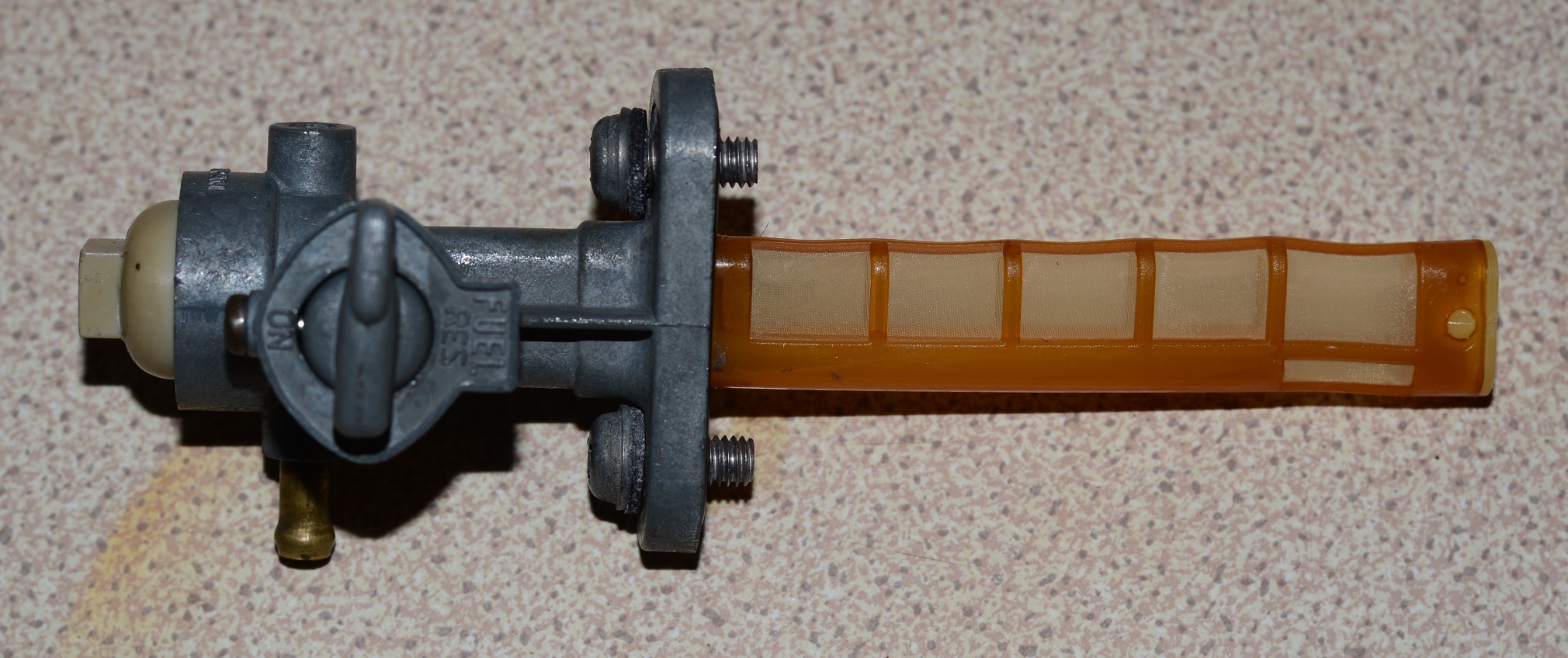

Today has been a 350LC petrol tank kind of day ...
As part of preparing the soon to be 40 year old LC for the rigours of modern life, I decided that it would need to have the (steel) petrol tank internally coated with an ethanol resistant film, and I knew the petrol tap would also need attention. It was the orange-brown treacle that dripped from the fuel hoses that alerted me...
So the tank came back to Sheffield with me, was divested of its fuel tap and filler cap and was taken to RTT Moto in Hoyland (south of Barnsley, north of Sheffield/Rotherham). This place is what motorcycle shops looked like when I were a lad. They don't sell bikes, they just sell bike bits and provide services (like tank sealing). It really was like stepping back 40 or 50 years in time. The tank will get all the old gummy petrol residue removed, be treated for any rust that's present and then sealed internally. Should take about a week.
I did seriously think about sending the tank off to the guys Paul (fatboy) mentioned, but agonised about sending the tank by courier or post, and the possibility for damage or loss involved. Then when speaking to a guy I know who lives in Sheffield and has rebuilt literally hundreds of LCs, he recommended RTT Moto. As soon as I stepped in the shop I knew it was the right choice. No flash, no high pressure sales, just someone who knew his stuff and could do what he said he would. He's only been doing it for 40 years...

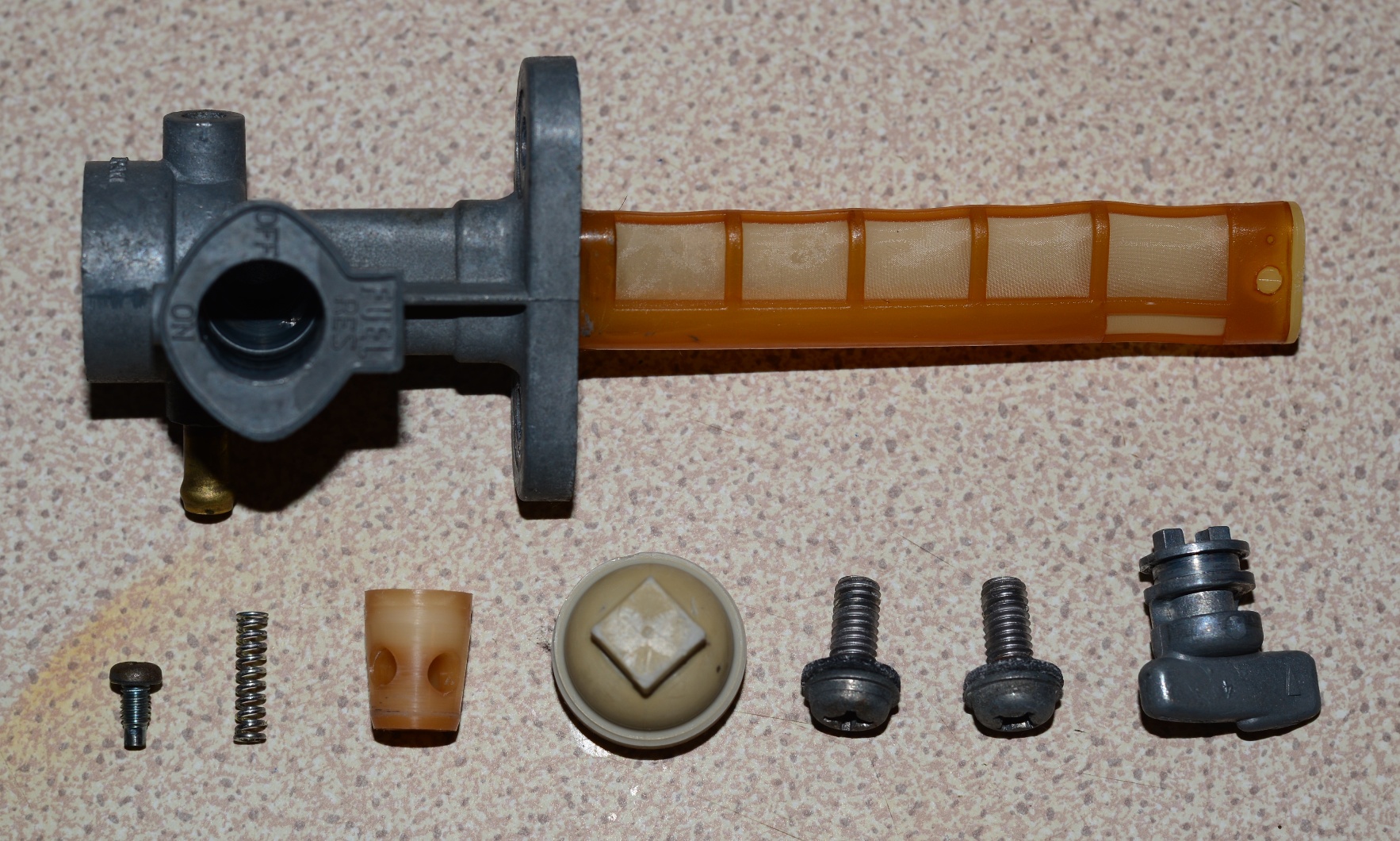

When I got home I set about the fuel tap. This was set permanently in the on position. There was no way on earth that you could turn it to any other position. So it clearly needed some high frequency vibration while immersed in fluid to make it straighten up and fly right. I dumped it in the ultrasonic tank for about an hour and then had another look.
When I came back to it I could now unscrew the plastic bowl and the fuel lever would now move. After some persuasion the tap lever parted company with the body, revealing a world of gummy nastiness underneath. The tap then got doused with brake cleaner and had its teeth brushed vigorously until eventually, with a bit of persuasion from the airline, the nylon valve and spring popped out. More scrubbing with brake cleaner and toothbrush and then everything went back in the ultrasonic tank. After another 30 minutes or so, this is what all the parts looked like...
And shortly after, with new o-rings from the repair kit fitted, it was all back together in one piece.
Sorted.

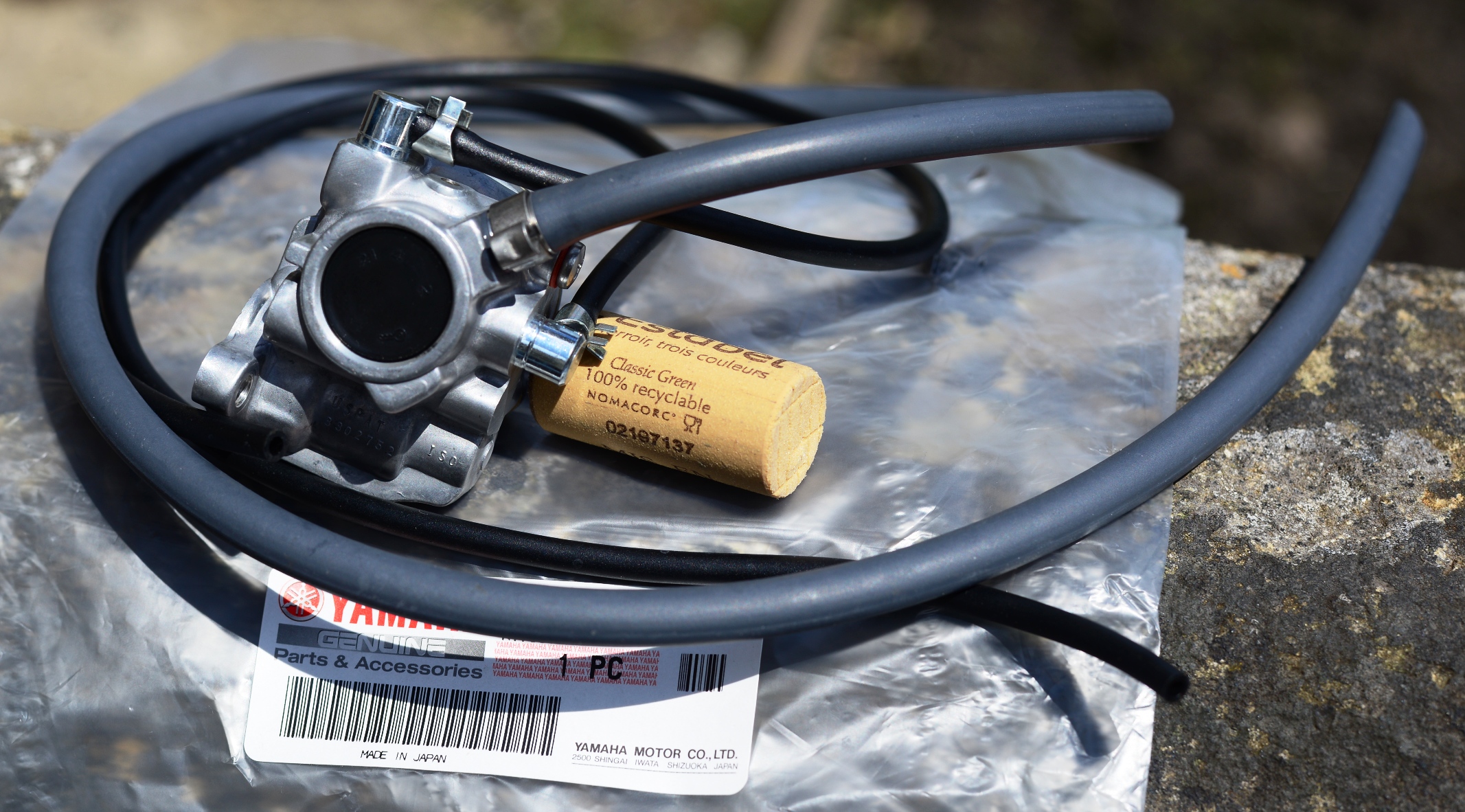

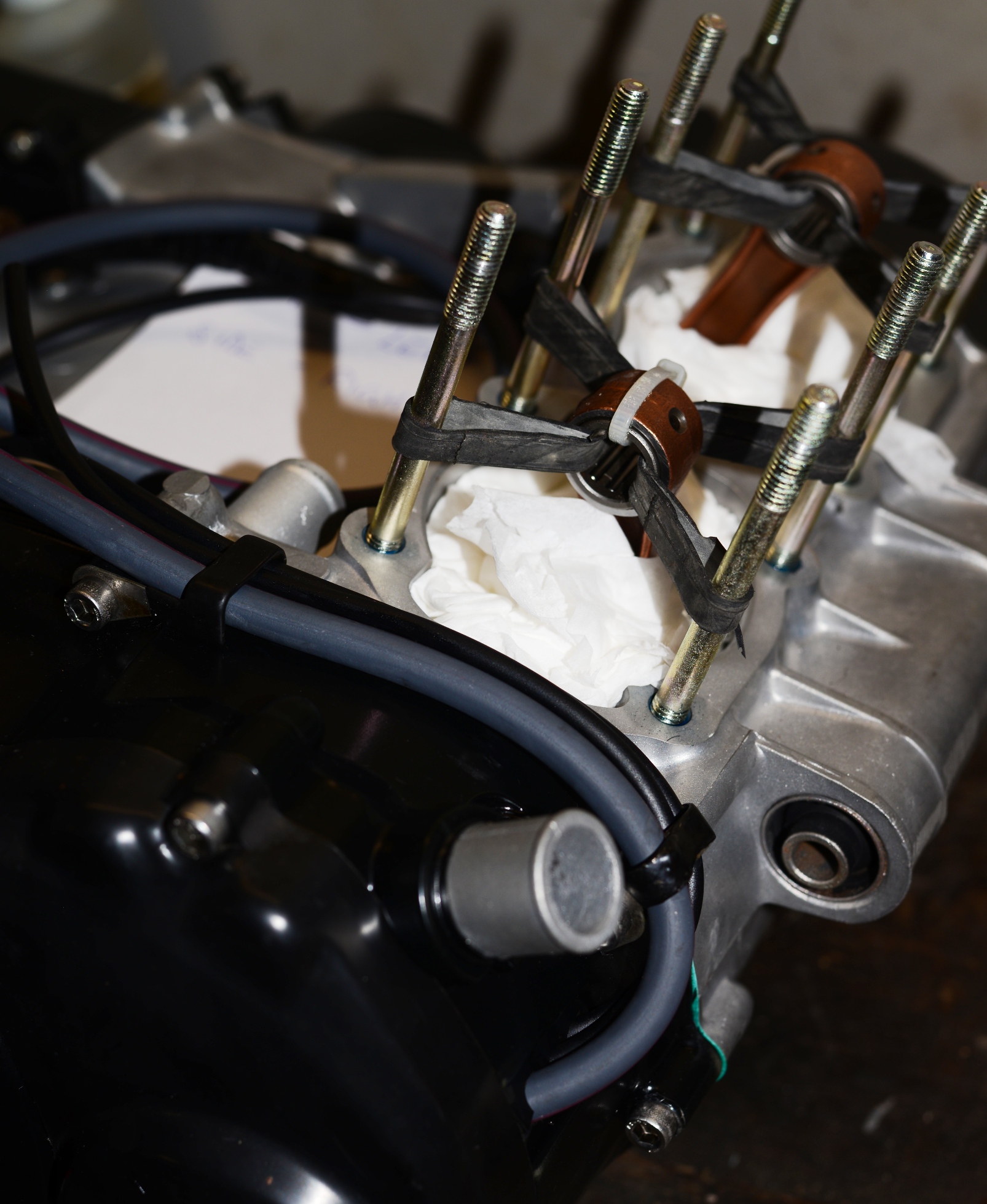

Not too much has happened on the resto front recently. The tank came back from having all the old gummy petrol removed, rust treated and neutralised and being internally coated with epoxy. It looks great but externally exactly the same as before. Which is as it should be, of course.
The dire state of the postal service delayed the return of my oil pump by a couple of weeks, but earlier this week it finally arrived back from Gary Jones, worker of miracles and king of the oil pump refurbishers. It didn't just look new, it looked better than new. I'd already ordered up new supply and delivery oil pipes (I mean, would you re-use 40 year old oil pipes?) and it was time to fit them. This photo shows the pump reclining on a passing cork, with all its pipes fitted and clamped up.
Then it was time to re-fit the pump to the motor and also to re-fit the water pump cover plate, complete with shiny new plating and the drain hole that Yamaha should have fitted all those years ago.
After that it all got buttoned up and the oil pipes were routed behind the guides that Yamaha so thoughtfully provided. Not a massive amount of work, but very satisfing to tick another task off the list.
