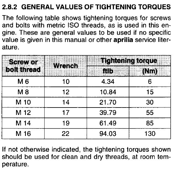

#44 Post by Falcopops » Sun Jan 05, 2020 8:51 pm
This is a job I'll getting round to soonish, but any ideas on the torque for the caliper clap bolts?
What did you use Mango? and why?
Re: Brembo caliper seal kits
#45 Post by mangocrazy » Sun Jan 05, 2020 10:26 pm
I couldn't find any published torque values for clamping the two halves of the caliper together, so I figured that it would probably be OK to use torque values for a generic M8 bolt into aluminium, which is 15 Nm. This is the bit of the manual:
General torque values.JPG (99.89 KiB) Viewed 15652 times
