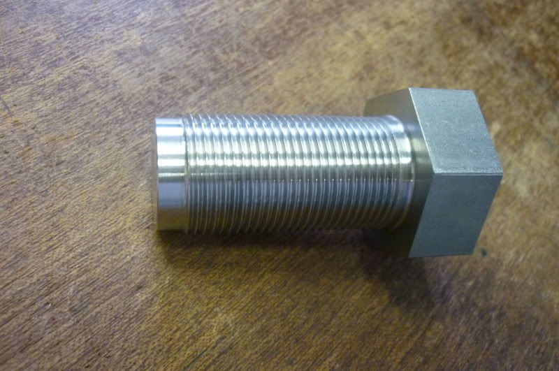

#17 Post by szrdave » Thu Jul 21, 2011 9:37 pm
Got my flywheel removal tool today, looks pretty good!

#18 Post by Aladinsaneuk » Thu Jul 21, 2011 10:49 pm
ooooooo :)
#19 Post by Falcopops » Thu Jul 21, 2011 11:58 pm
Aladinsaneuk wrote:ooooooo :)
Thank god it wasn't anodized Titanium, nursie might have had an accident
#20 Post by mangocrazy » Fri Jul 22, 2011 10:03 pm
szrdave wrote:Got my flywheel removal tool today, looks pretty good!
That does look exceedingly manly...
wouldn't like
#21 Post by flatlander » Fri Jul 22, 2011 11:16 pm
to see the nuts on that one :smt003
