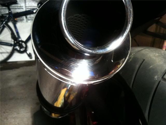

#25 Post by rick » Sun Jun 06, 2010 9:17 pm
Done one of the exhausts... basically grit 600, 1200 then 1500 and plenty of autosol... and repeated... need to buff even more but can't be arsed now! May need to buy a buffing wheel and some more polishing compounds but we'll see. There are still a few little dots to sand out and I'll sort that out again.
Here is before and after... easier than I thought it'd be :)
"There is a grey blur, and a green blur. I try to stay on the grey one..." - Joey Dunlop. Isle of Man TT Champion.
#26 Post by MartDude » Sun Jun 06, 2010 9:25 pm
How long did that take you?
rick
Posts: 512
Joined: Thu Mar 18, 2010 1:12 pm
Location: Auckland, NZ
#27 Post by rick » Sun Jun 06, 2010 9:40 pm
Couple of hours with lots of distractions, so I reckon an hour solid... she still needs a buff but it was easier than I thought :)
