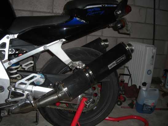

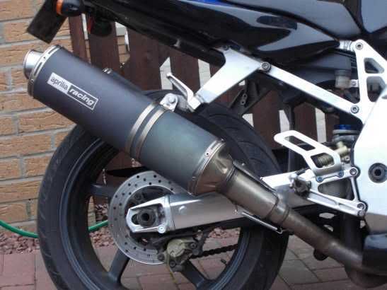

sthomson1 wrote:RSV exhaust cans do NOT fit a falco ....
no where near. Brackets about 2 inches out (easily moved), but ... the connection between can and exhaust is completely different...different bore size .. the inner bore of the RSV can is the same size as the outer bore on the falco exhaust.
anyone got standard falco cans for sale ... need shipped to Glasgow though !! ??

no, the rsv can is alot bigger than the ART can.
If i really really wanted to use the rsv cans, im sure i could make them fit with some cutting and welding...but..the easiest and simplest way would be to sell the rsv cans and buy a pair of Falco standard cans ... which is what im going to do :-)

Ive had a good look at these cans now.
Ill be able to fit them if i could get a hold of some pipe with 45mm inside diameter and 49-50mm outside diameter.
Ill cut down the cans, about 2 inches, slide in the pipe cutting, weld, leave 1 inch pipe showing, which will then slide snuggly onto the exhaust .. sorted
so far, ive anly been able to find 48mm inside/51mm outside pipe.
The cans hanger is held on with one rivet underneath, if i grind this off, i should be able to slide the hanger into the correct position.
Once ive got them mounted, ill post photos.

#21 Post by sthomson1 » Sat Oct 11, 2008 7:25 pm
almost mounted.
Just need to weld in sleeve and spring mount hook.
looks pretty good on the black falco, alot quieter than the race cans, but, still growls :-)

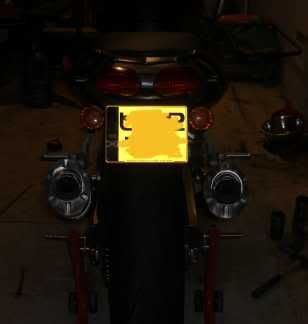

#26 Post by sthomson1 » Tue Oct 14, 2008 4:06 pm
huge difference with noise ... slight growl from exhaust and huge growl from induction :-)
Makes the bike far more pleasant to ride, for me, without the noisy exhausts ... i also thinks it looks better with these cans.
I ended up cutting off 4 inches from the cans, and then welding in a sleeve, and new spring tags. The sleeve was made from a chrome exhaust trim (45mm inside diameter). the 90mm chrome springs are from a motocross shop.
