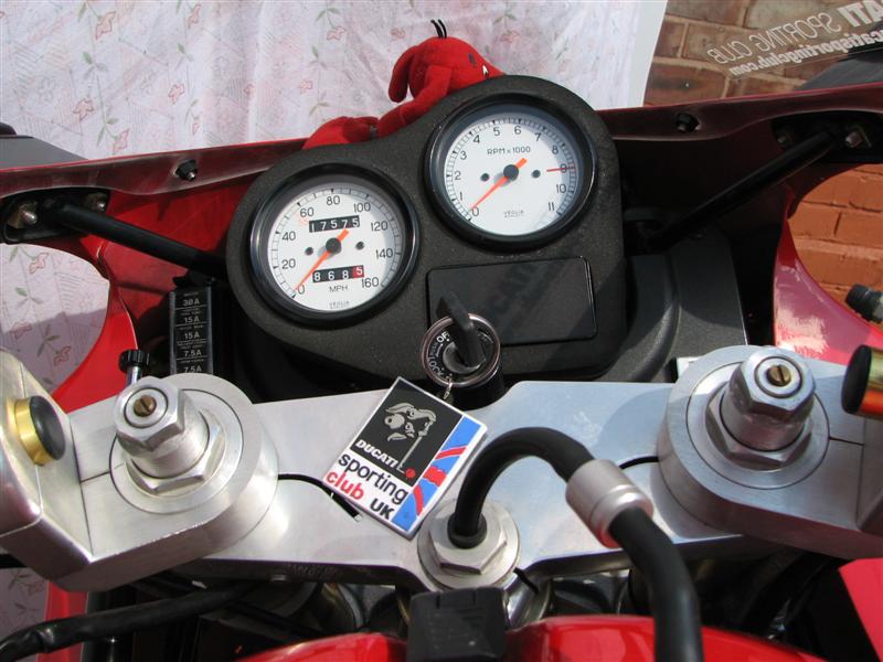

I've gone and bought an Aprilia Shiver top yolk for my attempt at 'higher Rise' but its so damn cold in the garage (and I'm so unmotivated currently) that Ive got no further with anything other than draining the tank to low level, stabiliser, run and then charge and remove battery...
As an aside here is a bar mod I did to my old Ducati, that I love but I got a good slating for on the Duc forums: The massive clamps came from M&P 50mm dia. I think I got their last pair a couple of years ago in a sale and not seen them since. I had to drop the yolks a shocking amount and yet it didnt seem to upset the handling badly at all. I got slated for cutting a standard wide bar middle section out, apparently - lack of movement resistance I guess but at that time it was a beautiful position for me - I'll try and find a full width photo - Ta Ta.
I fully admit to only using mine at service time and wonder if its up to the task.

Very impressed with your Ducati mod; a very interesting variation on the myriad ways that exist to achieve a more comfortable riding position. I've always found Ducati owners are more resistant to modifications than Aprilia owners. Not sure why that is...
I spoke to Griff about using the idle adjuster instead of the fast idle/choke and he seemed perfectly OK about it. I think that most folk never use the idle adjuster and so it gets seized up and claggy (technical term). I'll give it a good going over with ACF50 and lithium grease to make sure its action is as smooth and glitch-free as possible.
Venhill have requested that I send them the other Falco throttle cable, as they don't have any details for Falco throttle cables on file. Typically I haven't been able to get back to where the cables are for over a week, but should be able to sort that out soon. In the interim I've been buying braided stainless hose and fittings, as I'll need to make up new brake and clutch lines to cater for the extra height of the bars. I'm hopeful this time of being able to avoid puncture wounds from the stainless braid. Last time I did the job I think I set a world record for profanity...

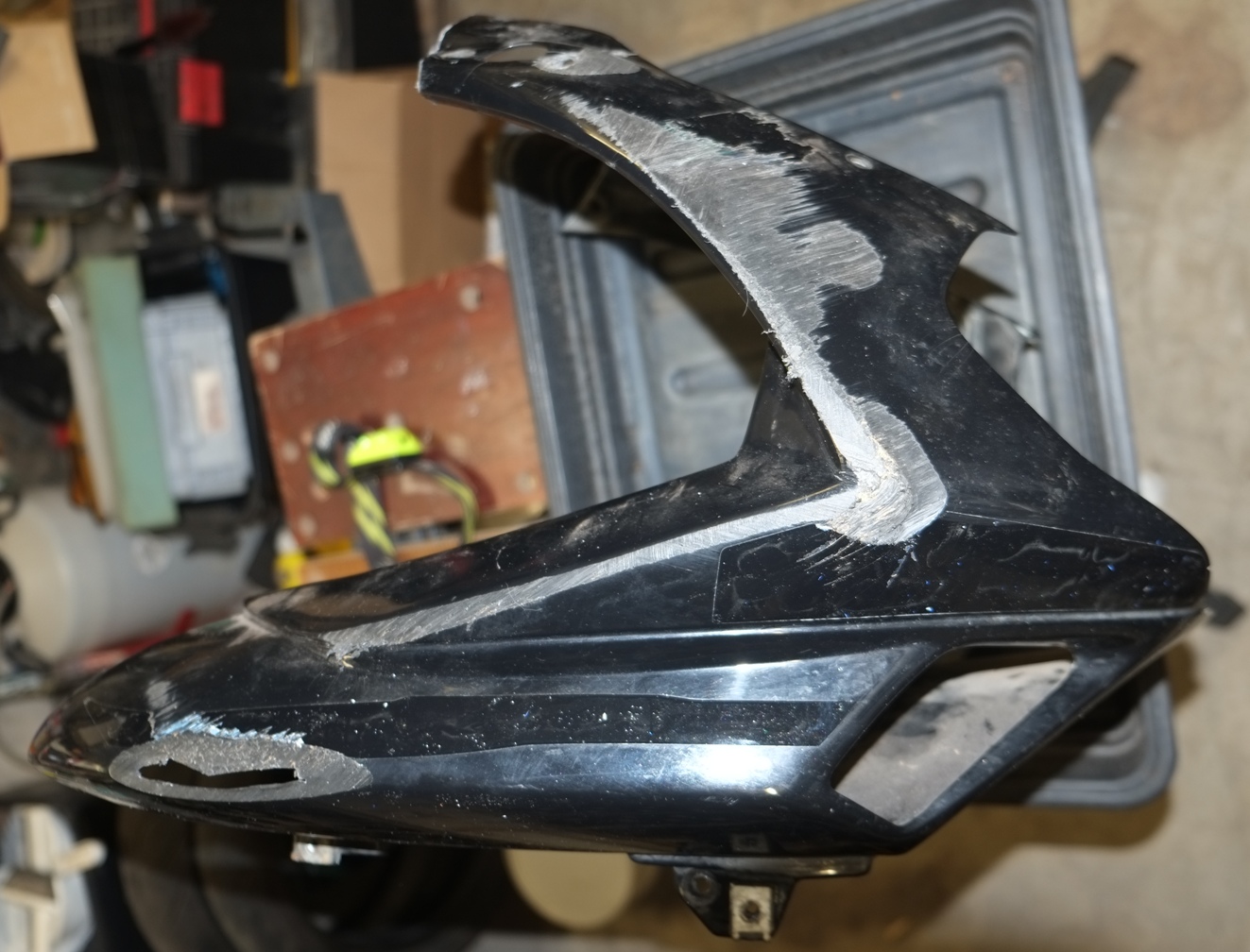

Minor update (no photos, I'm afraid). I've finally finished hacking Keith's damaged old top fairing about, and bolted the new screen I ordered off Skidmarx up to the top fairing so I could see where I needed to cut it down to suit. I covered the target cut area in masking tape and then did my best freehand drawing guesswork of where I needed to cut the screen down. Then it was a case of taking my courage in both hands and getting stuck in with the Dremel, It didn't take too long, and didn't look half bad once I'd finished it. Screen shape is a bit like the RS660 Tuono if you don't look too closely...
Next step was to take the top fairing and screen to Pro Kustom in Wath upon Dearne for Arnie to fill in all the missing bits (Keith had sent the bike down the Cadwell tarmac on one side) and then bring it back to recognisable Falco shape. Then it will get primed and finally re-painted in Flamingo Red/Anthracite to match the rest of the bike, when he can fit it in around his other commitments (he's a very busy man...) Arnie will also tidy up my rather agricultural efforts with the screen, bless him.
So it's slowly taking shape...

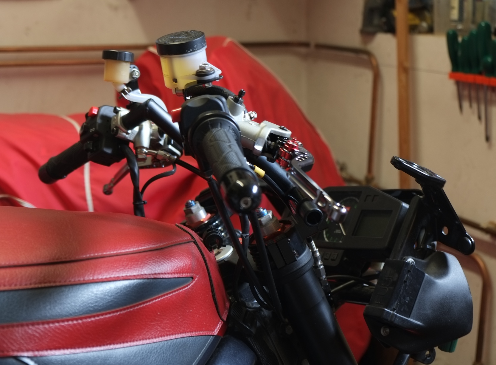

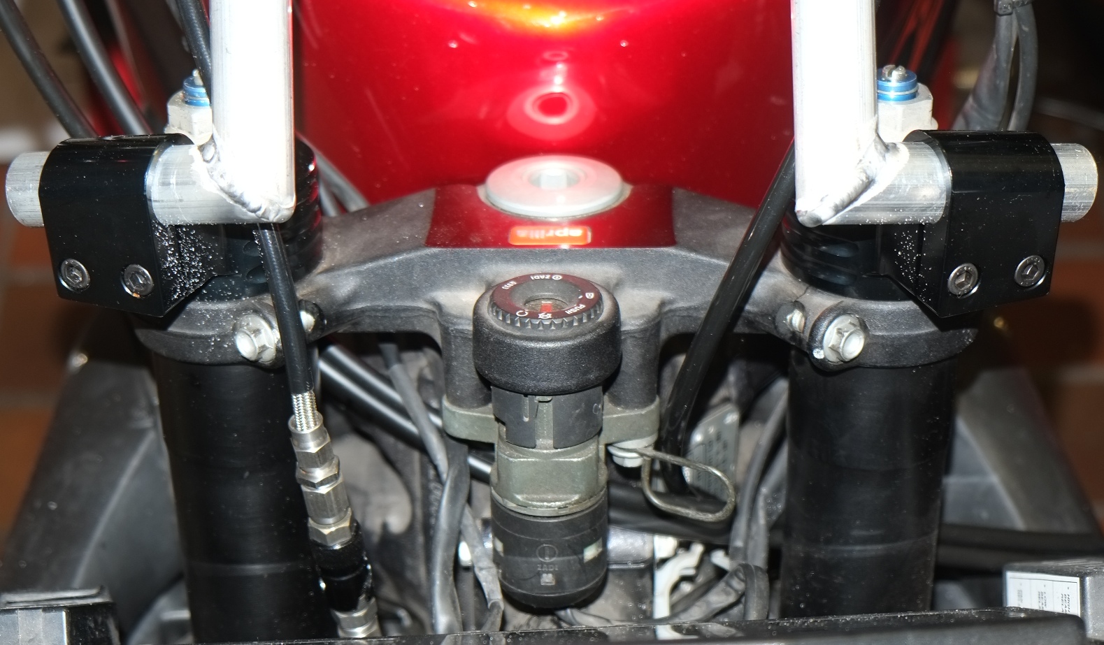

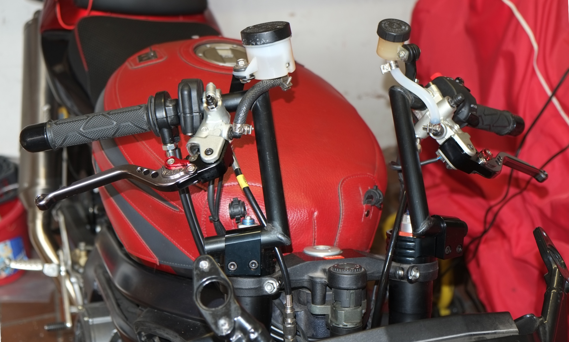

I thought it was about time to add some pictures to this thread. Exhibit A is the decidedly secondhand top fairing that Arnie at Pro Kustom has to work with. You might be able to make out where I've hacked the top part of the fairing about in this photo. It's as close to the mirror mounts as I could get - I wasn't prepared to put myself through alternative mirror hell, so the OE mirror mounts have to stay. They also are the main support for the top fairing, so they doubly have to stay.
The bars I've settled on are significantly taller than the CAD diagram I posted earlier. They have to be to clear the fairing even in its cut down state. They're made from 7/8" 6063-T6/6082-T6 tubing with a wall thickness of 3.2 mm (10 swg). In the raw aluminium finish they do make the bike look a bit like a Raleigh Chopper on steroids, but I'm hoping that when they're anodised black they won't be quite so in yer face...

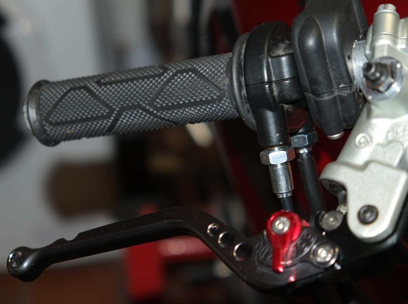

I've had to make up all new brake and clutch lines. The clutch line has been made up from scratch and the brake line uses the T-piece and lines to the calipers from an old brake hose with a new section grafted on running from the T-piece to the master cylinder. I've also incorporated a dry-break QD coupling into the top brake line, as I had one that was unused.
I'd originally bought a pair of Gen 2 Tuono throttle cables on Nooj's recommendation but I couldn't get them to work at all. In the end I had to go to Venhill Engineering and get them to make me up a custom set. I needed them 65mm longer than OE Falco, and with a straight exit from the twistgrip rather than the standard 45 (ish) degree exit of the standard cables. I fitted them today and I'm relieved to say that they fit perfectly and work really well. Phew... The Venhill cables have their 'featherlight' inners and liner, and they really are as smooth and friction-free as the name suggests. Here are the straight exits:
I'm also in the middle of making up new brackets for the brake and clutch remote reservoir and drilling and tapping the bars to accept mounting screws for same. Just about everything that could be altered has had to be altered or made/bought afresh. But I've started, so I will see it to the bitter end...

WOW, those are seriously long bars, I'm wondering if a cross-brace near the top might be needed?
Funny, I was only thinking about extending fluid hoses instead of buying new and I think you have done that here? I think Goodridge & Venhill do parts?

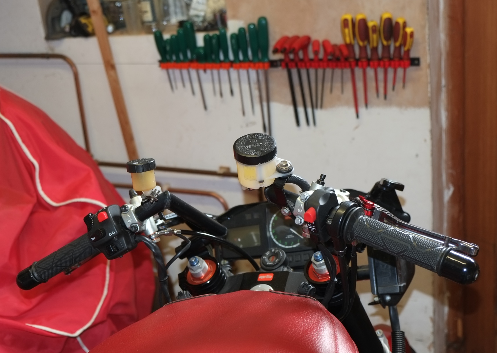

I've been away in France for nearly 5 weeks, and hoped that Arnie would have had the top fairing ready for when I got back. Unfortunately the fairing is still only in 'mid-repair' (Arnie's term). The bars have been anodised black since I last posted and (to my eyes at least) they don't look quite as gawky as they did in plain aluminium. You may think otherwise, of course...
This is probably the 'worst' angle, but will be mainly covered by the fairing when re-fitted.
Side view, showing elevation above tank and an idea of backwards rake:
And the closest I could get to a rider's view:

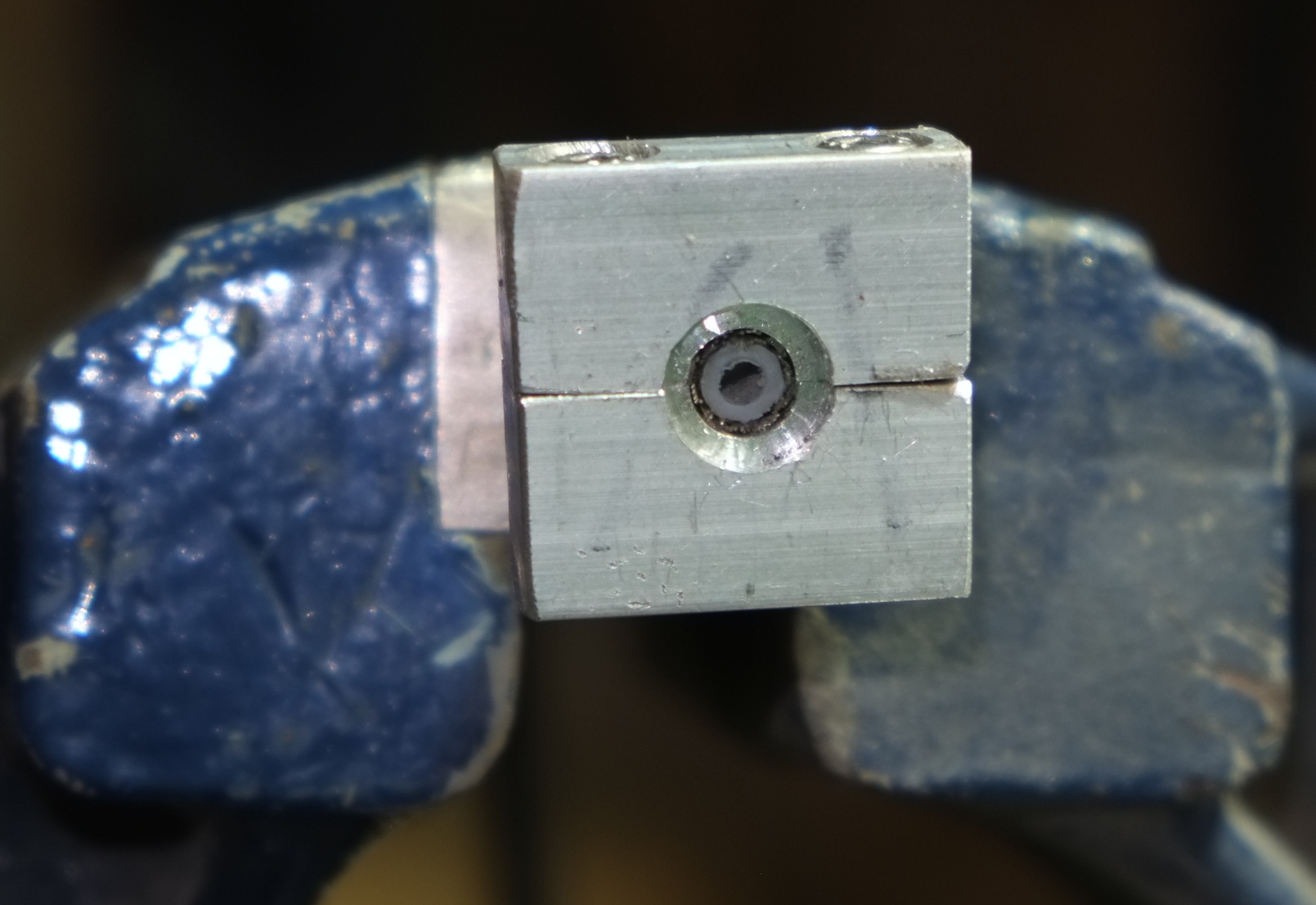

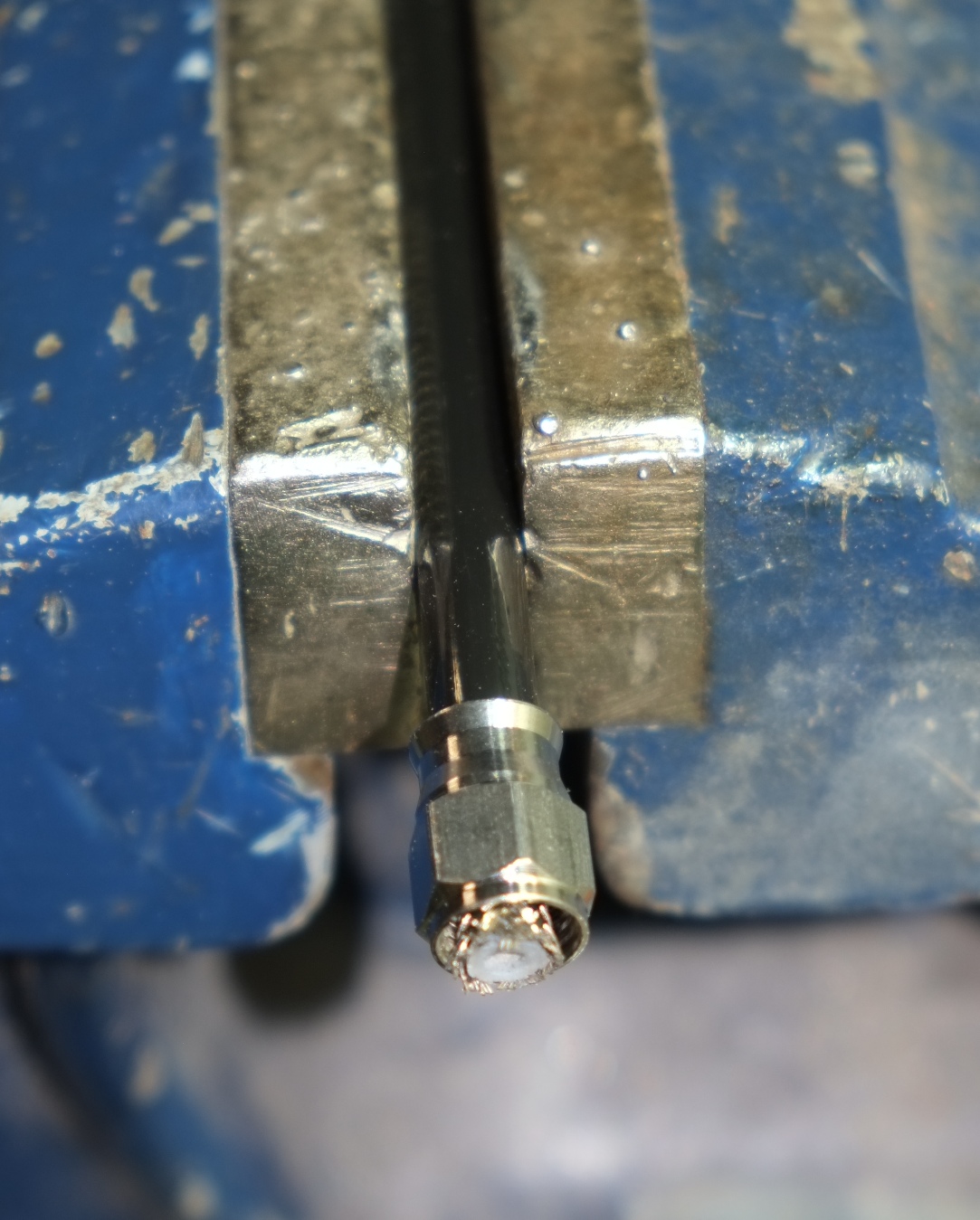

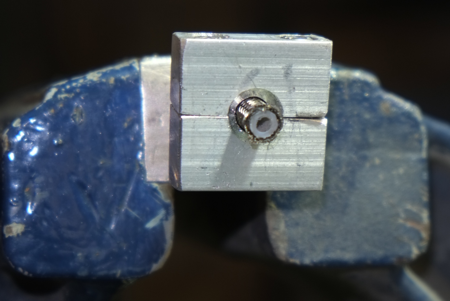

The brake line has been extended rather than being completely new and I've also incorporated a dry break fitting. The clutch line, being essentially point to point, I've made up from new components, mainly purchased from ebay. To avoid suffering multiple puncture wounds from stainless braided hose (anyone who has done this will understand), I devised a little tool to make assembling the fittings to the hose easier. Hopefully the following photos will explain:
Once the fitting is pushed over the hose, the olive can be inserted under the braid and over the teflon inner, and the fitting assembled.

That thought had occurred to me as well, but I'll need to get everything assembled and the bars in their 'final' position before I do anything like that. The length of the bars do mean that I can put a fair bit of leverage through them, so I'll need to ensure they don't move in the clamps or flex.Falco Frank wrote: ↑Fri May 20, 2022 10:43 amWOW, those are seriously long bars, I'm wondering if a cross-brace near the top might be needed?
Goodridge, Venhill and Earls do parts for home assembly, but the Venhill ones are their own design I think and I'm not sure if they're interchangeable with Goodridge/Earls types. But I found ebay as good as anything for brake hose components (once you've figured out what the parts you need are called). If you need links to anything just let me know and I'll dig them out.Falco Frank wrote: ↑Fri May 20, 2022 10:43 amFunny, I was only thinking about extending fluid hoses instead of buying new and I think you have done that here? I think Goodridge & Venhill do parts?

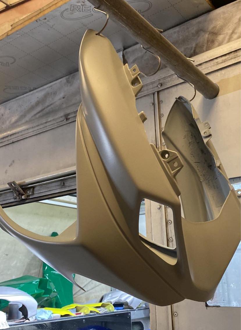

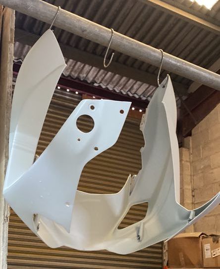

I put the replacement top Falco fairing into the paint guy for filling/sanding/priming/paint back in February. It's finally made it into primer, 6 months later. I'd like to say I'm ecstatic.
But relieved would probably be closer to the mark.
from a different angle...
and while looking through some old images, I found this. Nicely positions Falco owners in the Aprilia V2 spectrum...

The above post was dated 9th August 2022. Mid-way through January it dawned on me that I'd heard nothing from the paint guy since November and that on 21st February 2023 the paint guy would have had my Falco top fairing for a whole fucking year!
So that thought gave me the impetus to start chasing him up to get the bloody thing finished. I tried ringing him - went straight to voicemail. Then I sent him a message on his FB page - didn't hear anything. Then, completely out of the blue I get a phone call today to say that it will be going for paint next week and asking me whether I want the belly pan burgundy red or anthracite grey (I want it red, with a contrasting grey aprilia logo). So with any luck I just might have the bits back before the end of January.
Woo and hoo. Perhaps. I'll believe it when I see it.

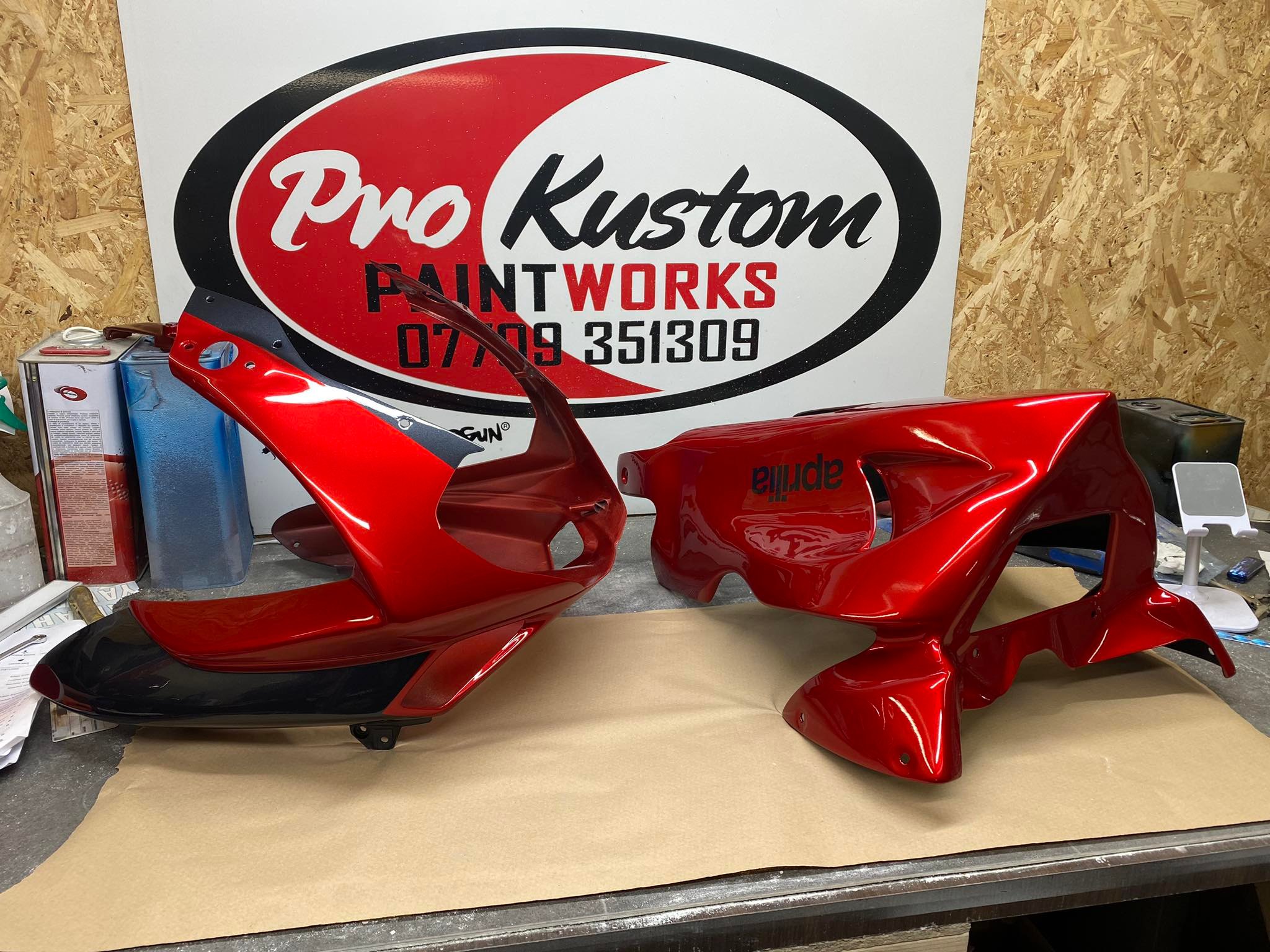

Well, glory be, Hallelujah and pass the Courvoisier...
My Falco top fairing and bellypan are ready for collection.
It had only been 11 months and 14 days since I dropped them off...
