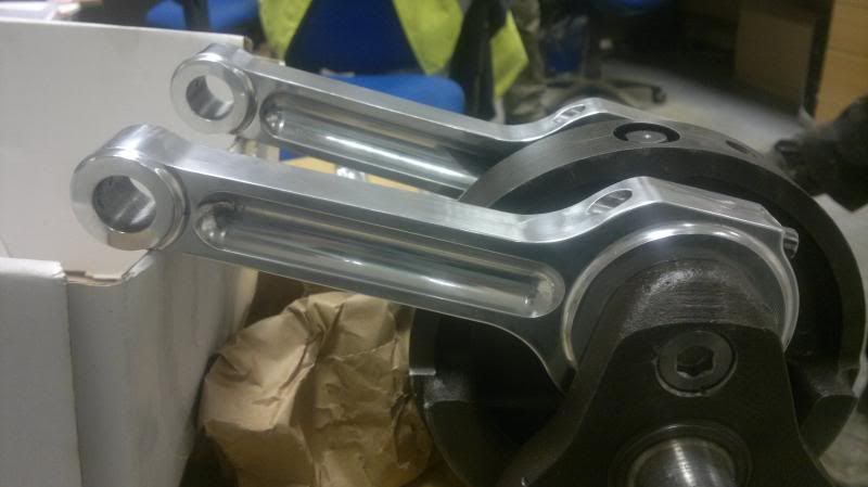

#116 Post by Willopotomas » Fri Jun 21, 2013 5:02 pm
21-06-13
New rods fitted to the crank. You have no idea how happy this makes me feel. :smt003 :smt003
During the week more parts have arrived, which means I can really get cracking with the engine build again. Once the 250 is off the bench, the 6T will be back on and the re-build will be back under way. Oh yeah! :smt003 :smt003
#117 Post by fatboy » Fri Jun 21, 2013 6:24 pm
Looking good !
Does my memory fail me or are those shiney new uns look a fair bit more substantiail than originals ?

#119 Post by Willopotomas » Fri Jun 21, 2013 11:45 pm
fatboy wrote:Does my memory fail me or are those shiney new uns look a fair bit more substantiail than originals ?
They are indeed. The same rods are used in race engines of similar design. I went for them for a couple of reasons. Firstly, they're about £60(each) cheaper than 'Carillo' rods and secondly they're used in race engines which sustain far more stresses than what I'm going to throw at it. Don't get me wrong, she'll be being ridden hard, but not as hard as a race engine. :smt004
