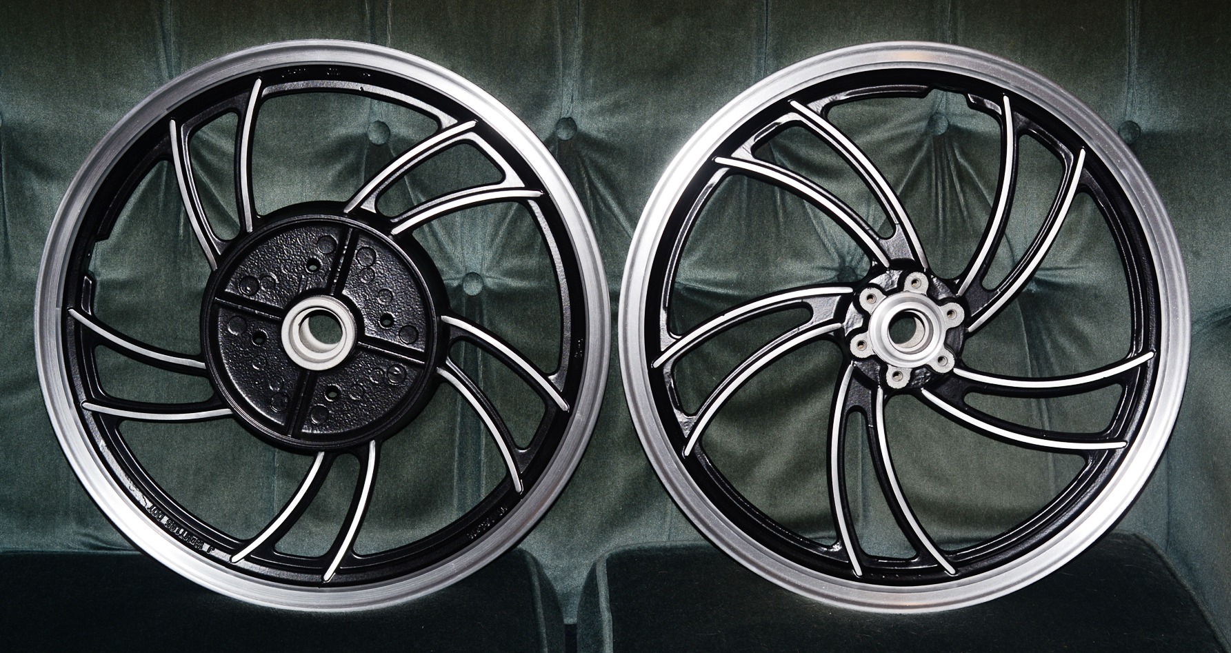

It's been quite a while since I posted up any updates. In September, with the bike just having got its MoT, we gallivanted off to the moneypit in France for a much-delayed (by Covid) break, and stayed for a whole 5 weeks. Lovely. This meant that by the time I got back autumn was well advanced in the UK (mid October). However I did manage to get about 300 running in miles racked up and the bike now feels pretty good. It's been running in so far on premix using basic mineral two stroke oil so that rings etc. bed in quickly. When it next turns a wheel it will use the injector pump with fully synth Silkolene Comp2.
Then I can start giving it some beans...
My last ride was to Buxton and back (from Sheffield) and it brought back memories of when it was my sole transport and it got used in all weathers. Even 10 degrees is a bit on the cold side for me these days, so it got washed down, returned to the shed and had its wheels taken off and all bearings, seals, circlips, discs, brake shoes etc removed. Then the bare wheels were taken first to a local firm to have them dipped and vapour blasted and then taken over to the most excellent C J Ward in Burton on Trent to be powder coated back to as close to original as possible (I'd decided that originality was the way to go). This was just before Christmas.
A few days ago (just before the snow arrived) so did these little beauties. I'm delighted with the way they've turned out.
Now it's down to fitting tyres, inner tubes (I hate those fuckers), bearings, oil seals etc, then put the wheels back on the bike.
Re: Yamaha RD350LC restoration.
Hot damn....
Those wheels look amazing.
