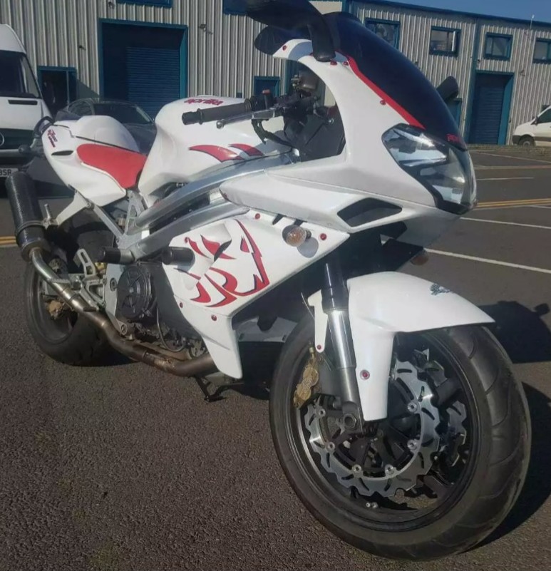

Picked up a 2001 Falco a few months ago - I fancied getting an uncommon sporty Italian V-twin on a budget and the Falco seemed to fit the bill. So here goes my Falco project.
This is it as it was when I bought it.
My Falco has good bodywork thanks to a fresh respray by the seller, but needs a bit of attention mechanically and aesthetically. It's got no service history and has had a lot of owners. There's some tatty wiring and dodgy repairs, seat lock is broken, only came with one key which is not original, unbranded carbon cans with at least one rivet missing, and it's got loads of horrible red anodised bolts and carbon-effect stickers. It does run and did come with an MOT, but given the above I want to give it a good going over before even riding it.

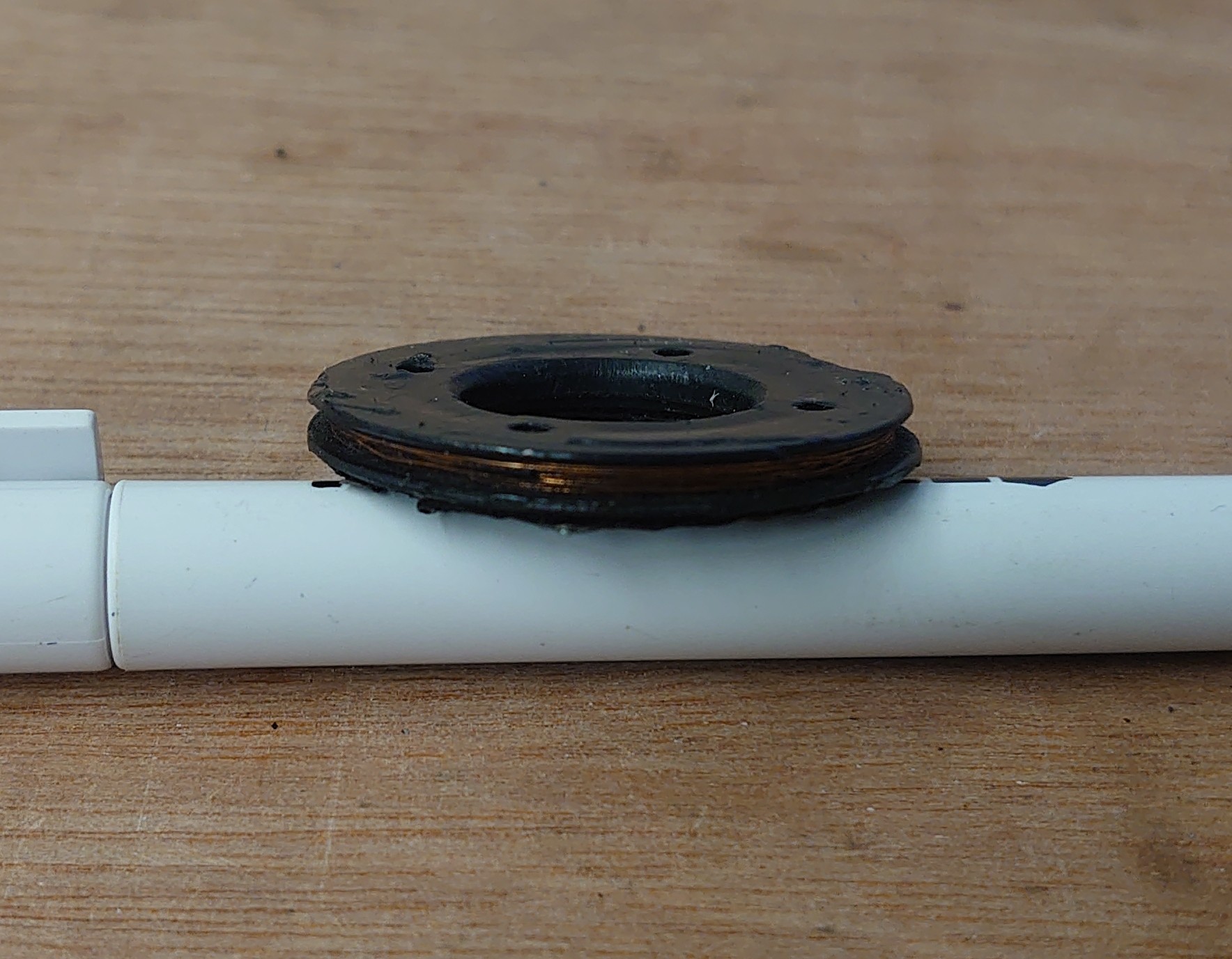

Later on I discovered a plastic disc attached to the top of the ignition barrel with a coil of copper wire inside it. Maybe there was some kind of aftermarket immobiliser fitted to the bike at some point? Anyhow, the wires were not connected to anything and the disc peeled off easily so in the bin it goes. Turns out the disc was actually obstructing the key slightly, especially when using the steering lock, so that works better now.

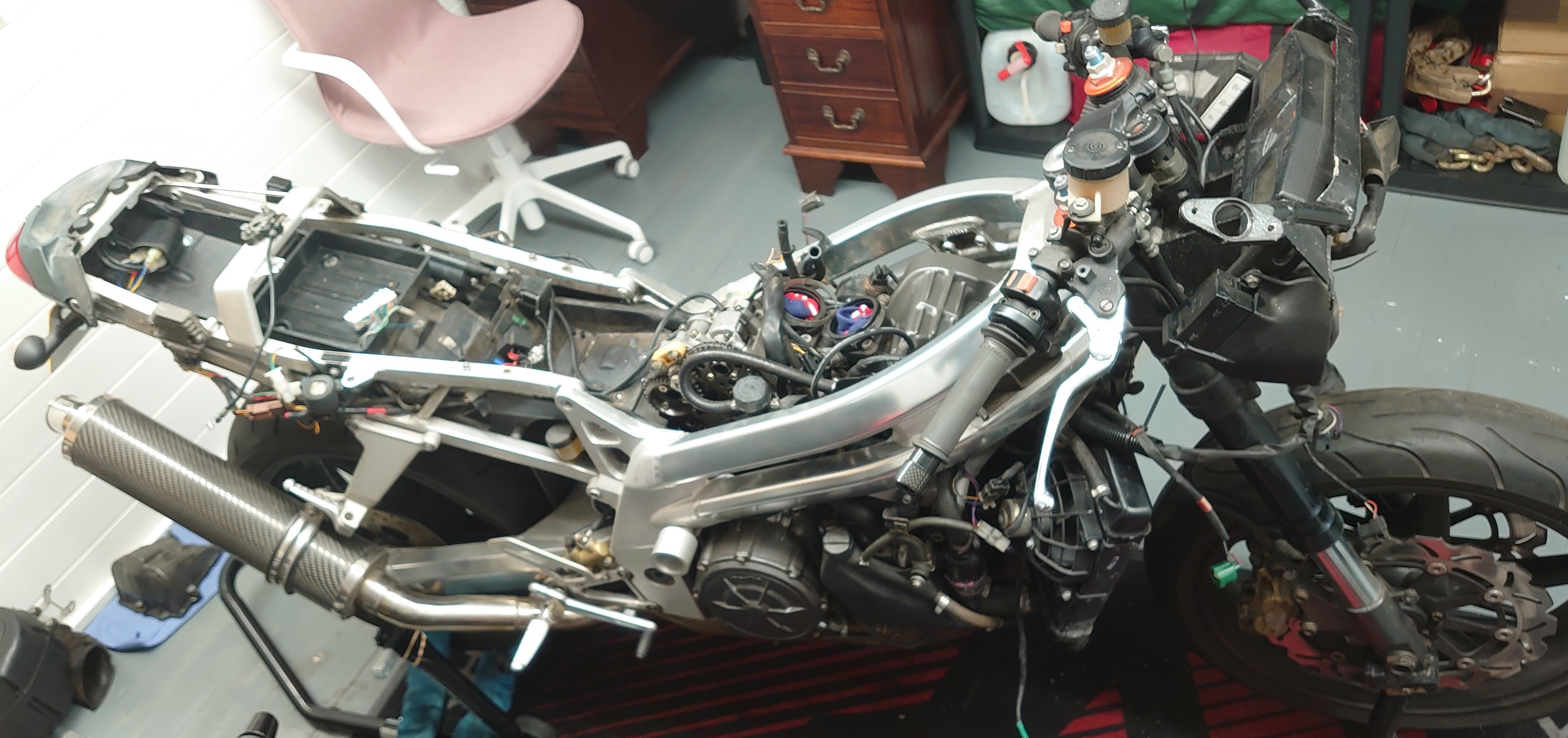

I've got the bike partly stripped down now. Valve clearances checked, I've got one slightly tight intake valve on the rear cylinder so need to swap out that shim. Compression checks look good, I think it was around 200psi front 190 psi rear.
Stripped down
With the bike sat in the garage I was getting bit of a petrol smell. So I want to replace all the hoses to prevent any potential leaks (high pressure hose was replaced by the dealer, need to check it's up to spec). I've also stripped the tank down to replace all the rubber gaskets. While I'm in there I'll fit a new fuel filter and internal hoses. The current fuel filter is Ducati branded but the hoses all have clic clamps - could that be original or has it definitely been changed at some point? The Nissan filter I've bought is a bit bigger than what's on it now, so I need to make sure it fits.
Other bits and bobs on the list - I've got a fireblade stand to fit, I've got AP's cable kit and I've got cable to do the mod on the charging circuit. Already got a lipo battery I'll use. Should hopefully make it nice and reliable. No signs of issues as it is, like burnt plugs etc. But will be nice knowing it's bomb proof.
Fluids will all need refreshing, maybe brake hoses all round. Oil and filter obviously, and already got a new air filter - old one is a bit grubby. There's a bit of oil in the airbox which may be normal amount, but the spark plugs are too black / sooted up. Could be the grubby air filter or too much oil getting in the box. Hopefully the new air filter and oil change (to the correct level) will fix that. I'll stick new plugs in anyway, and maybe injectors while I'm there, depending on cost.

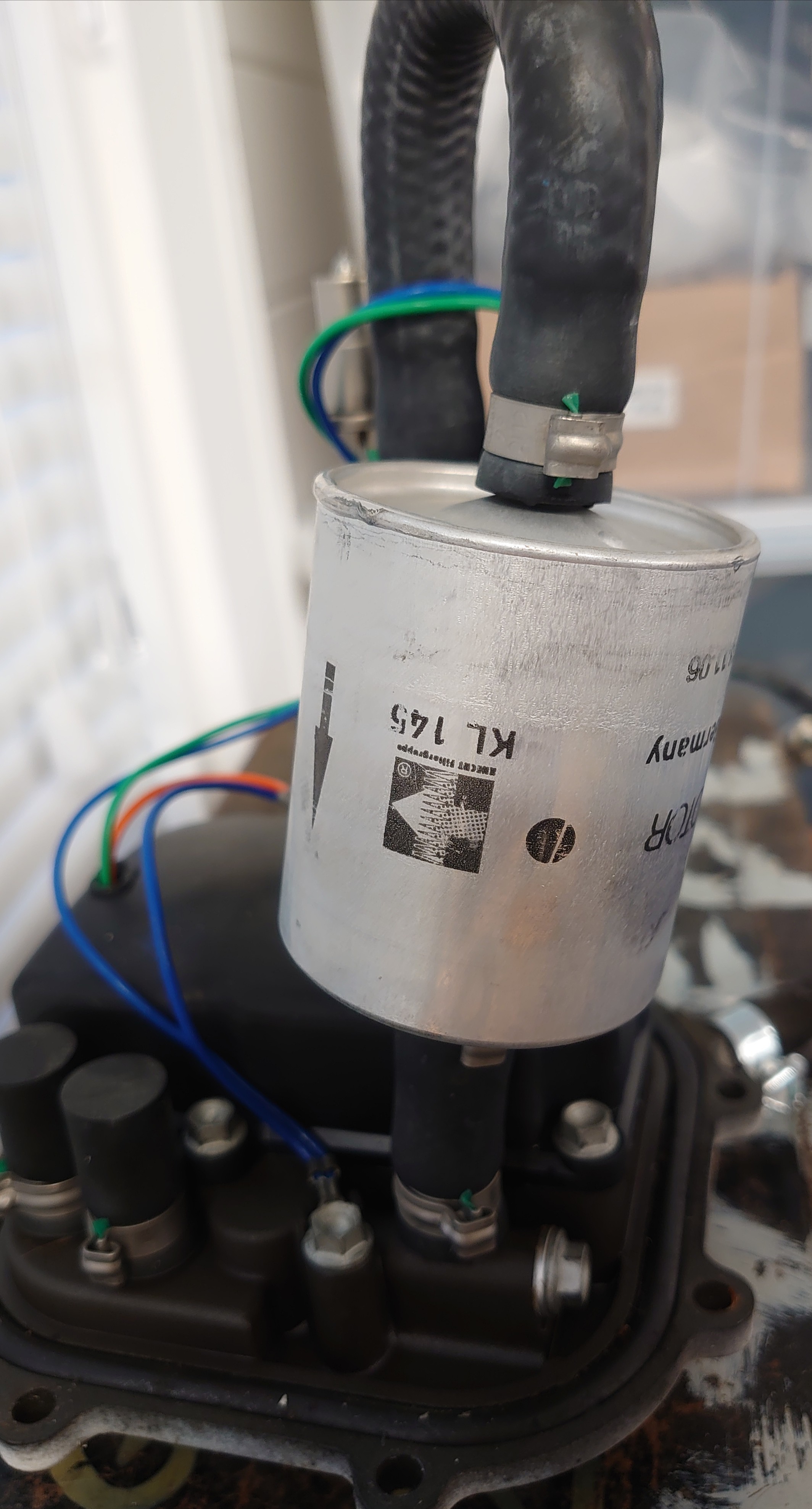

Just make sure it's in the right way round, as not all have flow direction marked (and yes - it does make a difference as I found!)mangocrazy wrote: ↑Thu Oct 20, 2022 10:41 amI wouldn't worry about what the fuel filter brand is, as long as it's the correct size and specification part. Good luck!
Re: First Falco
The fuel line guide is very useful, I've already obtained the right hoses and quick release connector thanks to the info in that guide. That's the magic of forums like this, getting so much handy information from decent people.
The clic clamps in the tank are metal. I wasn't sure many workshops would stock them which is why I suspect it's all original, but I could be wrong.
Here's the fuel filter, it's marked "KL 145" which may be a useful reference (can see one on eBay for £13). It's also marked "13.11.06" so if that's a manufacture date it's obviously not the original filter as my bike is a 2001.
I've bought some mini fuel hose clamps rather than the oetiker clamps - I'll see how they go. The quality seems good at least.

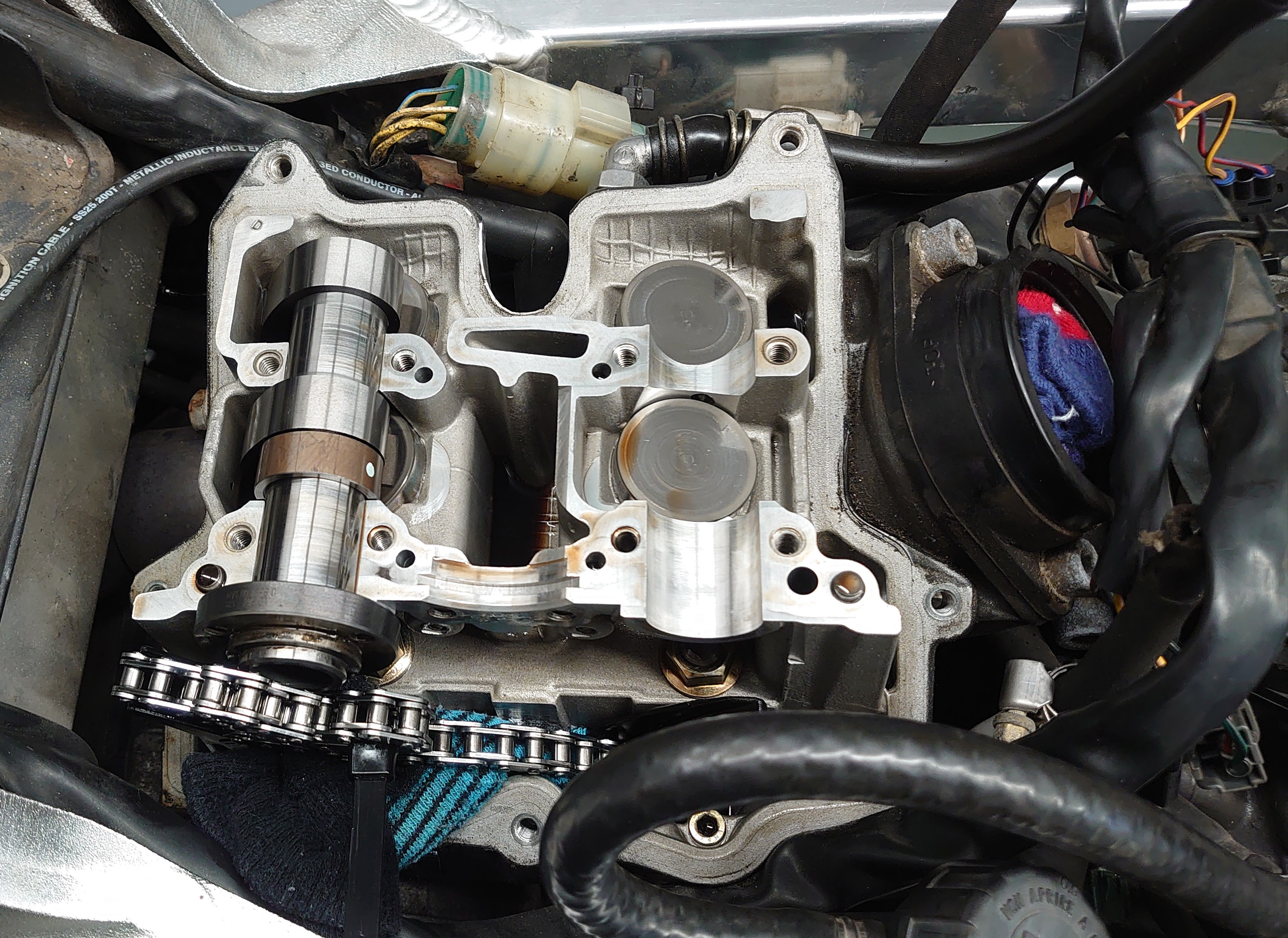

Found time yesterday to get the camshaft off and retrieve the relevant shim. On the rear cylinder you do need to remove the balance shaft to get the camshaft holder off - Ken's guide deals with the front cylinder so doesn't go over this in detail.
I did not need to remove the chain tensioner, I found there was enough slack as it is. Initially I worried this might be an issue, as the tensioner can be pushed in rather than being locked out with a ratchet-type system. But I believe it's hydraulic tensioner not just a spring, so I'm assuming it's fine. Will double check.
I also found a bit of coolant weeping on top of the thermostat so I'll get that fixed.
Now I need to order the new shim, as well as all the gaskets for the fuel tank and some other bits and pieces - I need to replace the preformed tank breather hoses so I need to find a solution for that. Might have to just use elbows.

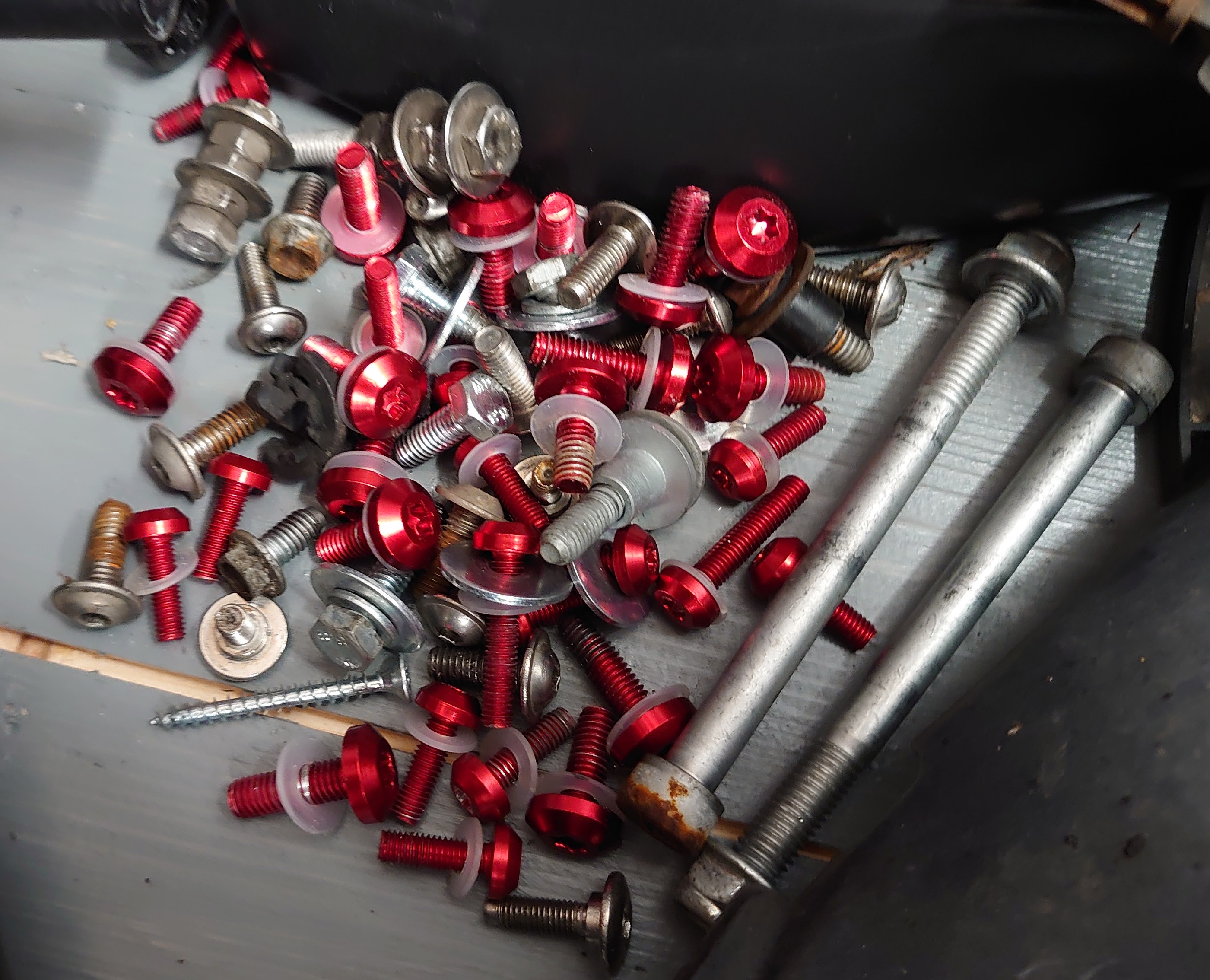

Well I've hardly touched the bike since my last post - did I mention this will be a slow project?! If I can get it rideable for spring I'll be happy.
I've got hold of a few different valve shims so next step is to get the best fitting one in and put the head back together. I think I'll use some sealant on the valve cover gasket, it's a bit oily on the outside so may have had a slight leak.
I still need to find some hose for the tank breathers. It seems Codan is the only option for quality fuel hose, which isn't cheap. Everything else is sh*tty Chinese crap. It's only for breather hose, but maybe I'll just bite the bullet and get Codan.
Pile of sin:
