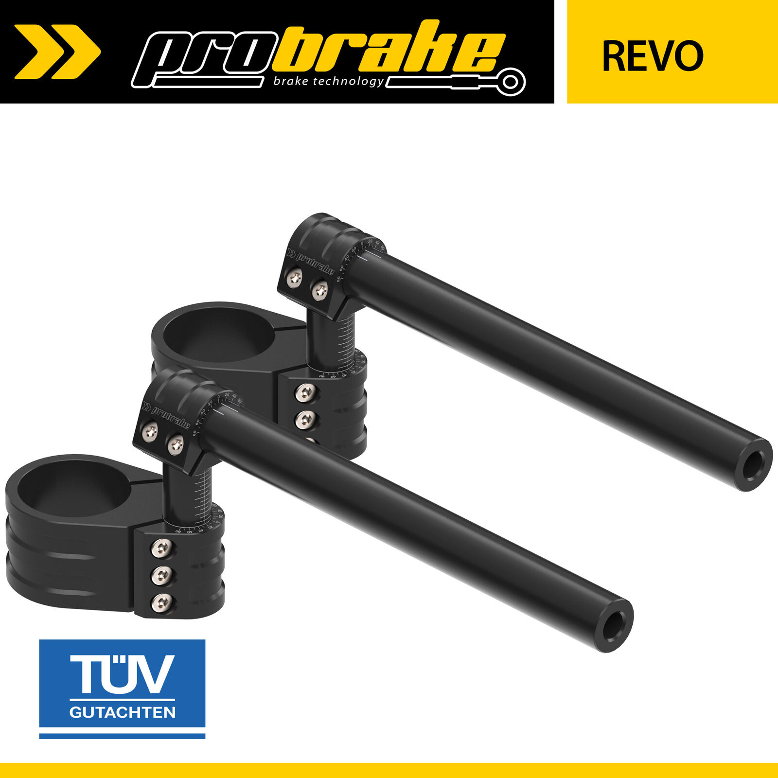

I was on the verge of buying some height adjustable handlebars when I decided to stop and try again with lowering the gear footrest (as I have a problem with that hip)...
Here are the German made bars I took a fancy to, this is medium height, there are higher and lower:
https://www.ebay.co.uk/itm/403617339421
adjustable bars.jpg (146.86 KiB) Viewed 8133 times

Looks like you are missing a bolt on the 'cheese hole' plate.
I still have the stock Falco rear sets, but I changed out my shifter for a RSV/Tuono one that doesn't have a linkage. It gives me a reverse shift pattern, but I prefer it that way. Another benefit tho, is no issues with gear shift linkage if you adjust the rear sets.
As for the bars, I have a set of Convertibars.
https://www.convertibars.com/
It looks like it gives all the adjustability of the set you linked, worth checking out.
You will run out of room at full lock with either the tank or fairing long before you run out of adjustment. I have mine adjusted as far back & up I could get without cutting any plastics.

#3 Post by mangocrazy » Wed May 25, 2022 12:30 pm
I did think about convertibars, but they only give you vertical adjustment. I wanted the bars higher AND further back, so came up with the (admittedly not particularly aesthetically pleasing) solution I've detailed in a different thread.
