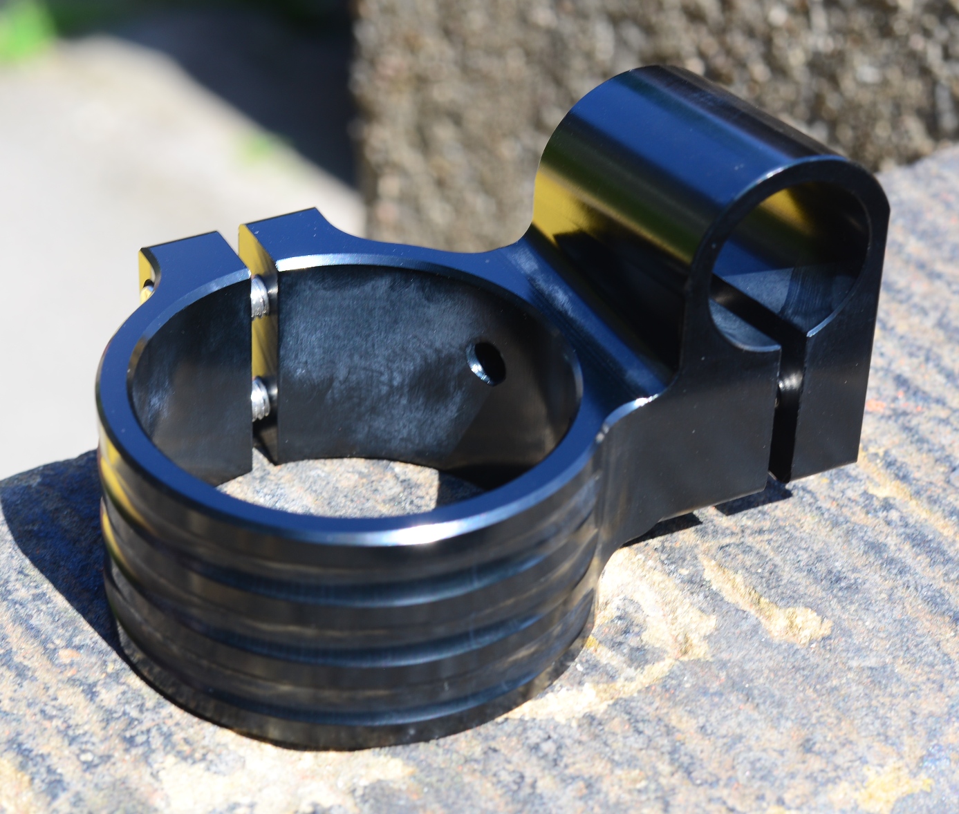

That was over 10 years ago, and I haven't been getting any younger in the intervening years and a recent ride out with my wife on the back highlighted the need for the bars to be moved substantially further up and back. When I was browsing Ali Express the other week I noticed a set of bar clamps that moved the clamp position up by 30mm. This bit of extra elevation would help, so I bought a set. I'll try and dig out the link, but here are some pics of the parts (one side shown only).
To make this work I'll need to get another set of bars made up that have a much greater offset from mounts to bars and I also intend to make the section that gets clamped longer than the current ones, so I have the option to move the bars inboard to clear the fairing if needed (which I'm sure it will be). This is a TurboCad representation of what the bars should look like.
So that's the outline plan. I'm hopeful it will work, as it's basically a refinement of what I've already done, but the proof will be in the doing. I know I'm going to need longer throttle cables and brake and clutch lines; I'm just hopeful there is enough slack in the switchgear cabling to allow it to work. I don't plan on doing this while the weather is right for riding, so for now I'll just concentrate on getting all the bits sourced and fabricated.
