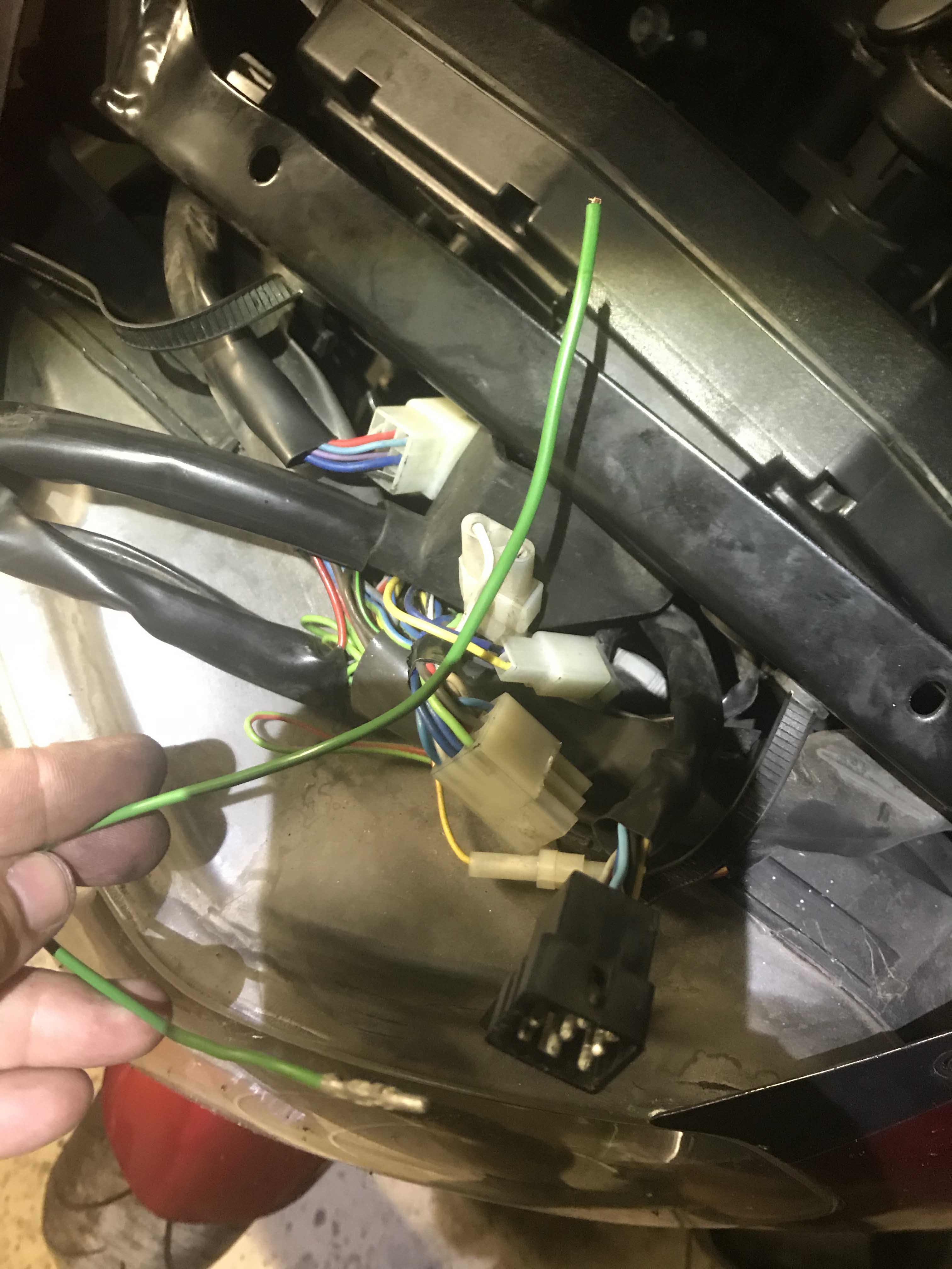

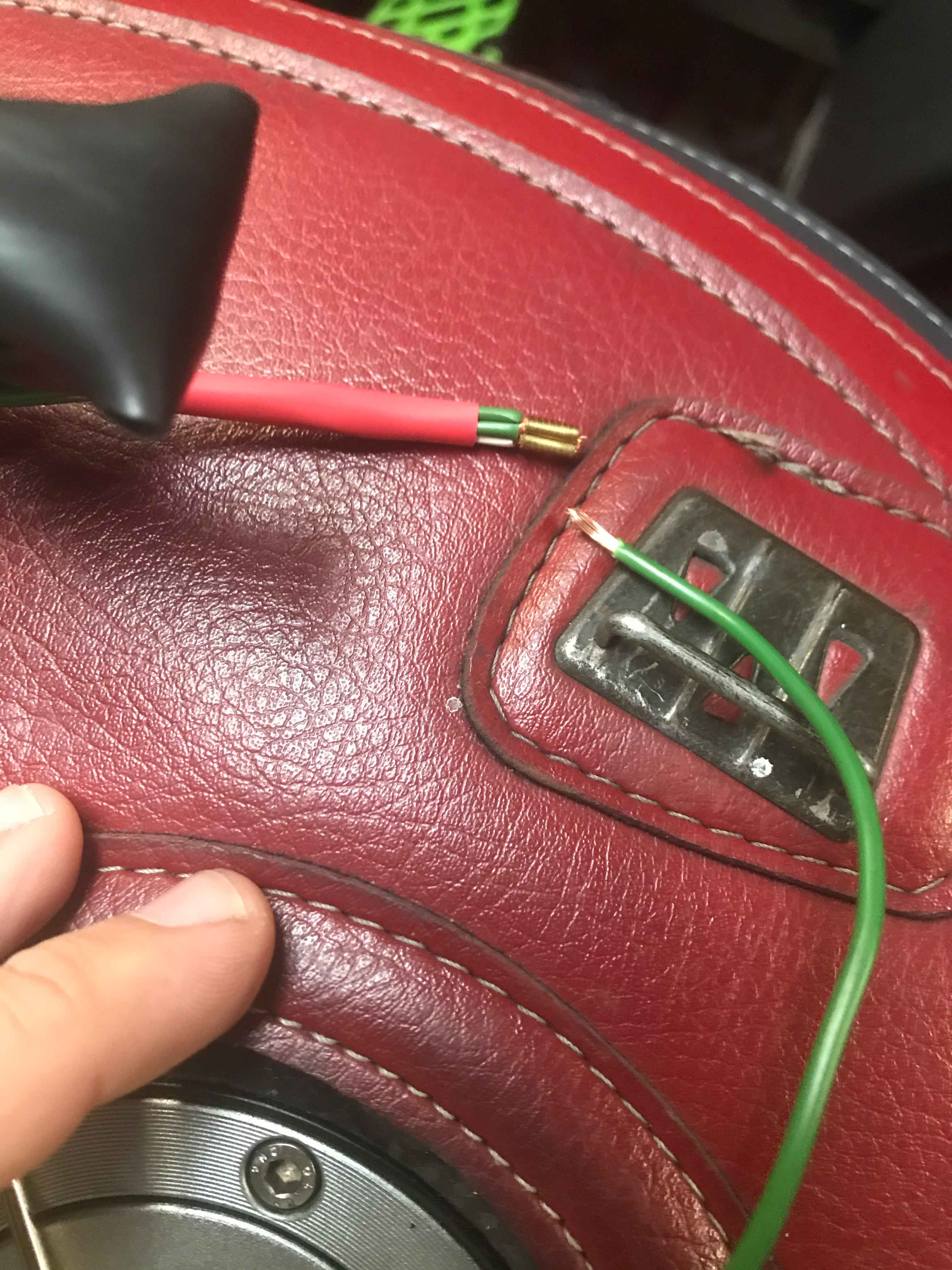

First problem figured (if not quite fixed):
Second problem - so, based on the above it doesn't look like this could cause a short. The optimate has been on overnight with the battery disconnected from the loom, and now getting the "healthy" light. Will reconnect to the loom and see if I get the "weak" light, if so then I'll be searching for the next gremlin...
It was the green wire! Have pulled the switch apart and traced the cable to the connector plug, and found bad continuity. Pulled on the wire and it came straight out the wire bundle sheath! There is a joining crimp with 4 wires going through it, and it has snapped at that crimp. Will either replace the crimp or just solder them all together, given they are all part of the switchgear assembly they don't really need to be able to come apart again.Second problem - so, based on the above it doesn't look like this could cause a short. The optimate has been on overnight with the battery disconnected from the loom, and now getting the "healthy" light. Will reconnect to the loom and see if I get the "weak" light, if so then I'll be searching for the next gremlin...
