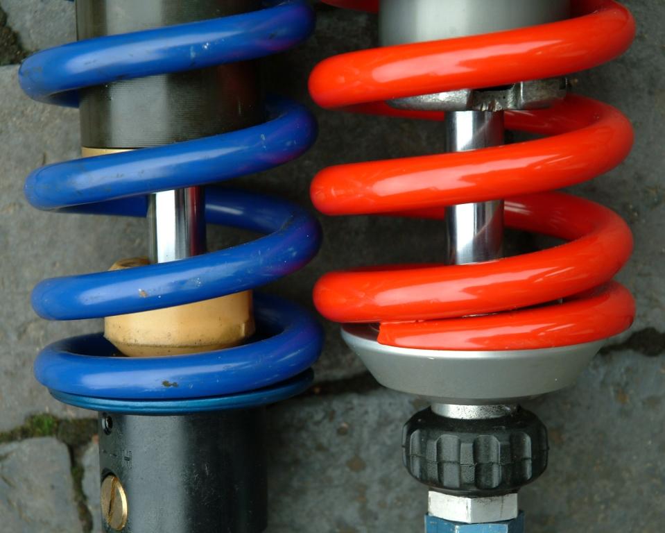

Today I spent most of the morning and early afternoon swapping over the Sachs shock for my modified Ohlins (except for an hour at lunchtime watching Rossi post his 100th win... :smt002 )
Here are some comparison pics of the two. First of all a general comparison:
And then a closer view comparing the suspension travel available on both. You'll notice the Ohlins has nearly twice as much:
There are a couple of points that I'd make here - I measured the between centres lengths of both shocks, and with the amount of ride height I'd got dialled in on the Ohlins (about 4mm of the 6mm available) the Ohlins was 9mm longer (326mm vs. 317mm). I also measured ride height with the Sachs and Ohlins fully extended from a point on the bodywork to the top of a steel rod poking out of the hollow rear axle. On the Sachs it was 463mm, on the Ohlins it was 498mm. That's 35mm difference!
So basically on the Falco linkage, 9mm of ride height on the shock equates to 35mm of ride height on the bike - that's a ratio of nearly 4:1...! Bear in mind that all measurements are approximate, but I took as much care as I could. I'd be very interested in knowing what the linkage ratio is for the RSV/RSV-R items. By the time I'd found out how much effective ride height I'd added, the bike was completely reassembled and I was running out of time. When I have time I'm going to back it off by about 10mm of bike ride height, as it's a trifle excessive as it is. It certainly leans quite a long way over when it's on the side stand...
I also got a bit carried away adding rebound to compensate for the heavier rate spring. I put about 10 clicks on, which was definitely too much, as when I took it for a test ride I could feel the bike 'packing down' over successive bumps. Basically the rebound damping wasn't allowing the suspension to return to full extension before hitting the next bump and getting a kind of ratcheting down effect. I'll return it to how it was and add rebound a click or two at a time, I think. The only problem is that to get to the rebound adjuster you have to get up close and personal with the exhaust, so it's an adjustment only to be performed when the exhaust is cool.
But even with those caveats, the bike still felt pretty much as good as when I had the stock Ohlins and RSV linkages. I think once the rebound damping and ride height is optimised, then it'll be a winner. I deliberately took it out over some roads which were 'C' roads - not quite cart tracks, but definitely a long way from smooth. I only did about a 20 mile circuit, but didn't get kicked out of the saddle, which was definitely happening on the unmodified Ohlins.
So all in all I'm well pleased. If anyone else is thinking of doing the same (i.e. using the Falco linkages and spring and the RSV Ohlins or Sachs), I'd suggest preloading the free length of the spring about 11 - 12mm as a starting point (I weigh about 11 stones), only adding about 2 mm of extra ride height on the shock to start with (the Ohlins is already longer than the Sachs) and adding rebound and compression damping as required.
This is still a work in progress, but I think it definitely has a lot of potential.
