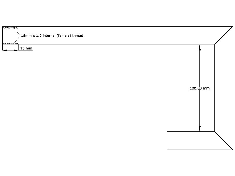

That really would be a shame. I'd persist with the Falco now you've got it how you want it (apart from bar position). I'm in very much the same position. The last ride I went on made me realise that the bar position is too low for comfort on my ageing bones, but the bike has had front forks and shock overhauled and is feeling better than ever.
I've already modified the bars by using a bar mounting clamp on top of the yoke (forks pushed through the top yoke by 6 rings to make space) and modified bars fitted), but I need to go further with that plan. I don't really want a top yoke conversion if I can avoid it. So I've bought a pair of these only to discover I already had a pair:
https://www.aliexpress.com/item/32970646020.html
These give a 30mm rise and if I use them in conjunction with a set of bars shaped like those below that should move the bar position up and back enough to take a lot of weight off my wrists.
Actual dimensions may change, but that is the general idea of what I have planned. I already use bars of that type in conjunction with clamps that don't give the 30mm rise, but the offset is only about 45mm at most. Using clamps with a higher start position and significantly more offset on the bars should make it easier on my wrists. That's the plan, anyway.

I have no intention of cutting any of my fairing parts. I will be acquiring a top fairing that's suffered crash damage and which needs repairing, and if any cutting is required, that will be the parts that suffers. However I intend to avoid that if at all possible. I'll also get the new bars fabricated with a longer 'short' arm if you see what I mean , so I have the option of moving the whole bar assembly inboard to some degree if needed.
This would also reduce overall bar width and make it easier to get down the passageway in the row of terraced houses that we live in. Can take photos if the idea might be of use...?
